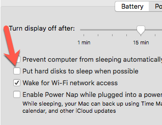

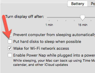

The energy pref pane won't do it?
No, that option will cause the drive to spin down eventually after it spins up (after several minutes) but doesn't prevent the drive from spinning up in the first place...
