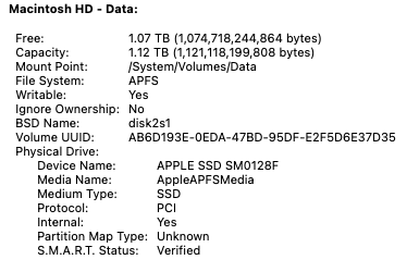

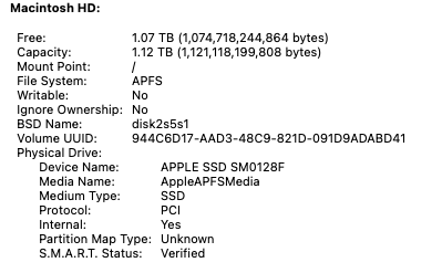

The attached are from the 'new' mini...

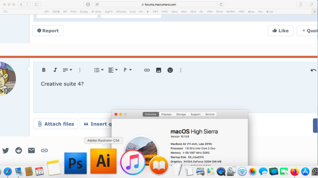

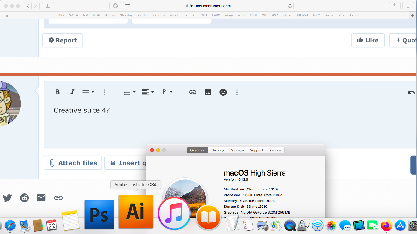

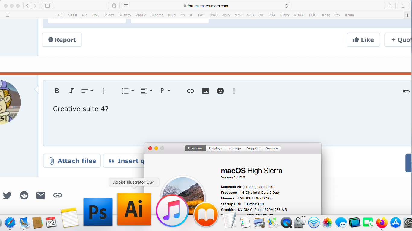

Creative suite 4?
i installed that on ElCap first and sierra and high sierra accepted the software
never installed CS4 on high sierra, but did with Mojave in 2018
Oh watch for the "need to update JAVA alert" for high sierra to run CS4
Creative suite 4?

this weekend i upgraded to High Sierra from Sierra and CS4 worked!
High sierra has safari 13.1.2 and better security than Sierra!
If you could upgrade, i would!
and CS3 is not working in any rebooted mac from Mavericks i found out the hard way
and a fresh reinstall of MtLion is a no go for CS3, but CS4 will install perfectly.

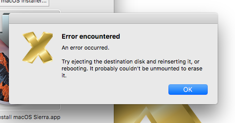

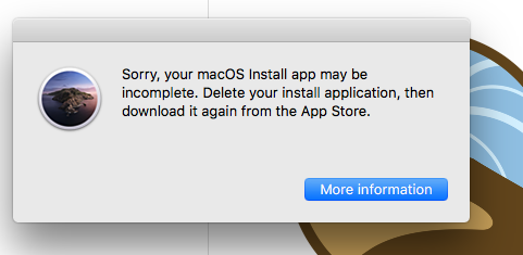

I downloaded both DiskMaker X and Install Disk Creator. I followed their instructions (I think). This were the results. I checked the USB using disk utility and it passed inspection. I downloaded Sierra from the apple site. Sierra is no longer available at the app store.
Looks to me like the version of Sierra you downloaded was corrupt or incomplete.

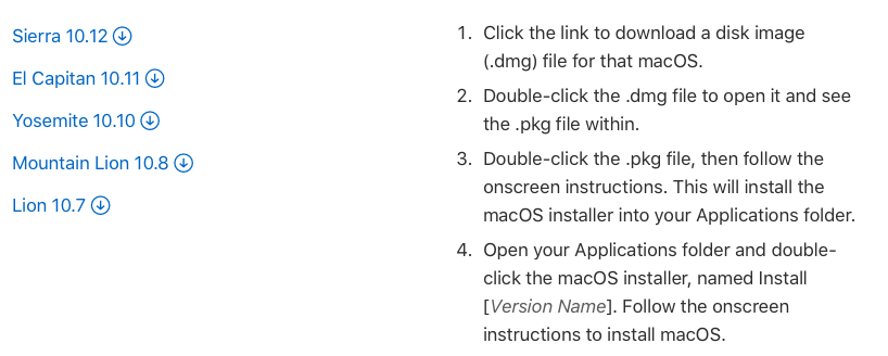

1. Download Sierra from here: https://support.apple.com/en-us/HT211683 and follow steps #1-3.
2. There is a “bug” in the Sierra Installer, so you need to follow the steps here from Eau Rouge: https://discussions.apple.com/thread/251380944 to create thr USB installer
If you need more info on thr createinstallmedia step, see here: https://support.apple.com/en-us/HT201372
3. When your ready to wipe the drive and reinstall, plug the bootable intaller into thr Mac, press and hold the option key, and then power on the Mac. Once the boot menu is shown you can release the option key. Select the usb drive to boot off of, load disk utility and erase the internal drive, then reinstall Sierra. Once complete perform the available updates and then reinstall your other apps and finally copy the data over.
