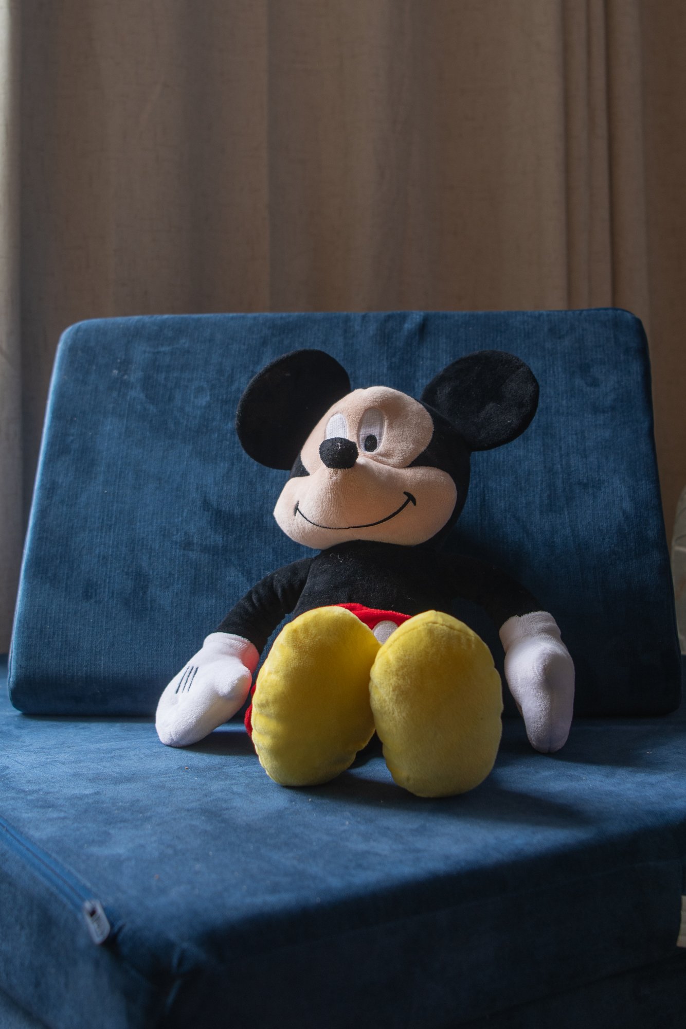

First of all, shot on a tripod, Nikon D850 w/24-70mm f/2.8E set to 50mm

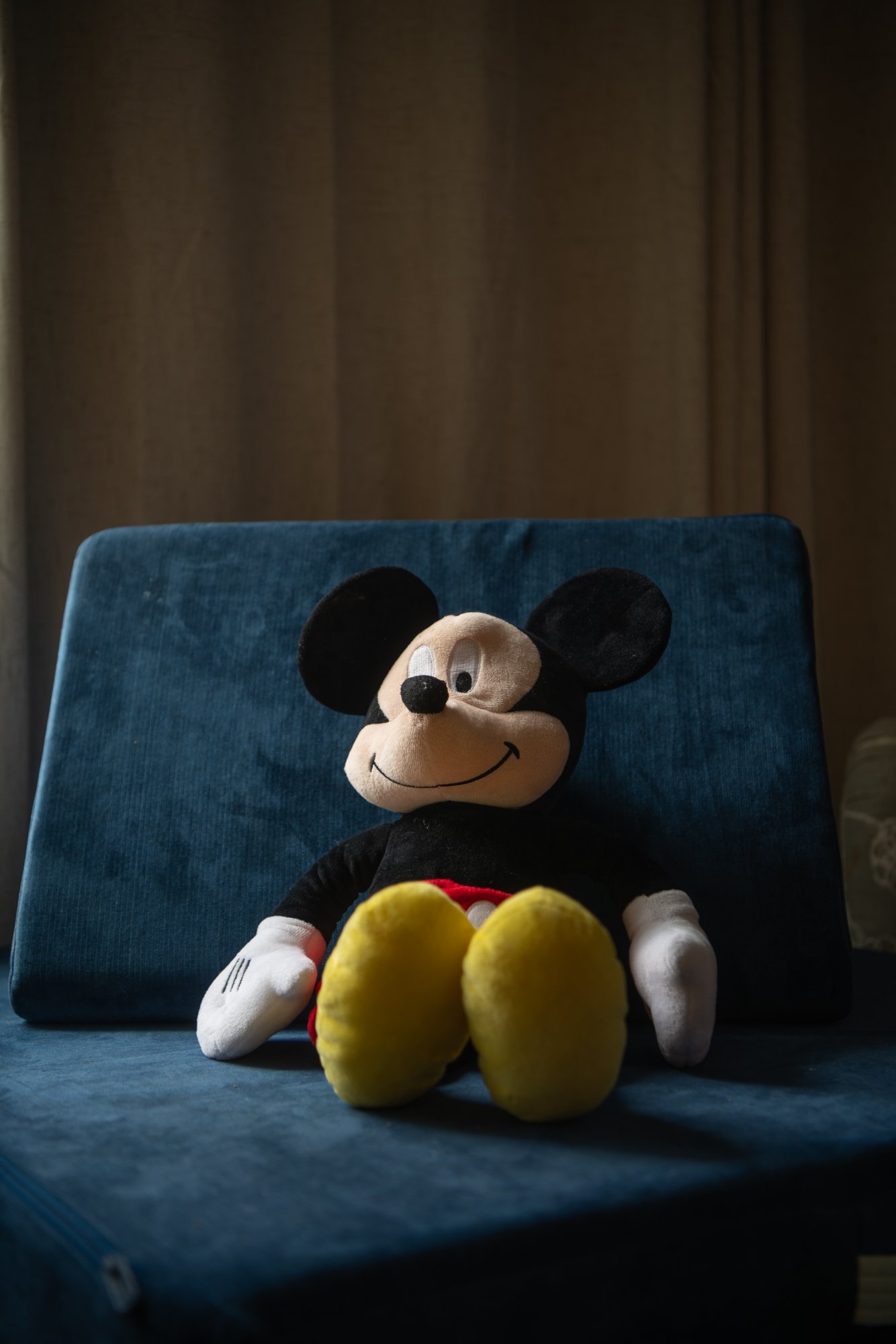

Now lens zoomed out to 24mm, and result cropped to the same(aproximate) FOV as the 50mm image. I doubt you'll see a difference at web resolution. The difference is there in the full res originals(which are too big to upload here) but I honestly don't see more detail.

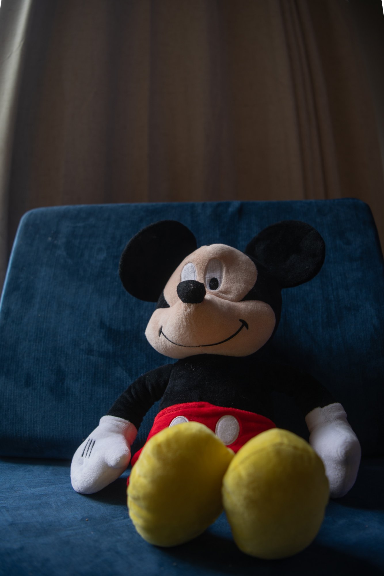

And finally, reframed so that the subject was about the same size in the frame(done by moving the tripod as much in a straight line forward as I could and not introducing side to side changes) with the lens zoomed to 24mm. I spent some time playing with it, but could not get the exaggerated perspective to go away(i.e. the size of the feet relative to the face) as well as the extra included background. I did not go into Photoshop to see if I could do it-from what I remember the perspective tools are somewhat more powerful there than in Lightroom so I'll try it time permitting, but it's different.
I still think that when dealing with plenty of spare resolution, framing as if a longer lens and cropping is probably still the best choice. As said, the D850 is 45mp, which is not significantly different from 48mp. Wide open, I don't think this lens takes full advantage of all the resolution the sensor offers.

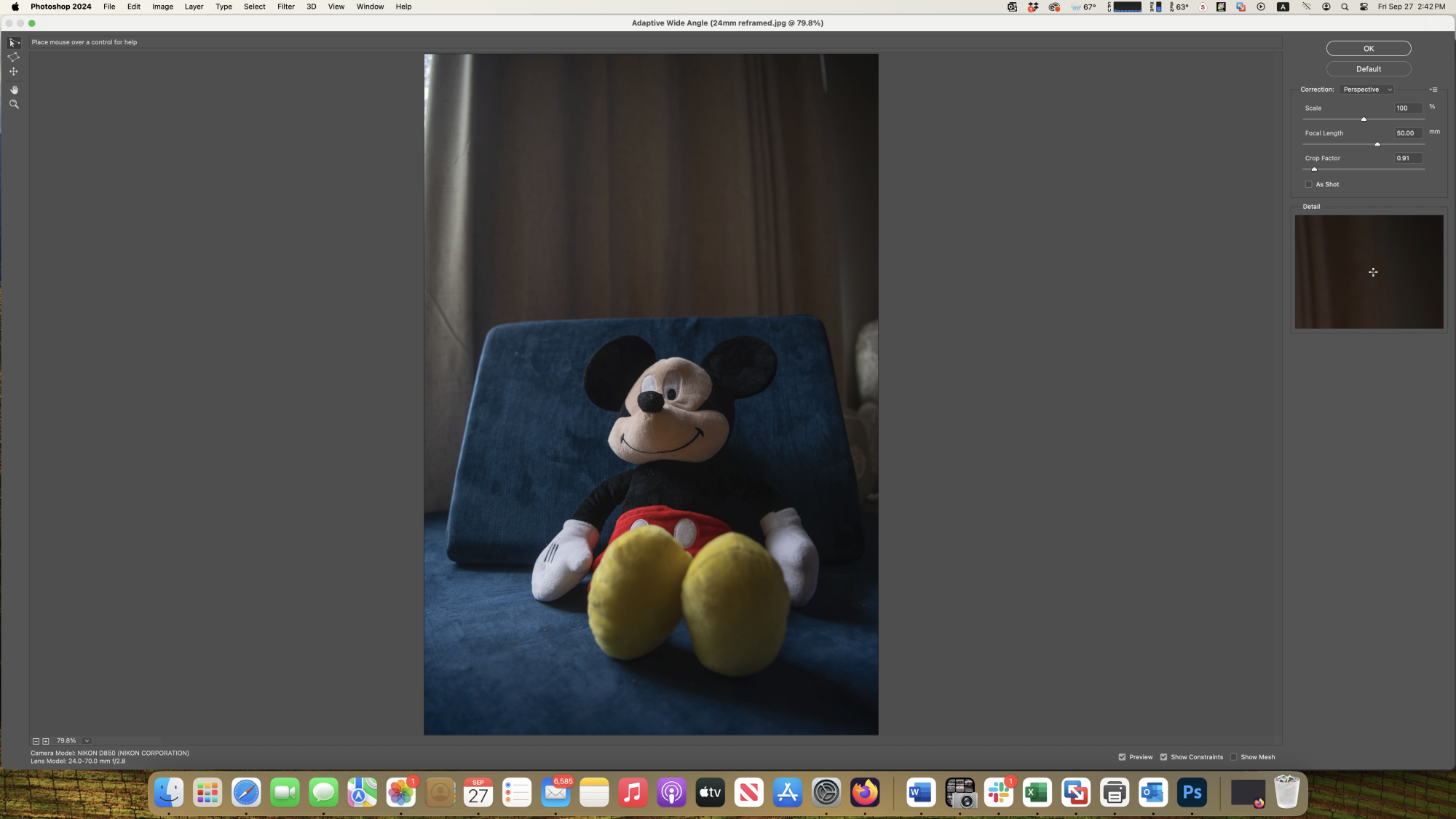

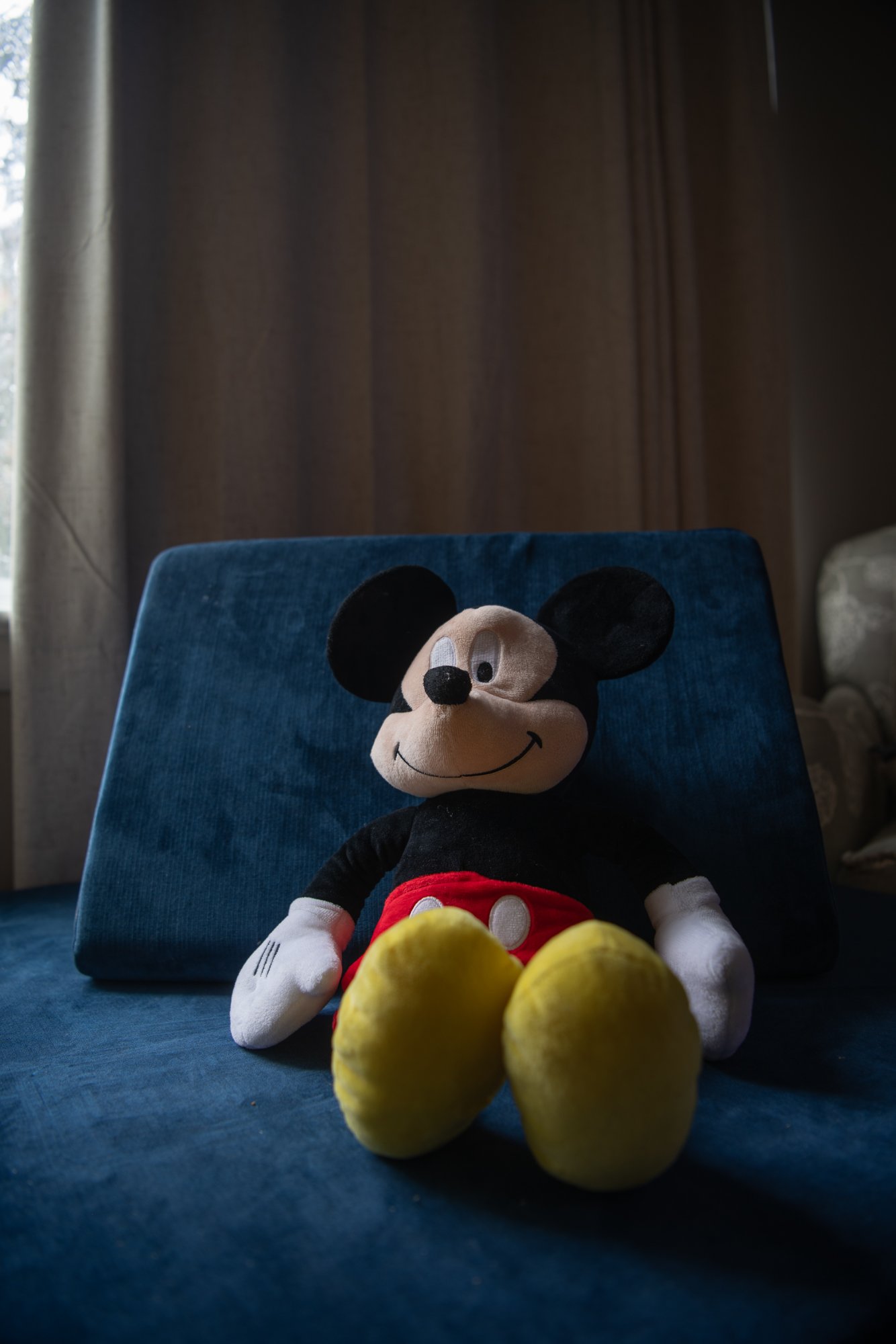

Well, maybe I spoke a bit too quickly...it seems as though Photoshop has a tool to do just this. It's not perfect, although it might be better if I spent some time really learning to use it, but it does accomplish something. The tool is called "adaptive wide angle"
