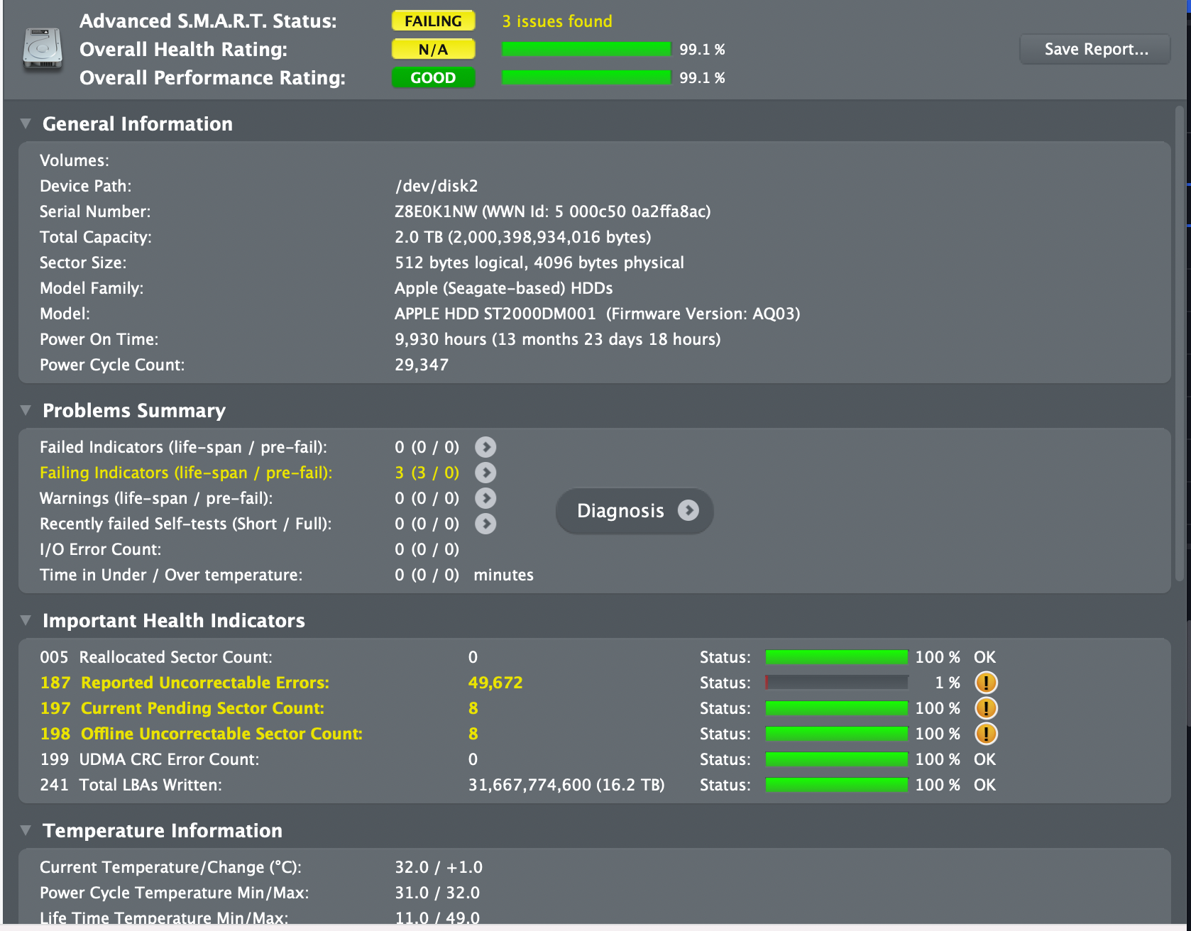

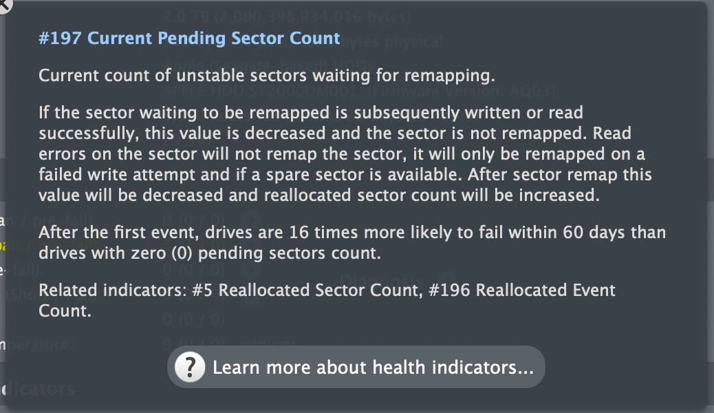

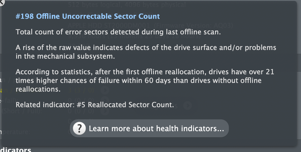

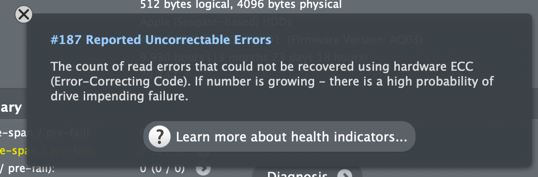

My mid 2017 iMac drive is failing. The computer reboots upon logging into the OS, sometimes when I get to the desktop, sometimes at the login screen. I pulled it out and hooked it up to my old Mac via an OWC external enclosure. Dusk utility sees it but I cannot access it. It shows disk is not mounted. I tried to mount it but I am unable to do it.
I scanned it with Drive Dx and here is what I got. Does anyone have any idea how to go about it without spending money on professional services?
Thank you in advance.

Without the SSD half of the Fusion Drive, you don’t have a working file system. Based on the DriveDx report, your HDD is toast. Even if you took the SSD and the HDD to a data recovery service, you are definitely going to lose some data.

Why is that?
From the image attached to the first post, it's clearly that at least 1 cluster on the HDD was scrapped.
This is most likely occurred because the reading/writing head failed.
Attemping to mount the disk and read/scan the disk just forces the reading/writing head to contact with the disk surface more and it might create more scratches on the disk surface => losing more data.
