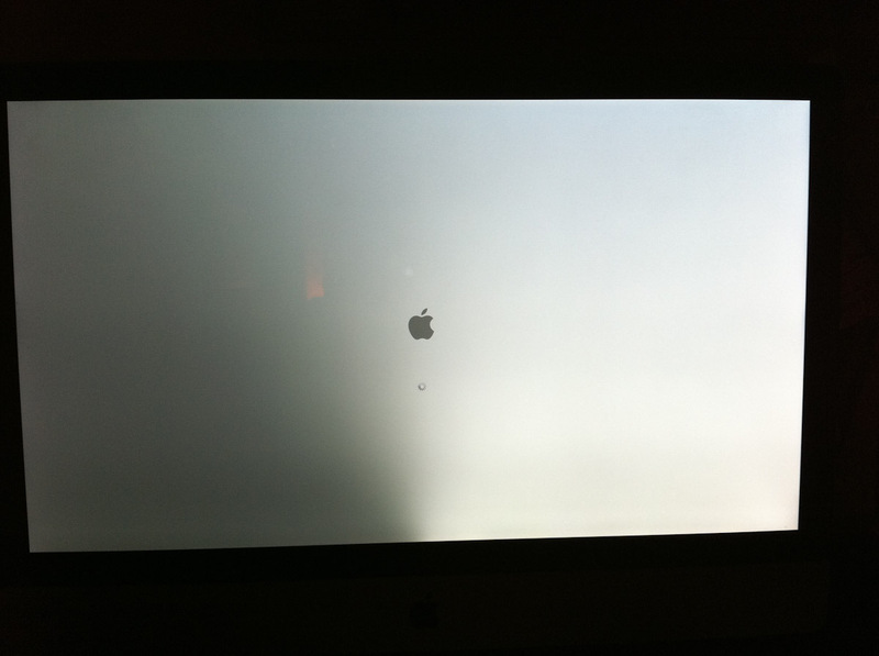

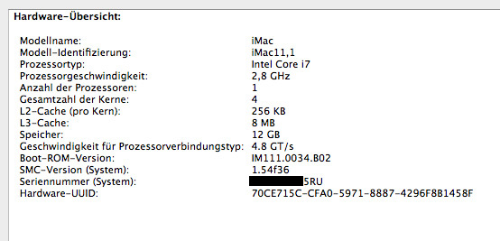

Hello,
since 3 days my display is in the left corner much dark than anywhere else and sometimes it's flickering. But only the backlight turns on and off. Graphiccard seems to be okay. I don't have any problems with the display.
I think my LED backlight or the backlight board is defective. Our local Apple Service Provider made a quotation: display-change 670€ -that's too much. Since 2,5 month I don't have any warranty and i ordered no apple care. I thought its a 2000€ computer and should work at least 3 years without any problems. Now I have a problem. 🙁
Is it possible to replace only the LED backlight?? What can i do to fix it?

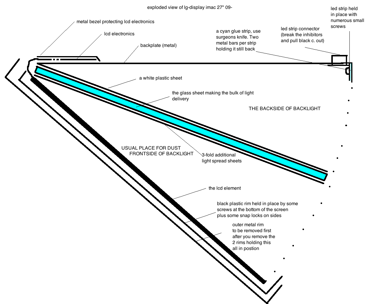

2)Disassemble the panel as described in many places, maybe best in the last link above, with quite detailed pictures (hopefully they are there still). In short: After removing the metal brackets that hold the screen in its place you have to rip of the metallic tapes going round the display and the metal lid of the control electronics on the top of the lcd.

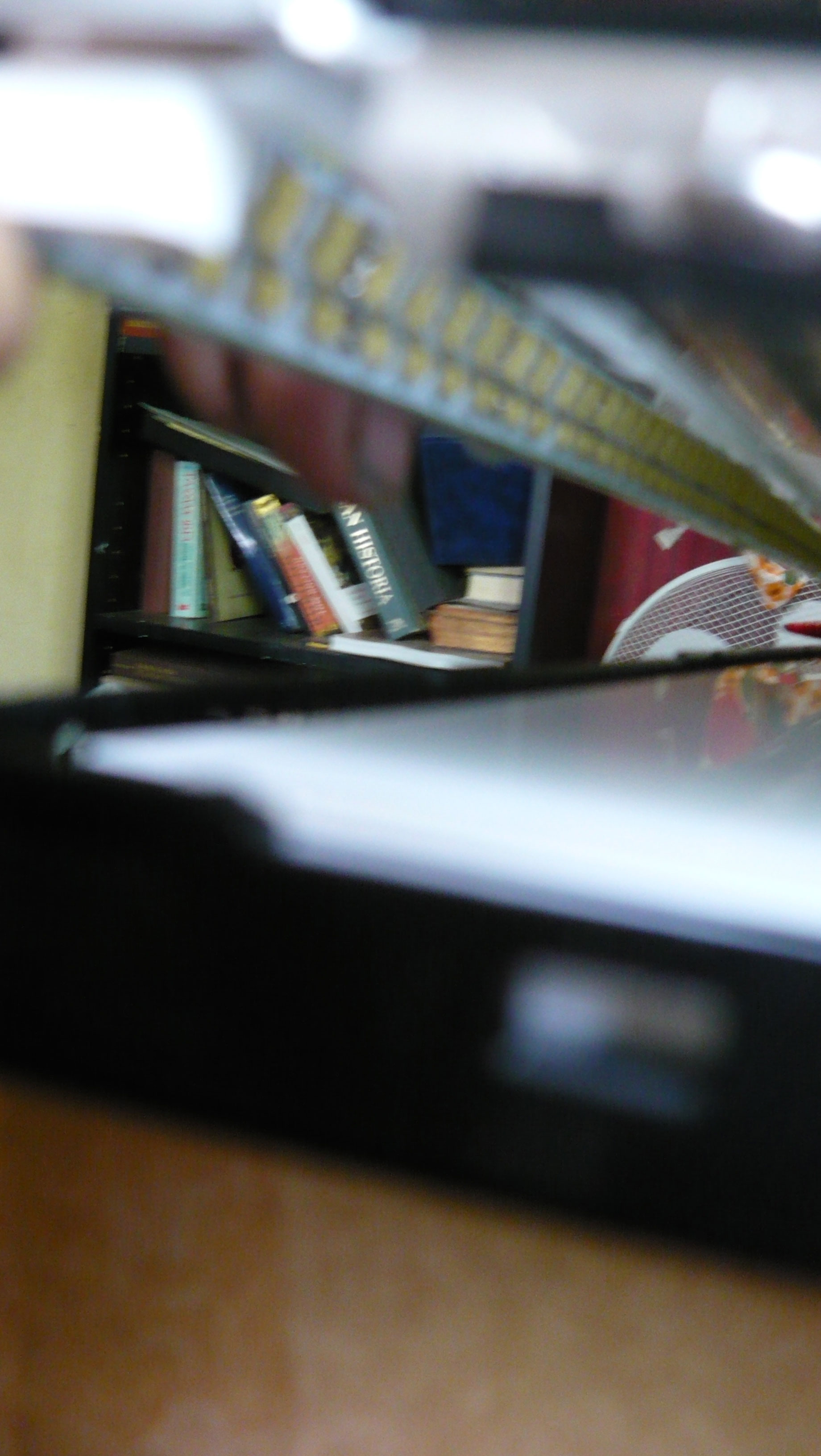

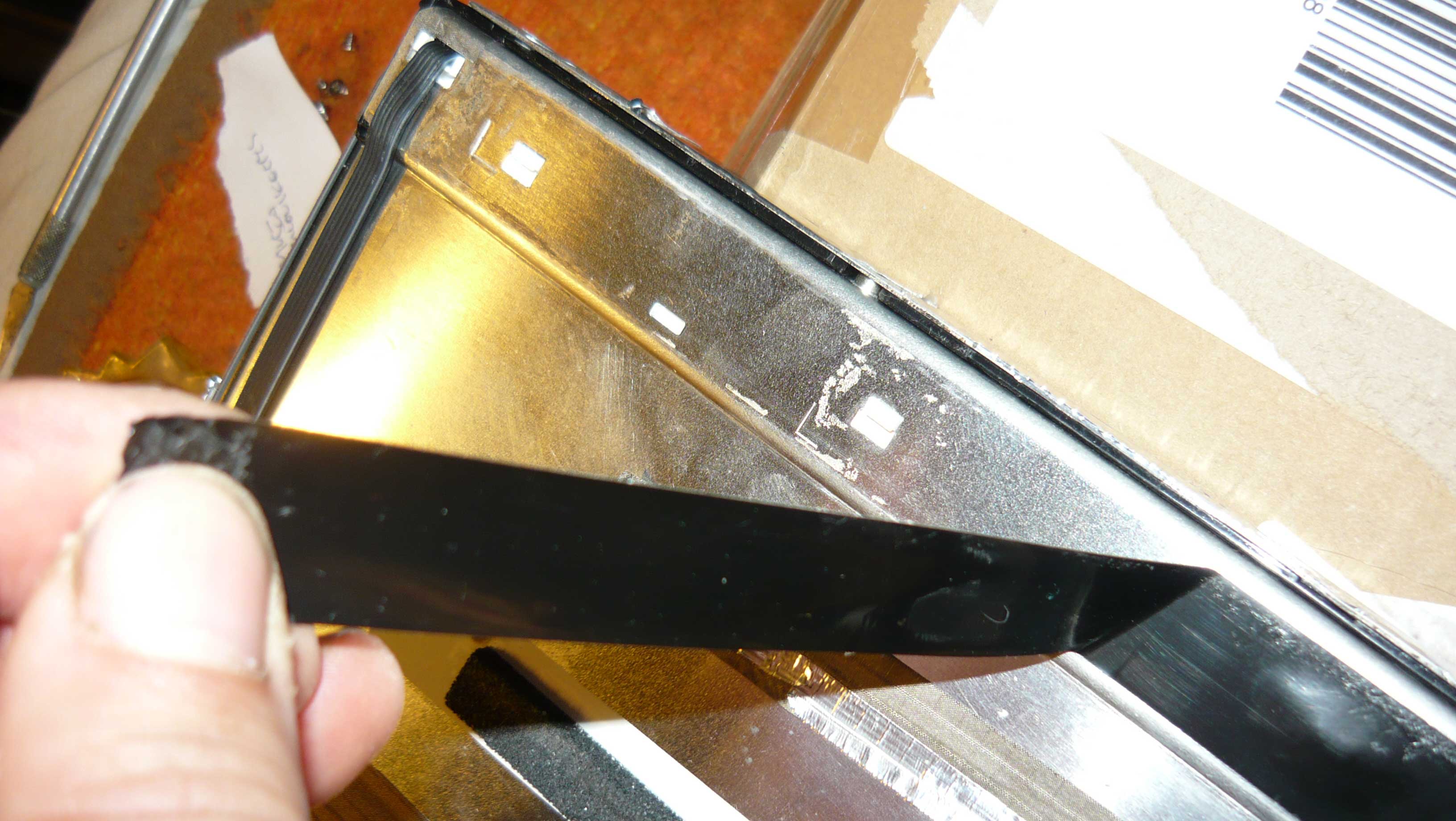

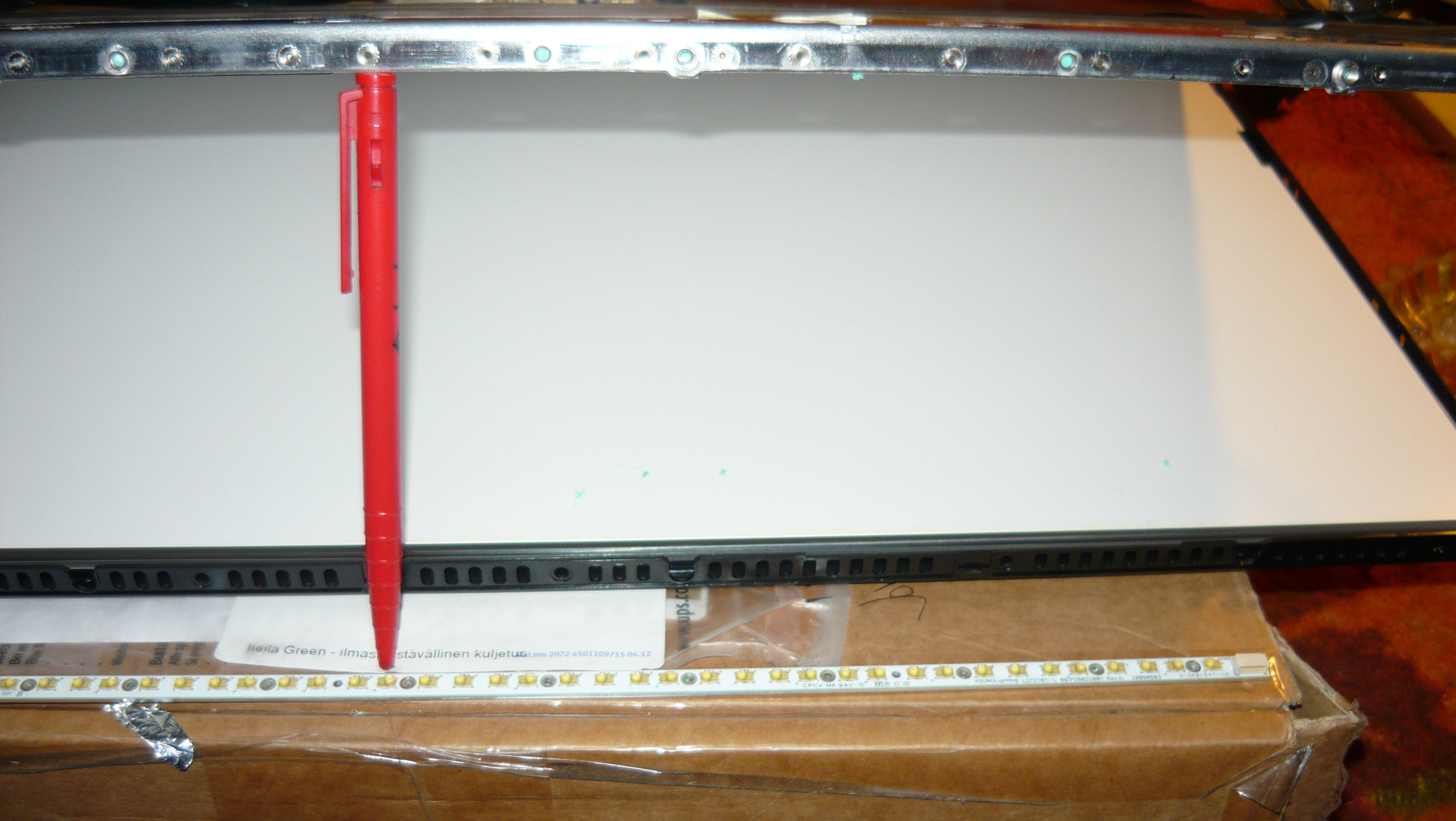

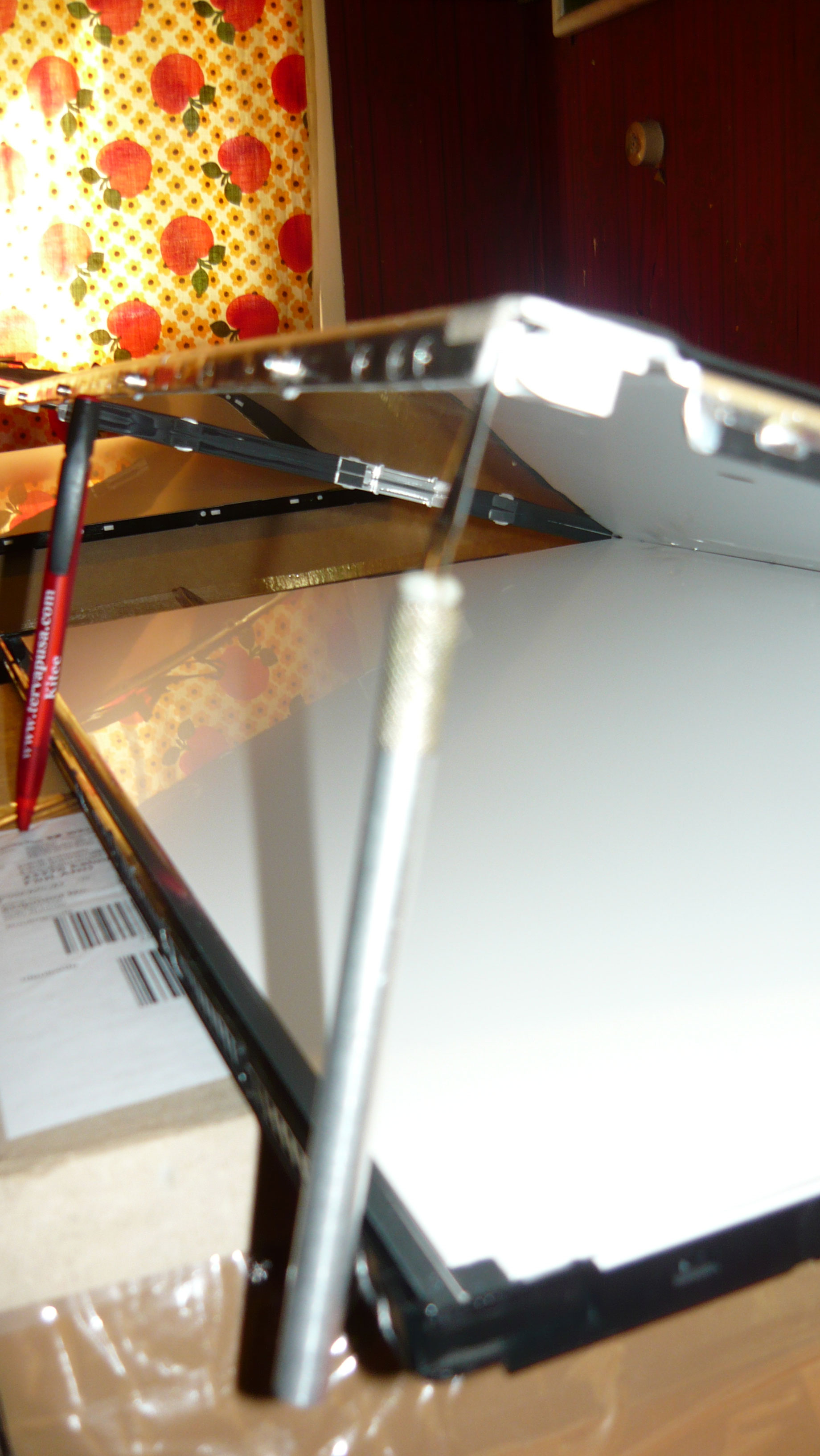

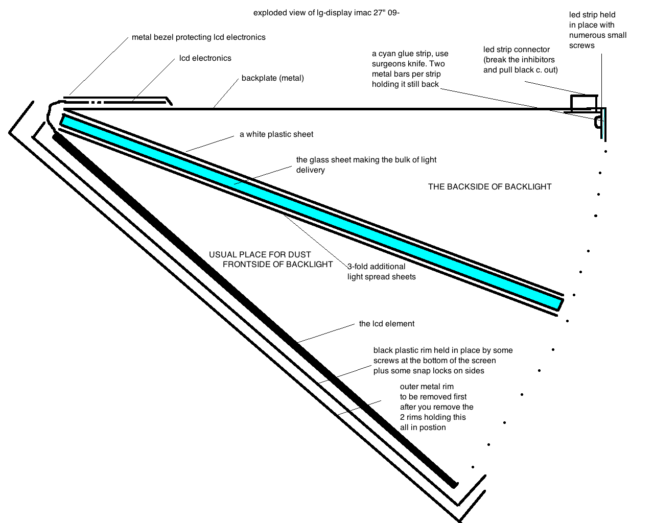

I drew an exploded view of the display, plus took some photos of the teardown of the bottommost parts of the display. Sorry to say, the led strip is the very last component of the screen, attached to its place by a legion of very small srews that you barely can access when the panel is held upside down and open (in my pictures by a pen).

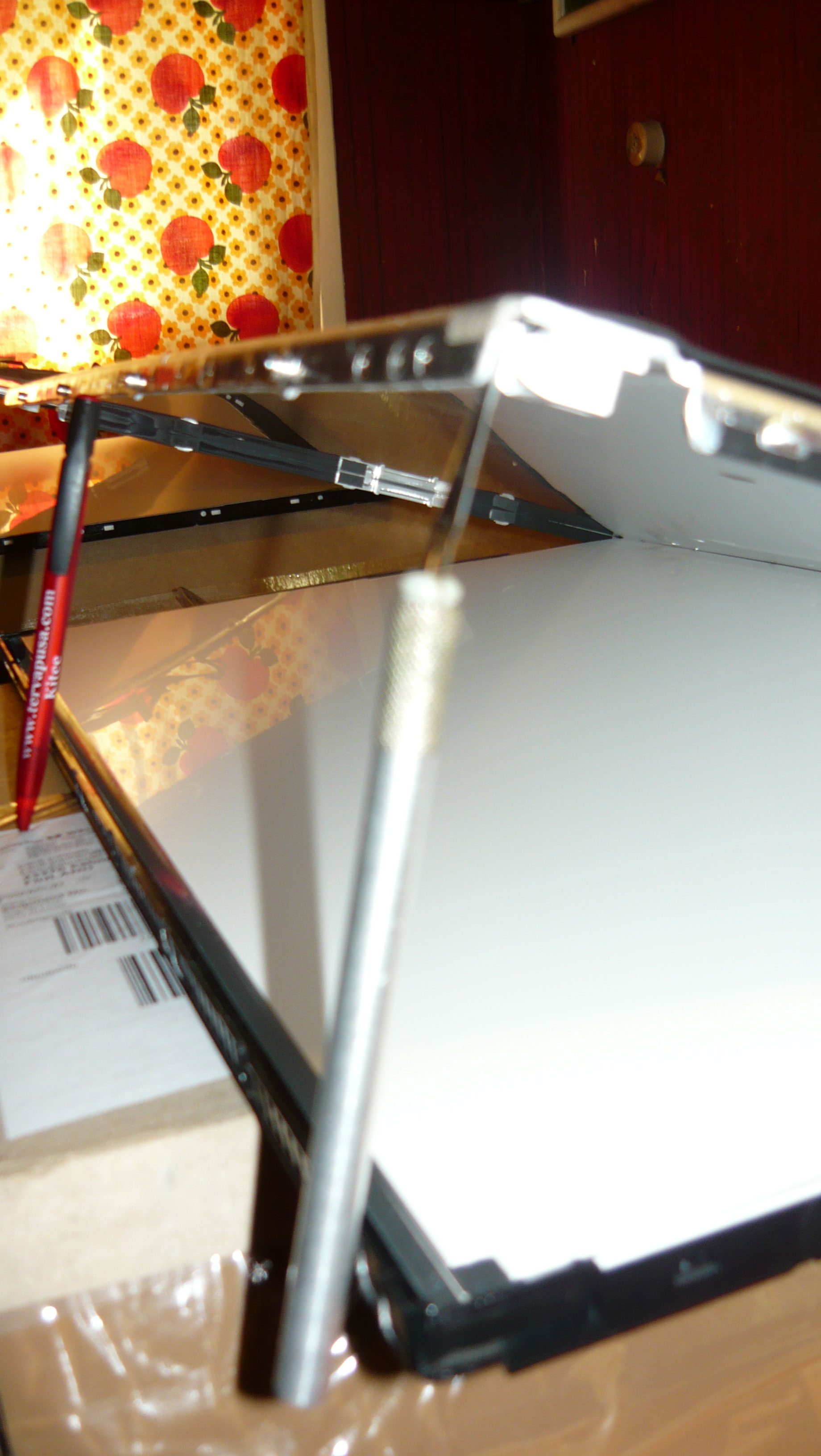

The principle is that you place the panel face down on table and once detaching the black plastic rim (screws/notches) lift the back plate up with a pen to get access to the leds. Be careful not to move the glass sheet and its white cover since they can be nasty to get in place.
pictures:
1) the exploded view

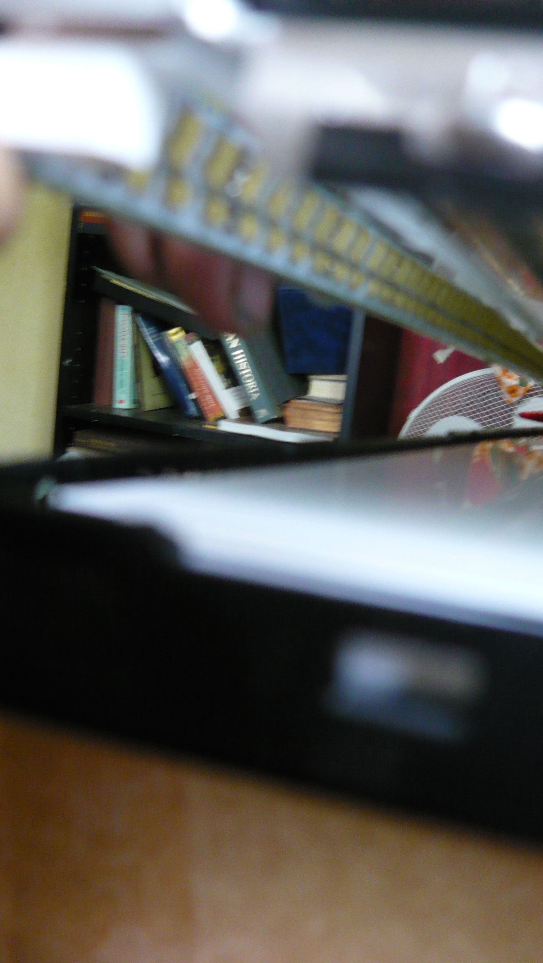

2) the led strip in its place (top), black metal rim (bottom). The srews are of course on the INSIDE of this construction.

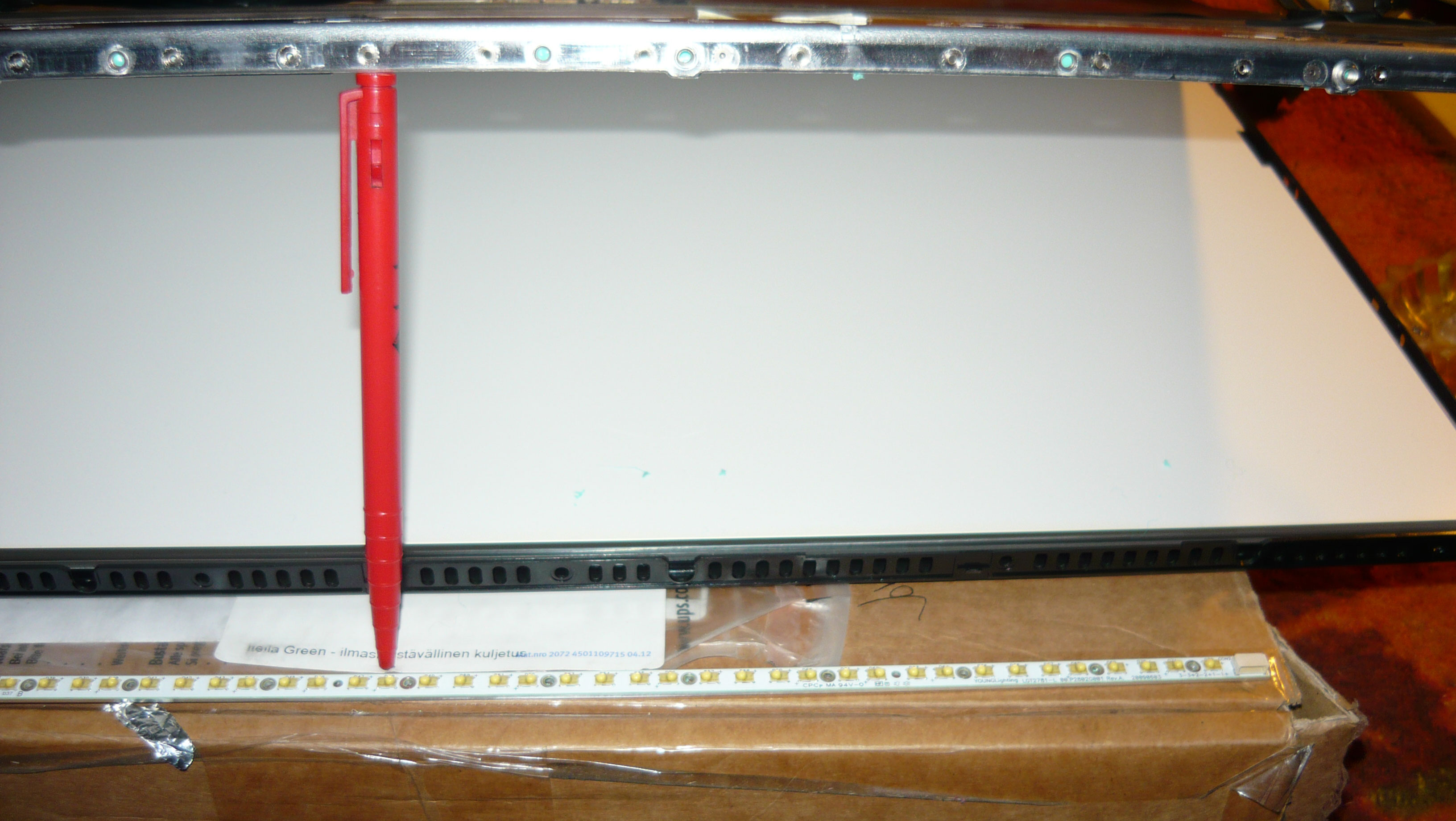

3) pen holding the panel's back plate up, removed led strip on front.

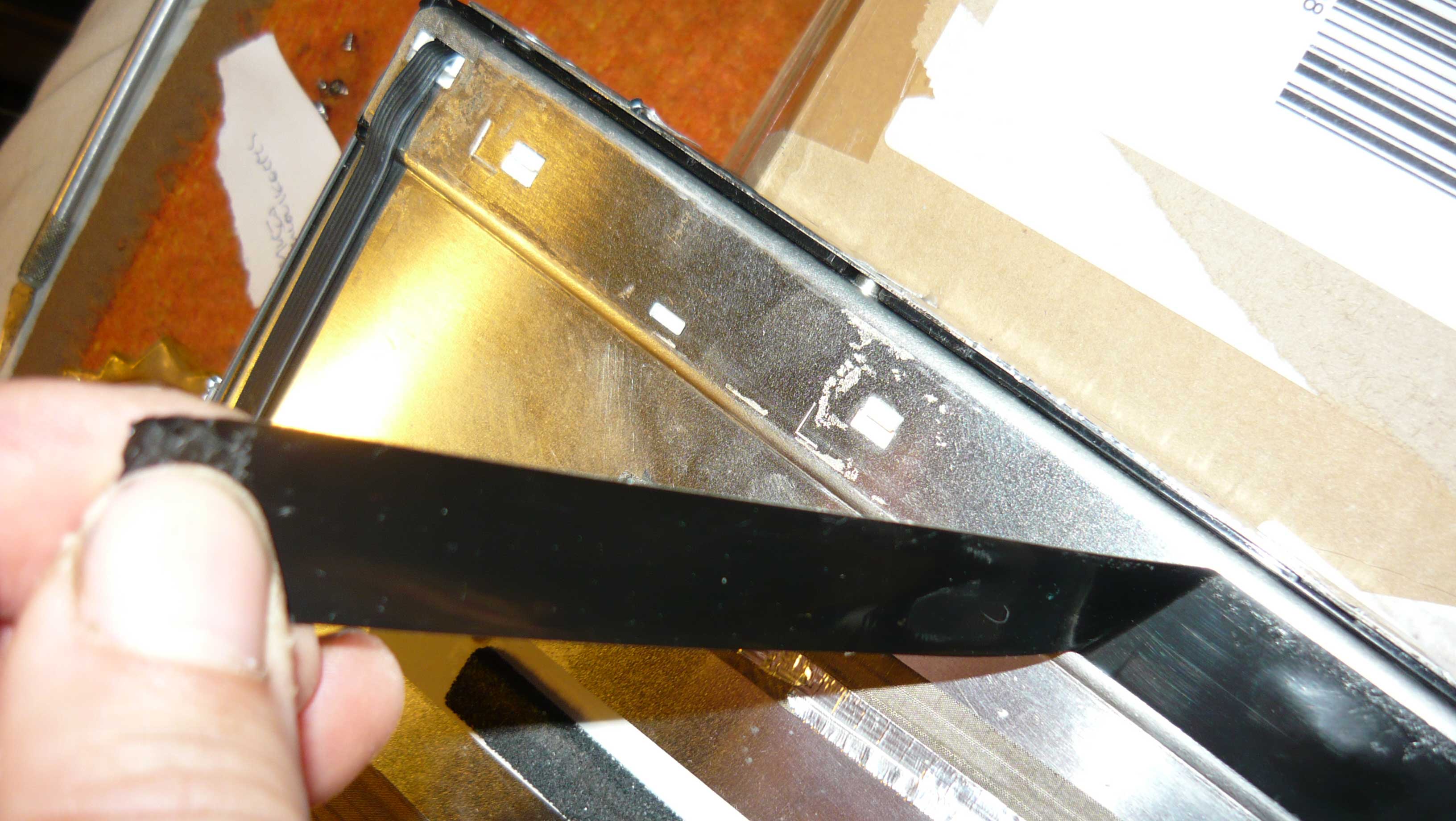

4) Behind the black tape there are clips holding the strip in place.
5) Cut the green glue strip with a surgeon's knife. Mind some metal pins still giving resistance!
