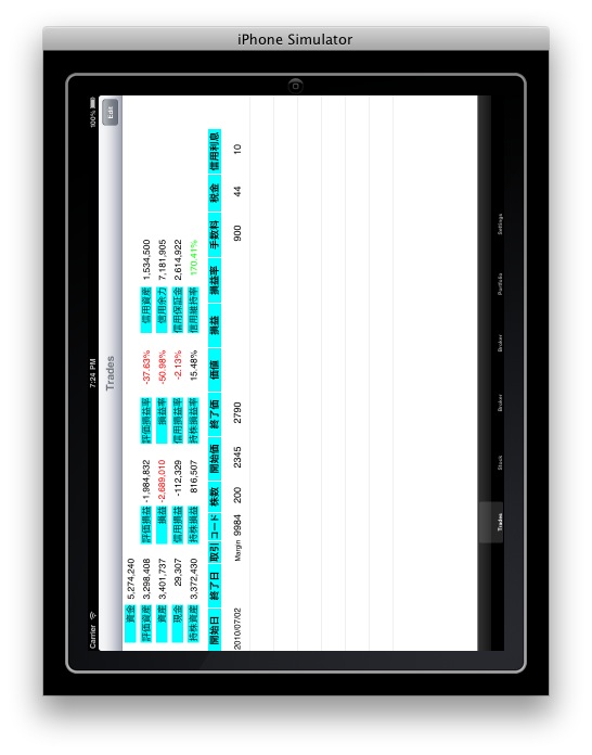

Well, When I run it, simulator turned in landscape mode, this is what I need.
But when I turned it left, I got a screen what I don't need, how can I solve it?
What I linked will load it and "lock" it in landscape right mode. If you want it to automatically roll with the direction you have it facing, you have to return YES for each orientation you want to support:
Code:
- (BOOL) shouldAutorotateToInterfaceOrientation: (UIInterfaceOrientation) interfaceOrientation {
// Return YES for supported orientations
return ((interfaceOrientation == UIInterfaceOrientationLandscapeRight) || (interfaceOrientation == UIInterfaceOrientationPotrait));
This would allow your app to run in portrait mode and in landscape-right mode. Of course you then have to do some view transformations in probably the viewDidAppear method otherwise your UI will look goofy as it rotates because none of the UI elements will be in the right place.

My question might be not so clear, I need run my app on both mode, so I return YES for shouldAutorotateToInterfaceOrientation before I post here.
My exact question is how to show simulator in landscape mode when start to run my app, then I can turn it left or right in portrait or landscape mode, may I make sense?
That's what putting that key in your main plist above does. You have to understand, you can't force someone to hold the device a certain way when they start your app. If they are holding it in portrait mode, because you allow both portrait and landscape, it will start up in landscape mode and flip to portrait mode as soon as the view finishes loading.
I honestly don't see much of a point forcing your app to start in landscape mode if you are going to allow your app to be run in both portrait and landscape mode. When it finishes loading, it's just going to flip to whatever orientation the user is holding it in, and for most of us, that's going to be portrait.
Yes, makes sense. And the only way I know how to force the Simulator to start with a certain orientation is to already have it running that way when you start your app, as I mentioned above.
