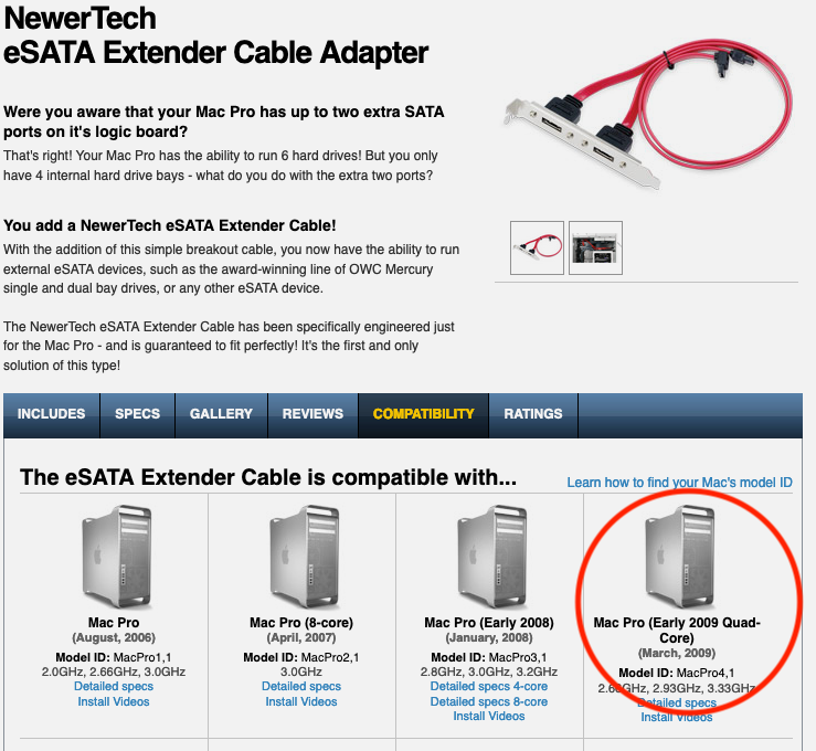

No, it's the 2008 that have SATA ports for the ODD but use PATA. MP4,1 and MP5,1 don't have any available SATA ports.
Maybe we should bring that fact to the attention of OWC, they are not often wrong about their products.
This is a real bummer for those of us who trust in their info when making purchases.

Just watched this install video and it shows how they do it by borrowing the unused Optical drive Sata port as seen in this video.
https://eshop.macsales.com/installvideos/macpro_2009_esata/

The only wait that I see this cable being used with a MP4,1 or MP5,1 is if you disconnect the SATA data cables for the ODD bays. But I don't really know if it will fit correctly.

From watching the install video the cable fits just fine.
I have a bare logic board in front of me now. The only connections available on the 4,1 or 5,1 board are the optical bay connectors period.
If you notice in the video, he removed an optical disc connector I order to install this. I believe OP already has those in use by SSD’s installed in his optical bay. He would have to sacrifice using the optical bay drives on at least one port, to gain one external port.
Btw, these can be easily damaged on some boards where the connectors get stuck at the plastic union that separates the twisted-pins coming off the LB. It can be difficult if not nearly impossible to repair.
