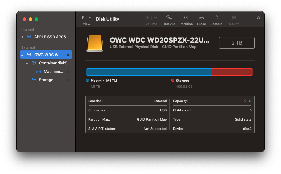

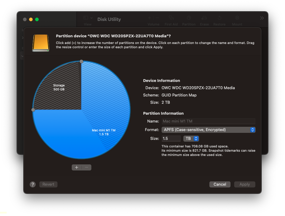

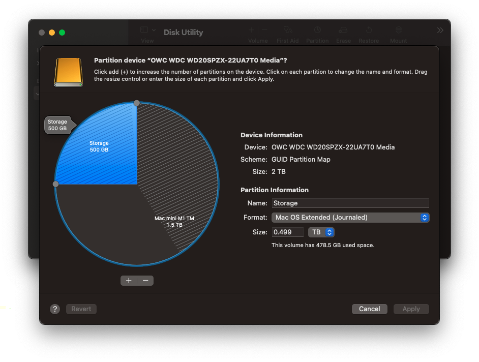

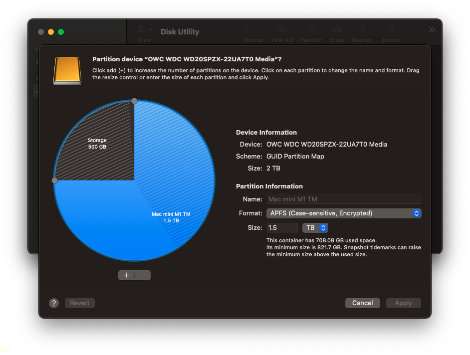

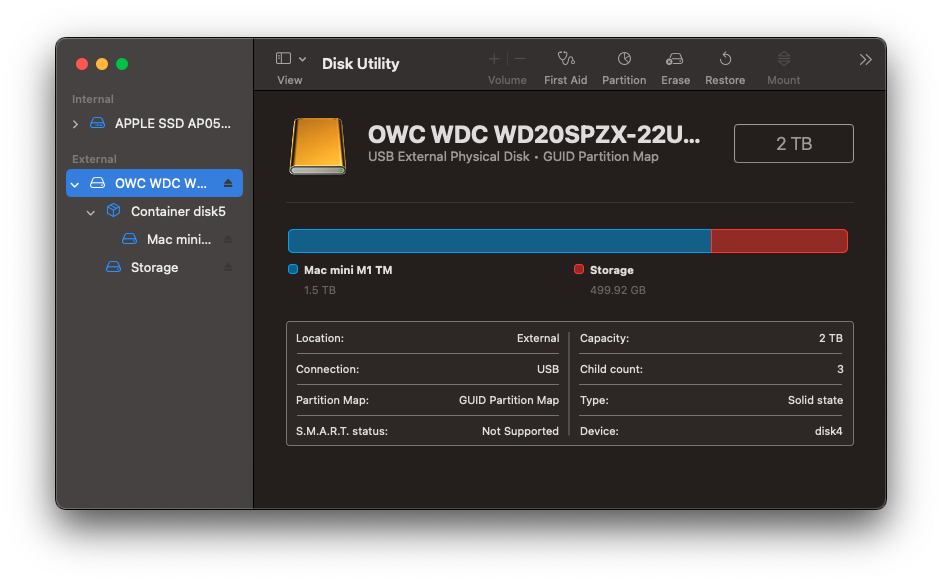

I’ve had a similar setup for years (the “Storage” partition is primarily ripped movies):
*** The media type is not “solid state” rather a 2.5” HDD. I’m not sure why Disk Utility is identifying it incorrectly.
