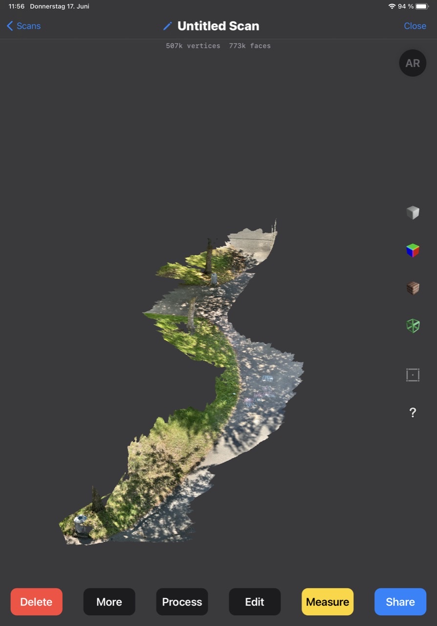

Is it possible to capture 9 acres of paths with lidar on the iPad? Or is that a little ridiculous?

you plan to walk a grid to cover the whole area of that 9 acres? I just for fun walked outside scanning my path, low res scan:
The result is a 21MB USDZ file. It takes about 40 seconds to create the file on an 11” iPad Pro 2020. Plus walking time. I could imagine if you walk a grid you can produce roughly 5 m wide and -max. length needs to be determined- bands which you could combine in a 3D program like e.g. Blender. But I don’t think it is actually feasible (mainly total time, and things like missing elavation data, etc.). ?

What app were you using here?
The free 3d Scanner app.
In the meantime I additionally tried to combine a few Scans in Apple‘s RealityComposer on an iPad Pro 2020 - sadly the app just shuts down when trying to load USDZ files like the one above. I didn’t have time to check wether RealityComposer on MacOS loads these files (and I didn’t check wether other file types like .OBJ work better).
Additionally I discovered that, while the USDZ file is just about 21MB, the 3d scanner app produces additional data of about 170Mb.
Scanning the surface area equivalent of 9 acres with an iPad Pro seems to be… let’s say: ambitious ?… you have to have at least some time ?… it‘s probably easier, cheaper - and slightly faster ? - to buy or get satellite imaging data for the area as well as GIS data to create a model. If this is what the OP wants to do?

That is probably the best idea. Will look into that.
