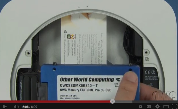

Just installed the Crucial M500 486gb in my late 2012 mini. worked like a charm, fiddle wifi, did not pull out logic board used the card trick to slide ssd into place.

elolaugesen, do you have a video example for this card trick? Would it work with a Mini 2010 (it has a DVD drive bay)?

There is a video out there saw it some time ago have to find it again.. Sorry just remembered seeing it and then used the trick.. Been discussed on the mac mini forum ???
https://forums.macrumors.com/attachment.php?attachmentid=457033&d=1390063304
All i could find. Lots examples on you tube...
Look down see the two brackets for the ssd/disk. Space between them. Place card stiff long card between and ssd should with some help. Wiggling moving help etc slide in. Tight space but it worked .. Took 5 minutes to do it....

Looks like it worked. I only couldn't migrate the Bootcamp partition yet. It's not an easy task, I didn't have all the recommended tools (I had a T6, an allen which fitted some T8 screws and a 2mm flathead screwdriver which fitted a T-unknown screw :) ). There was an additional screw which I only could remove with pliers -- one in the logic board and another two in the original HDD. I also had a plastic spudger which served well for removing that small and fragile connectors.
I did a slight wear on that isolating material which wraps the HDD, but I applied isolating tape on the small torn part. Luckily, nothing really bad happened (as messing wi-fi and cooler connectors or temperature sensors from the HDD).
