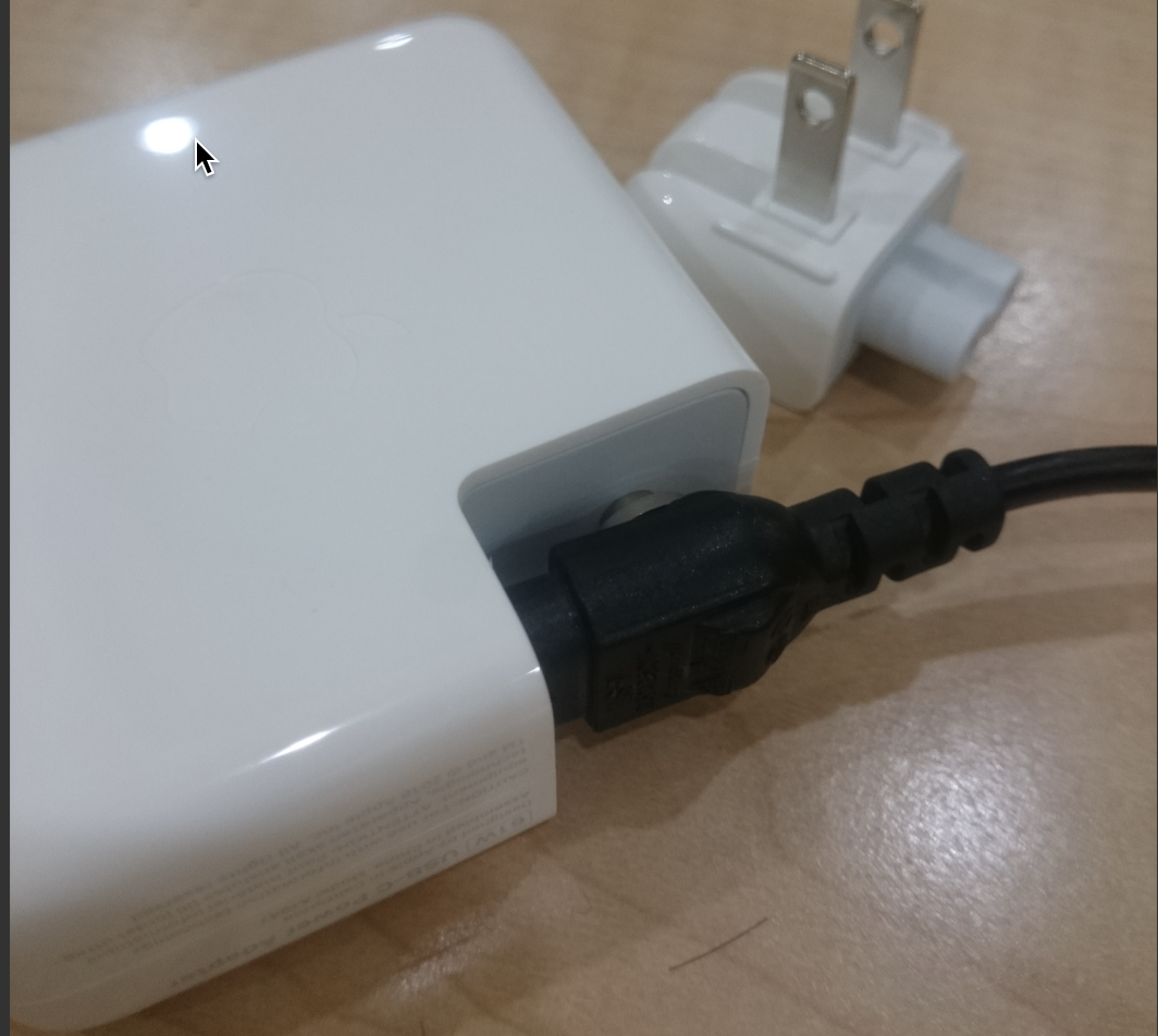

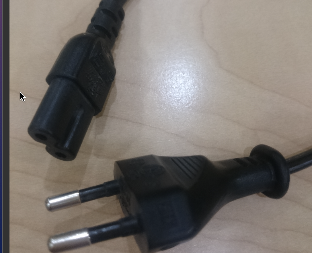

I have this wire:
Is it safe to plug it like this to charge the MBP ?
I don't think it's a problem but my concern is that it's written '2.5 A' in the black wire, I think it means Amps, So any idea ?

Because I bought the MBP from US and now I am in a different country that use the same power prog like shown in the first picture.
There's no reason it wouldn't work fine. If you have the option to use a grounded outlet with the proper Apple power cord for your country, that'd be preferable, however.

It's completely safe. Don't worry about that 2.5 Amp rating. The black wire is rated 2.5A at 240V. That's well over the 87W needed by the power adapter.
