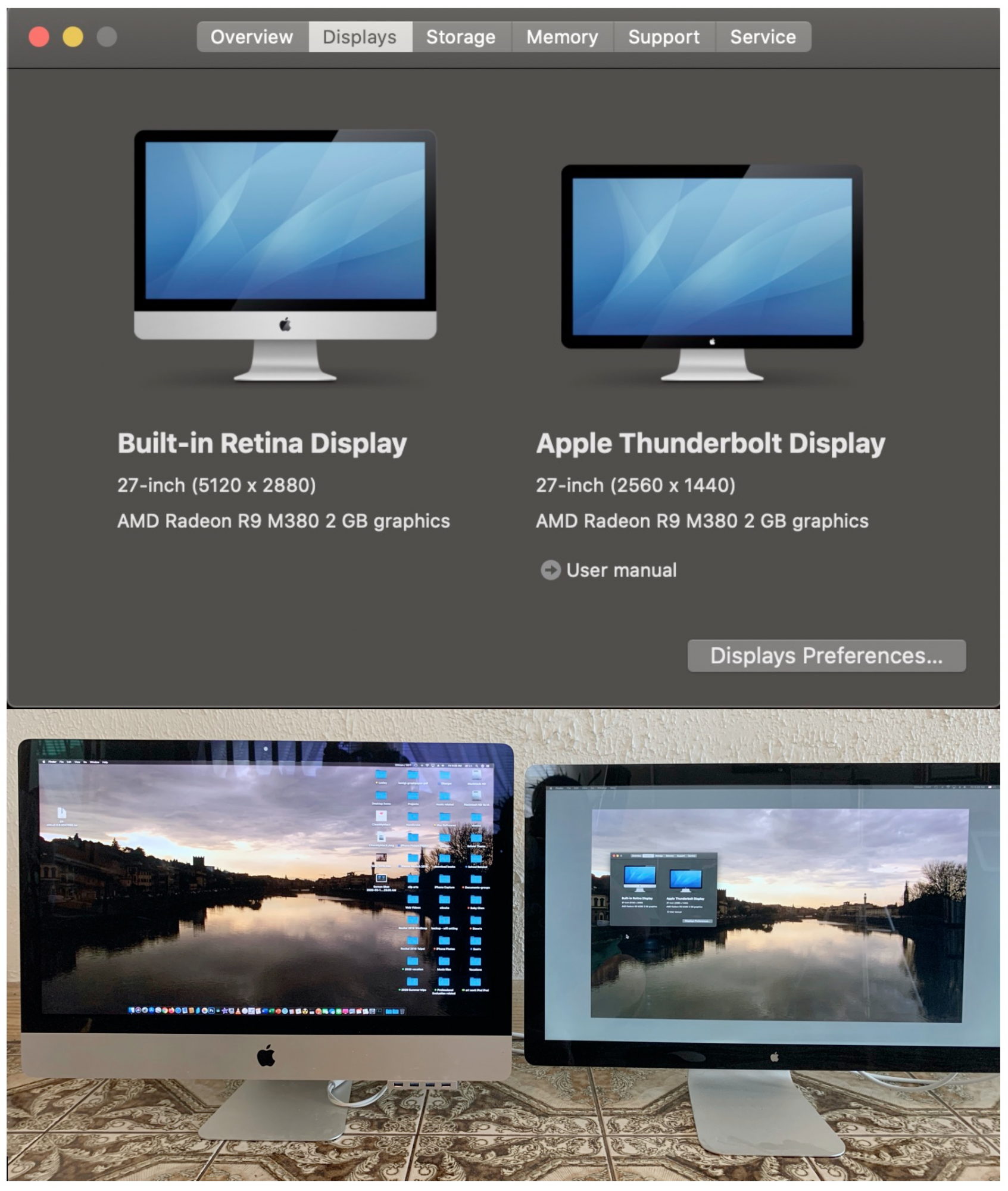

I found out that I could use my Apple thunderbolt display with a 5k iMac on the Apple support forum.I asked this question on here but no one answered it but as you can see i can use my Apple thunderbolt with 5k.If i was to get a 4k 21 i am right to assume assume the 4k would show up smaller than the 5k on my Apple thunder bolt display?

Not sure what you're asking about the monitors. If you have scaling turned on. Items like text should appear the same on a 21" 4K as a 27" 5K. As they have nearly equal PPI. You just have less screen real estate.
