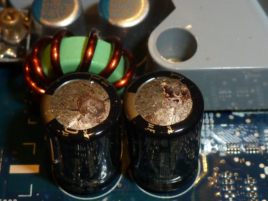

Well, after a few months of sluggish performance and random hangs, my kitchen iMac G5 decided not to start up.
The screen is scrambled at boot then gets to the blue screen with video artefacts until the fans start revving up. Nothing advancing to the desktop.
I opened up the iMac to look at the diagnostic LEDS and the three green lights were showing normal power and communication.
However, I noticed two of the many capacitors were blown/leaking. Reading up, I found out that the iMac G5s were plagued with capacitor issues and the repair program unfortunately ended in 2008.
Now, in my research, I've been seeing repair costs of about $200 for replacing all the capacitors on the motherboard. I don't know what the local Apple Repair depot will actually charge. Replacing all the capacitors might not even fix the machine if the CPU has been over-heated.
So at this point in time, is it worth repair this machine??? What do you think? Has it served it's life cycle in its eight years?

from what I gather, it's a tricky soldering job. You need a high heat precision soldering iron, not a 25 watt cheapie. The capacitor set will cost from $20-$30 on eBay.

I've done capacitors on several of these. Its really not hard at all if you've done any soldering before. The caps are cheap, so whats the worst you have to lose? Go for it.
I've fixed a good number of these, and can tell you yes, it is an involved job. I have a fairly expensive soldering station that is required to desolder that lead-free board. It's 70watts/900 degrees. That, as well as special desoldering flux to lower the melting temp, and rosin core lead free solder is required. I have fixed 3 successfully, and just started as a hobby. I am a Computer Engineering major, and have been soldering for years. I am very comfortable doing the repair, but it is vary challenging and time consuming.

I'm awaiting arrival of a capacitor kit from http://www.thecapking.com/applg5.html $21CDN. incl. shipping.
My G5 iMac went wonky last week, but thanks to my elderly iBook I was able to get back online and do some research. Upon opening the iMac I too found leaky capacitors, and was dismayed until I queried a friend who had done a previous electrical repair for me. He said "sure, just order that kit and I can do the repair in an afternoon". Excellent! Especially since I had been a little slack in my Time Machine back-ups and had a few days of emails stuck on the thing.
