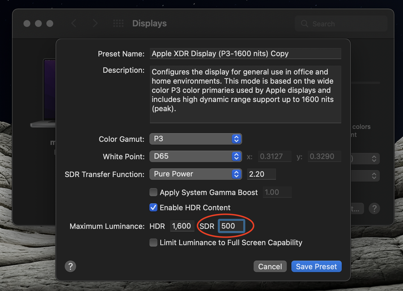

I tried messing with the settings by going to System Preferences -> Displays -> Presets -> Custom Presets -> "+" icon at the bottom. It doesn't let me set the max brightness for SDR (standard dynamic range) past 500 nits. If I put in 600, it truncates the value to just "60". I can't even do "501".

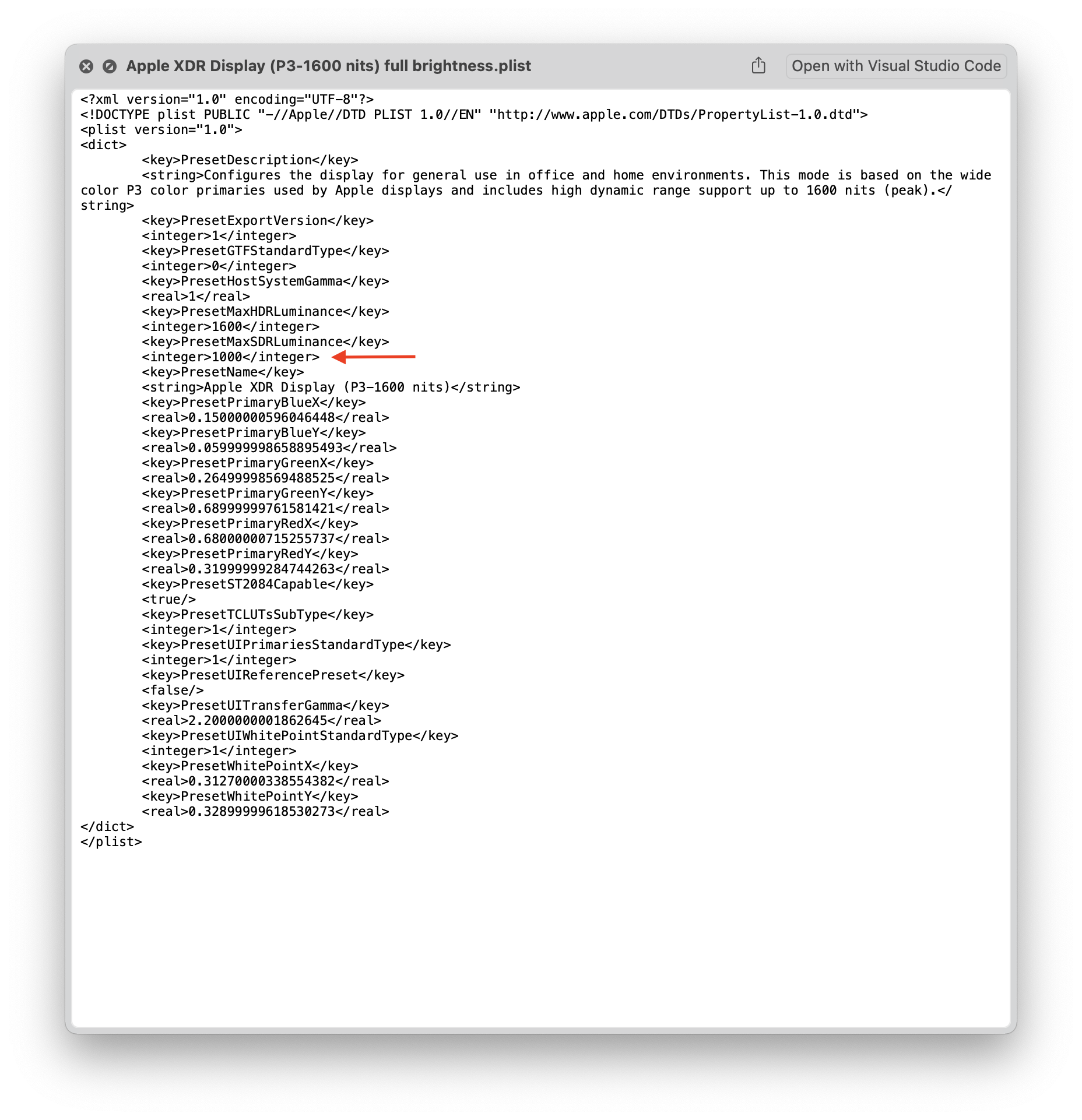

Really interesting. I ran `defaults read` but it didn’t turn anything promising up.
However, I did notice that you can export the display profile to a plist file, edit it, then reimport it. I haven’t personally tried going over the defaults, though, since I don’t need it myself.

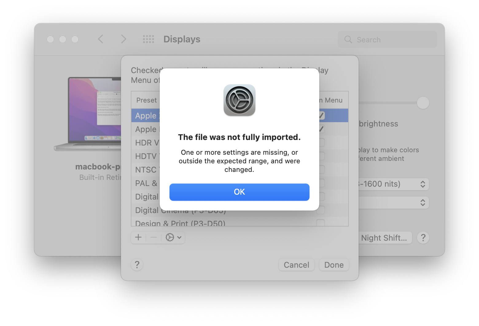

I updated the 500 to 1000 and tried importing it

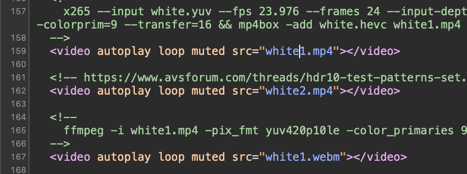

Looking at the HTML source it seems the web page only applies a filter, reducing the brightness of the background.
This the title appear brighter. I have not dug out my colorimeter but I doubt we are seeing a brighter white, or?
I may be looking at different html source:
According to their docs, there are HDR videos playing in the background, which cause the display to move to HDR mode.
