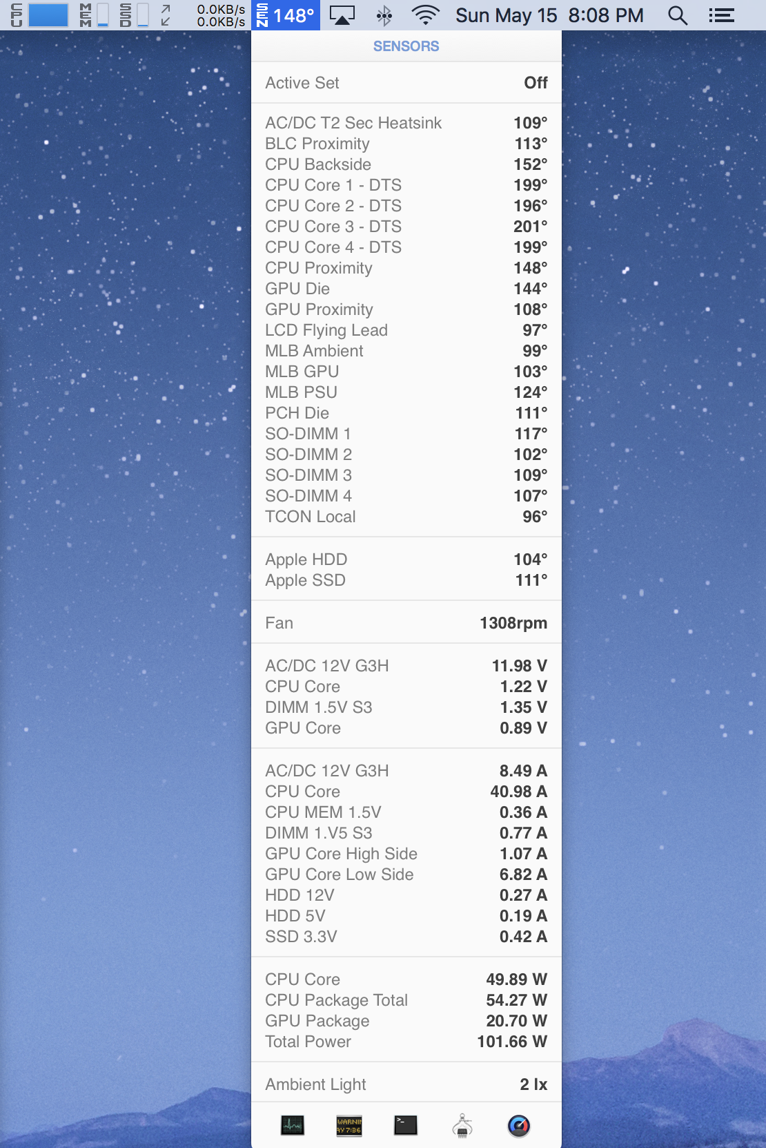

Hi Guys -
I just got my new 5K iMac (Late 2015) and I'm burning my Blu-Rays over to my external hard drive via HandBrake.
I felt the back of my computer and I noticed it felt hot. I downloaded iStat Menus and saw this information - Is my computer running too hot?
If so, is this normal/should I do anything to cool it? (Temperature in Fahrenheit)

Handbrake is a rather intensive program and so that will account for your iMac to run rather hot. The CPU will throttle itself when it gets too hot, though I would maybe recommend it cools down a bit before burning any more blu-rays

So, is my computer too hot? Why is my fan only at 1300 rpm?

No, though you may try to reset the SMC, that may very well fix the fans.

Its my understanding that even on Skylake, if you push the CPU hard (like encoding blu-ray), you'll be generating heat. I don't use handbrake, so I don't know if those temps are too hot, but I do know that using that app will cause a spike in the temps.

My 2015 iMac 5K does not work the fans nearly as hard with Handbrake as my 2014 iMac 5K did, so 1300RPM fan speed may be fine.

What temperature would be considered too hot? Just to reference, I'm not burning Blu-Rays, I'm copying them onto an external hard drive. Should I mess with Macs Fan Control so I can turn the fan up so it doesn't get too hot or leave it as is?
The CPU of the newer iMacs can safely run at 200-210°F, plus the internal thermal protection will lower the clock and voltage in case the temp goes over 215°F.
You can't burn your CPU, even if your fan is not working properly.
