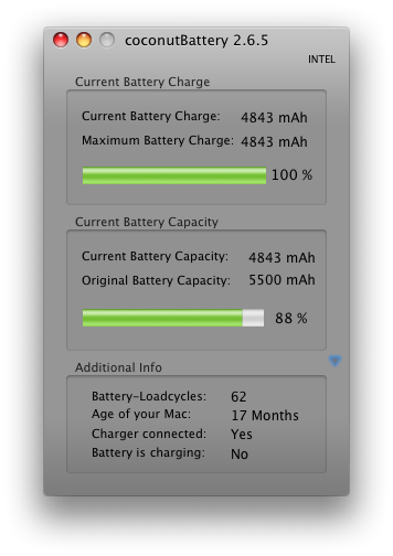

I don't think mine to too bad ... given that it is 17 months old. (Bought it a year ago, was at the store for 6 months...)
