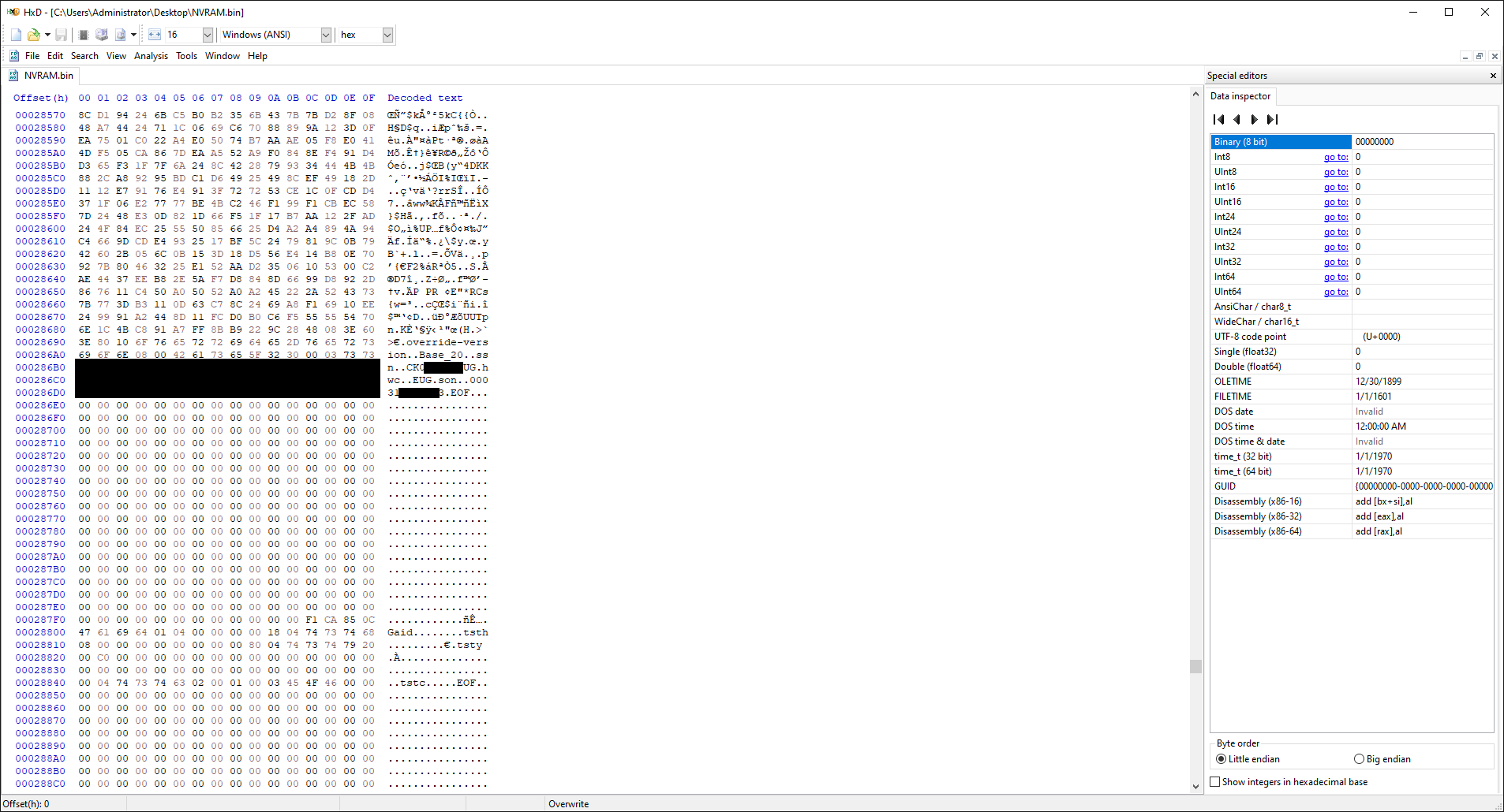

After having issues with my MP5.1 and it not playing the chime anymore, I followed @tsialex instructions and desoldered the SPI flash, then dumped the BootROM. My plan was to verify and flash the dump or reconstruct if corrupted. I extracted the NVRAM section and it still has SON and UUID.
How can I confirm the BootROM is valid without flashing it to a new SPI and soldering it to the board?

Validating all the free space indicators and checksums. See the Intel EFI v1.10 documentation to know how to do it, don't forget the big-endian/little endian.
Btw, there are 7 different hardwareIDs inside the NVRAM volume and MLB sector - you need all to be correct to have iCloud/Messages/FaceTime support.
