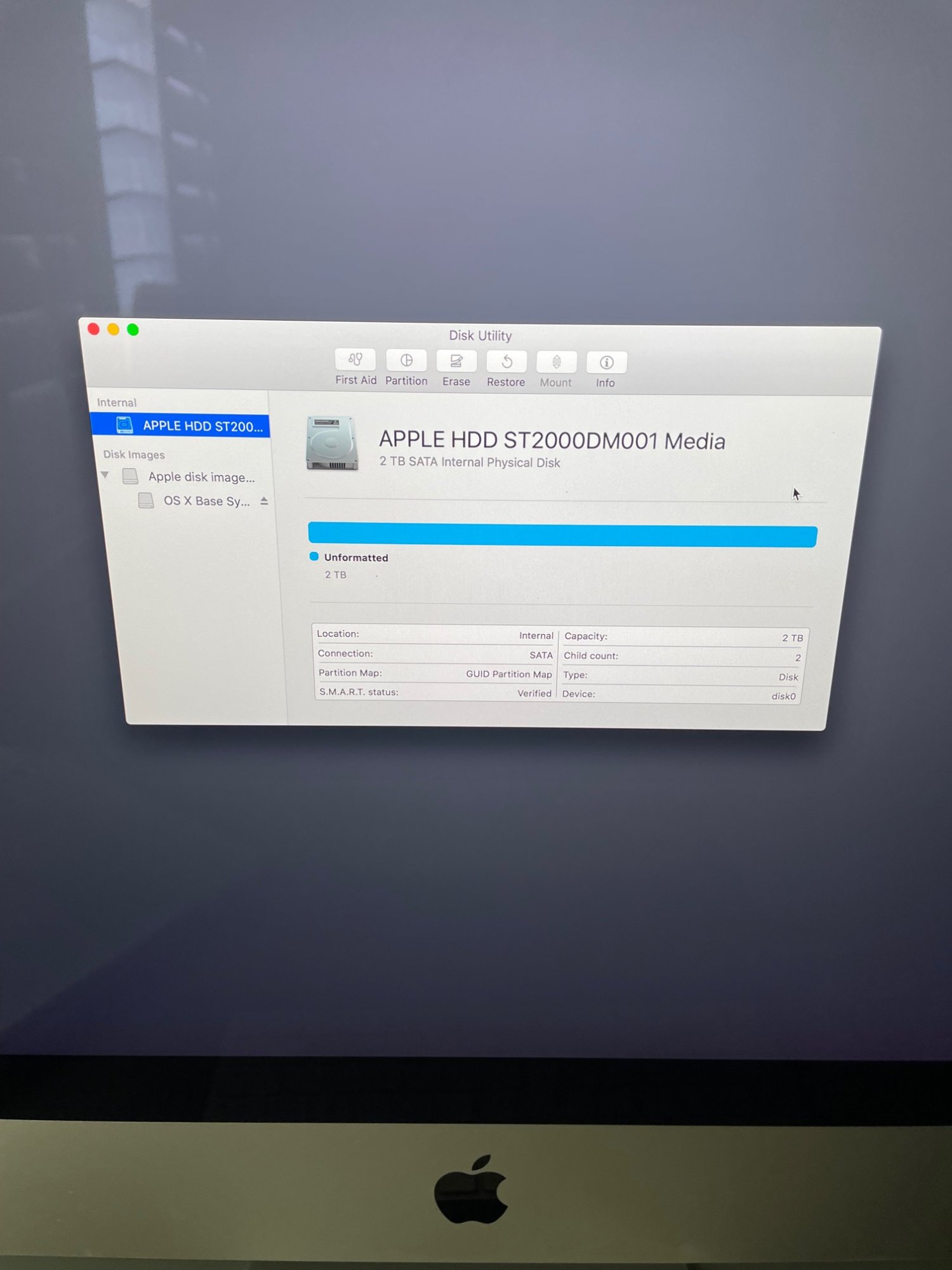

Ok. I have more details.
- Mac is the Late 2015 with 2TB. The iMac 17,1. That means it has 128 DB SSD and the 2TB HDD.
- She is running Big Sur
- She has a Time Machine backup. But doesn't know how current. I know she has it as of at least a few months ago. Thus I do NOT want to touch/reformat the 2TB HDD. I would rather get an external SSD booting OR replace the internal SSD and then check out what the 2TB looks like.

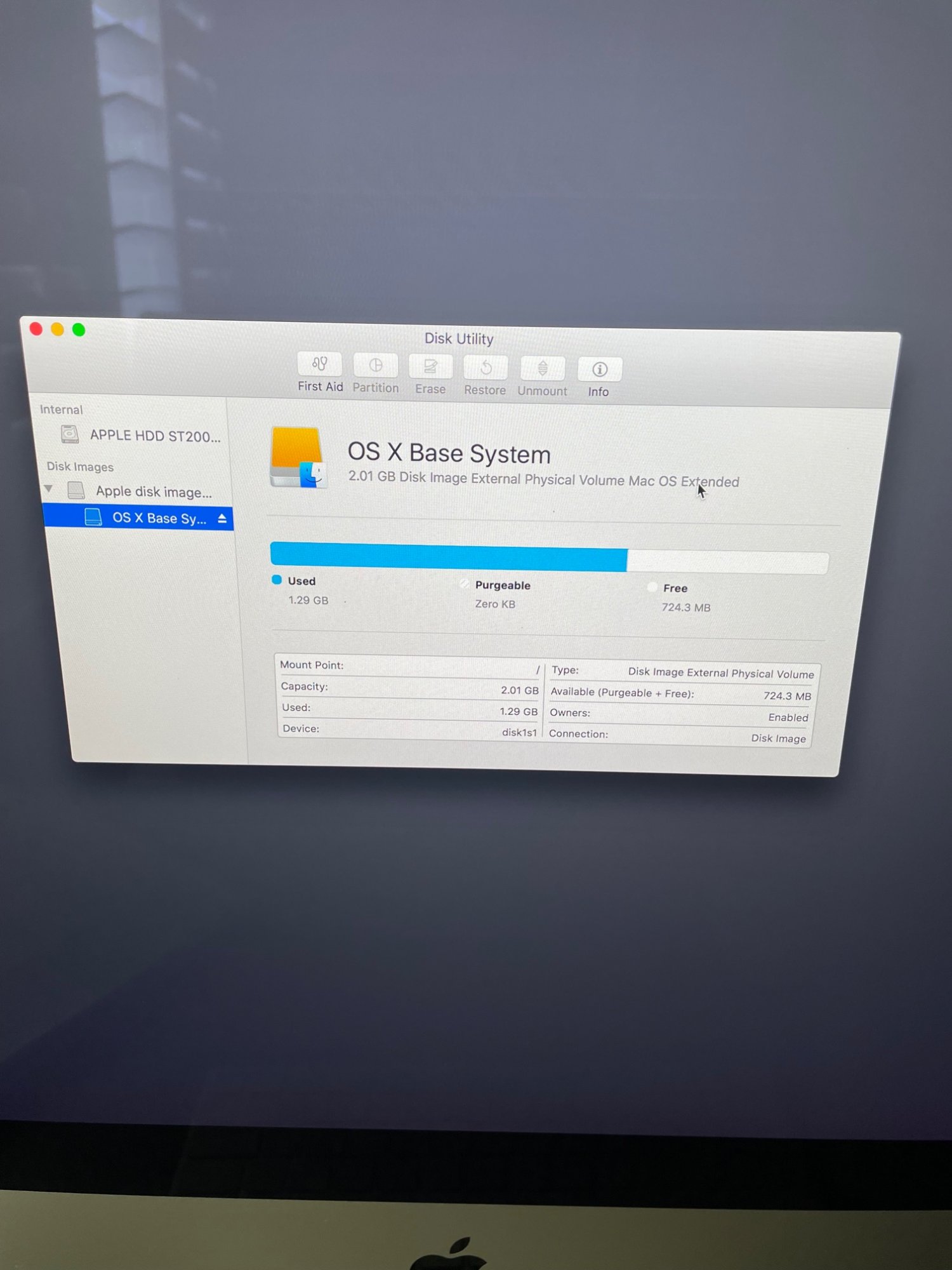

Running Internet Recovery, then jumping into Disk utility she shows these (see attached). That would tell me her iMac can see the 2TB drive...but I don't see a 128GB SSD in there.
Also I assume the OS X Base System is on the 2TB drive. Right? I've never understood where that is stored. If it was stored on the SSD, then it's functioning. I'm a bit confused.
