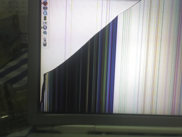

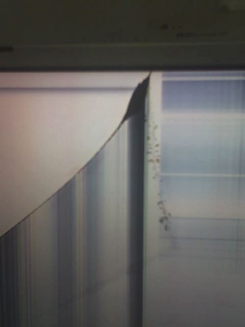

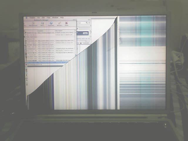

I dont realy know if this a screen problem or a video problem... everyday the usable view area gets fewer... please see the photos to see if you can check what the problem is.
Please let me know urgently!!
and a solution also.

Do you have the hardware diagnostics CD?
Since you say it keeps getting worse I would assume the GPU is failing based on the pictures. Repair would require replacing the motherboard. In which case you would be better off eBaying the computer for parts, which can recover a pretty decent value. Then purchase either a used Powerbook or Macbook off eBay if price is a concern, otherwise buy new.
This is a work laptop. So is it better to spend weeks futzing with it losing out productivity or just to get it replaced?
The LCD is cracked. See how part of it works fine and another is messed up? Besides the lines. That happens on cracked LCD's too.
Close the screen and wake it up with an external keyboard/mouse/monitor attached and it should work fine on the external monitor. This will not fix the built in screen.
