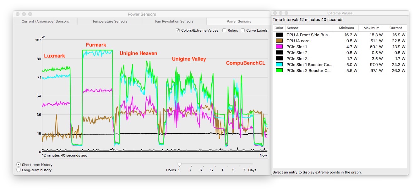

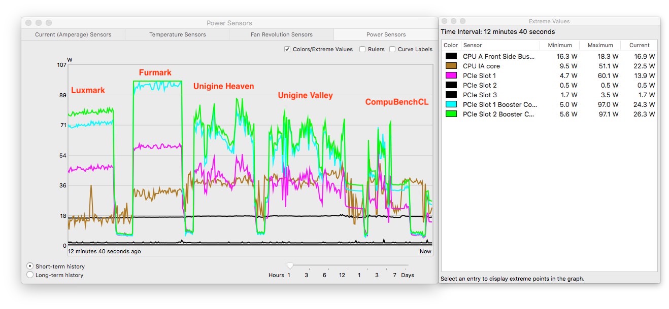

They are all 250W TDP, and the power draw is not that high in general. In fact, I just did the power draw test from my 1080Ti reference card 2 days ago.
Since I did the load balance between the mini 6pins, therefore, the 2 boosters always shows similar readings. Anyway, as you can see, apart from Furmark, the 6+8 pin combined power draw rarely exceed 150W, that means if the card draw power by 1:2 proportion, it will draw 100W from the 8pin, and 50W from the 6pin. Which also means, a single mini 6pin -> 8pin will survive.
However, it you run Furmark with that cable config. There is a high chance the Mac will shut down. Because it will draw 200W in total from the 6+8pin. And the 6pin can only deliver up to 75W (in fact, I suspect it will only draw up to ~65W and draw the remaining 135W from the 8pin). This may trigger the shut down protection.
Anyway, back to the topic. Since you already confirmed it's a reboot, but not shut down. So, it's already rule out your card overloaded the PCIe slot or the mini 6pins.
From the consistence of the issue. I will narrow down the source to either a faulty card, or software.
Since you mentioned about "boot screen", and your card is not the Mac edition card. There is a high chance that you get a badly flashed card. Which can cause all sorts of issues. If you can get a full refund. I will return that card without any hesitation.

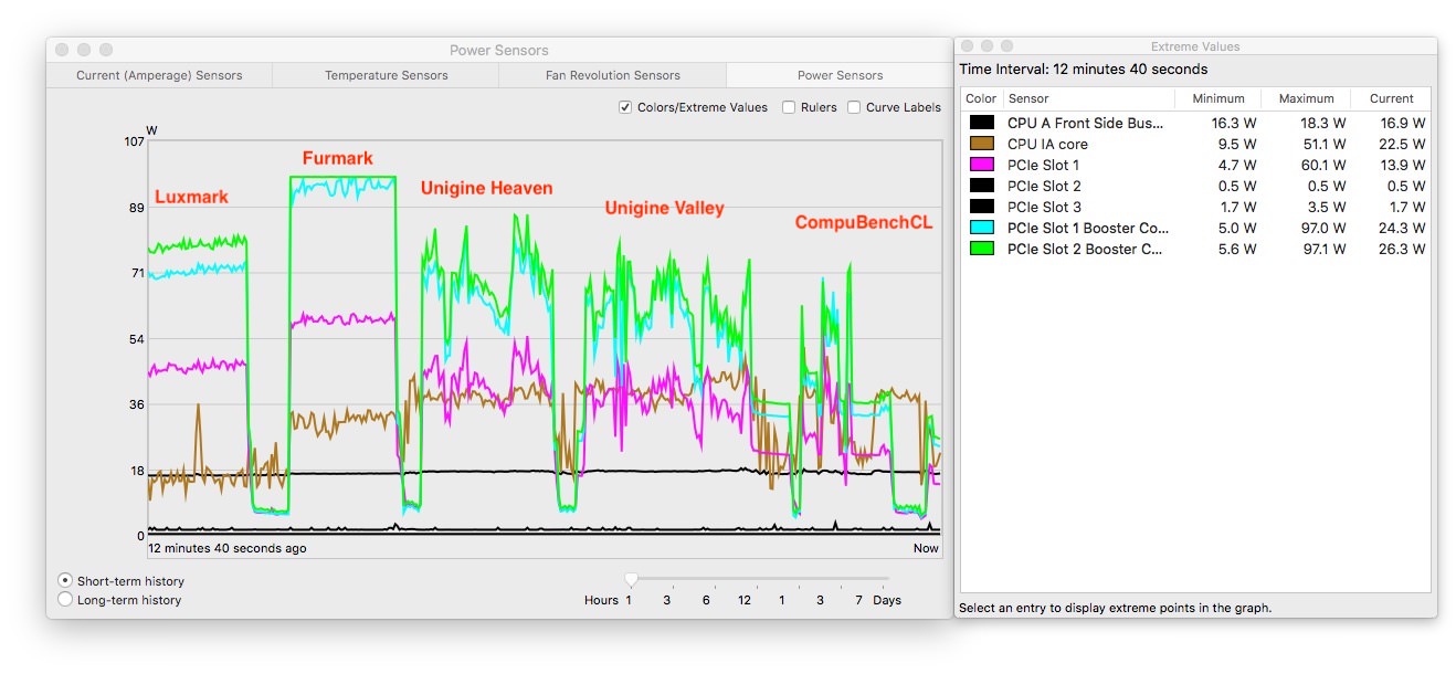

View attachment 734314Since I did the load balance between the mini 6pins, therefore, the 2 boosters always shows similar readings. Anyway, as you can see, apart from Furmark, the 6+8 pin combined power draw rarely exceed 150W, that means if the card draw power by 1:2 proportion, it will draw 100W from the 8pin, and 50W from the 6pin. Which also means, a single mini 6pin -> 8pin will survive.
