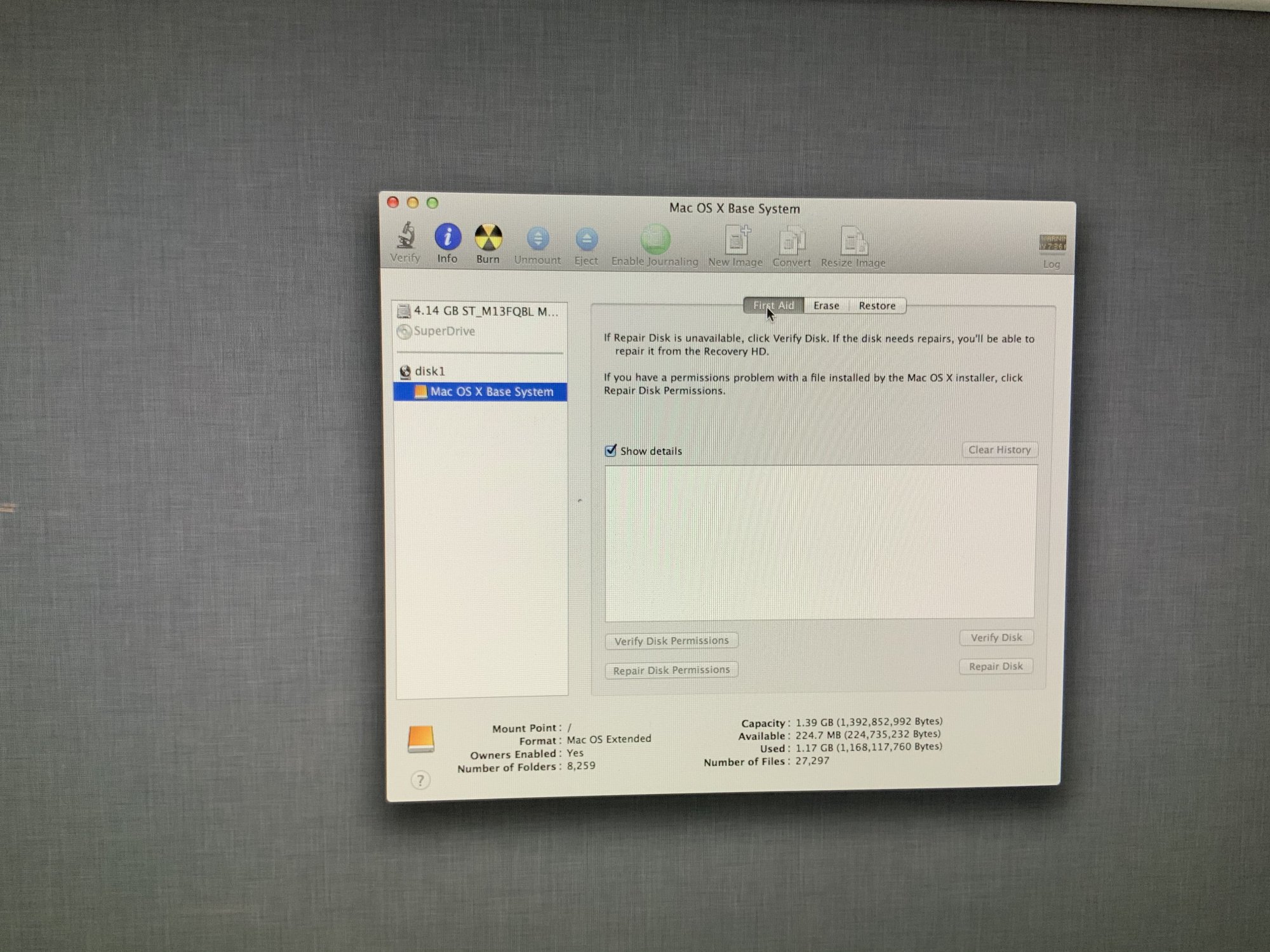

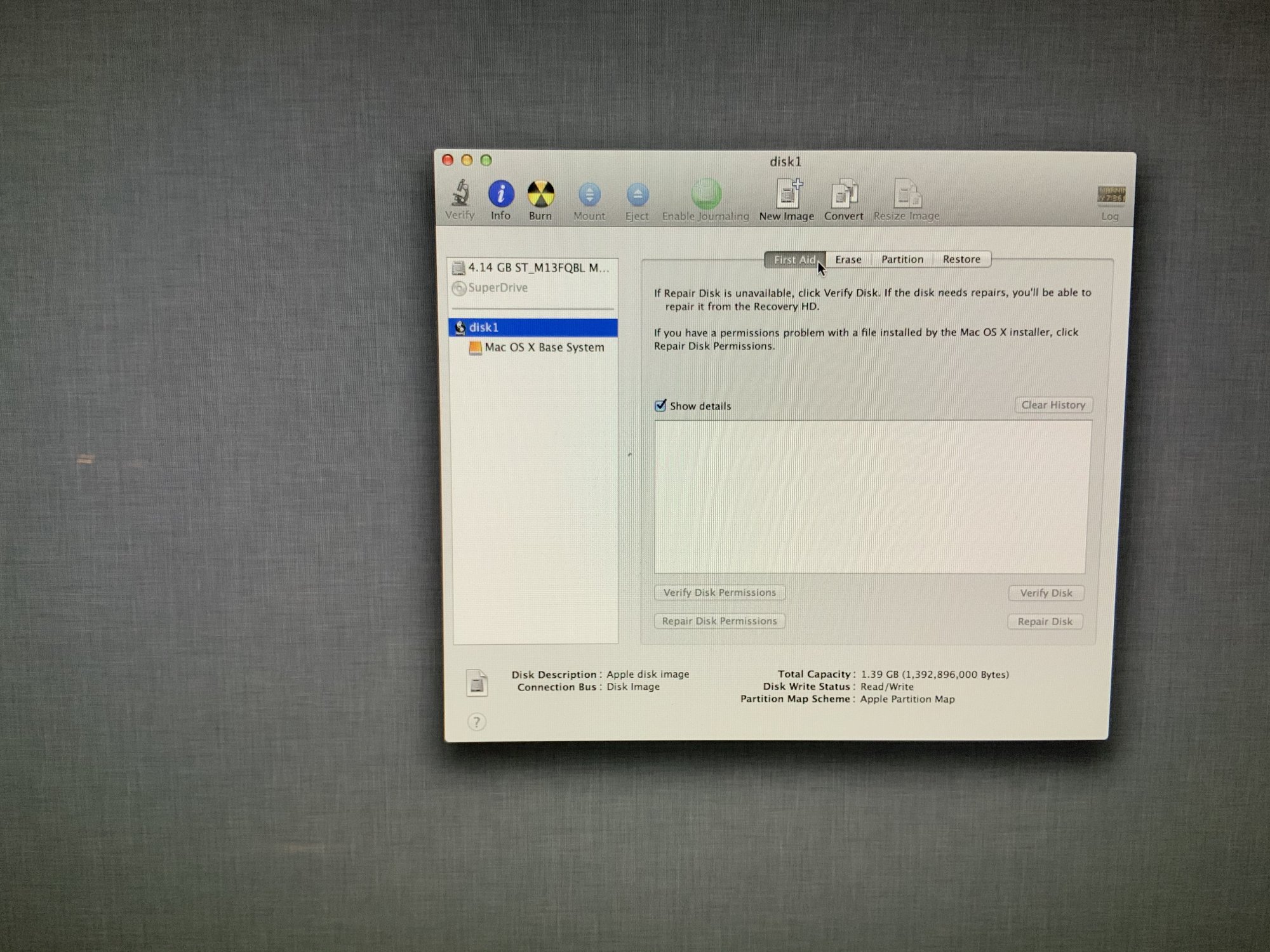

Hello, all. I am pretty sure the answer is yes but I thought I should ask in case I am missing something. Earlier today I turned on my trusty imac only to hear the dreaded "clicking" sound and then see a folder with a question mark.
I assumed the clicking noise pretty much indicated the end of my hdd but still, I restarted, pressed cmd+r and when going into disk utility I only saw what is on the attached screenshots. I don't even know why it says the hard drive is 1.something Gb, it was a 1Tb drive with a 100gb partition (that is not showing either). I also don't know what that first drive is, the 4.14gb one.

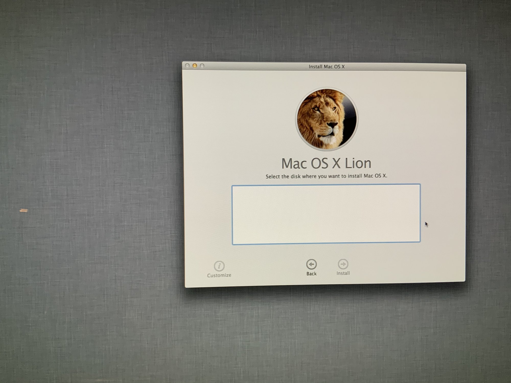

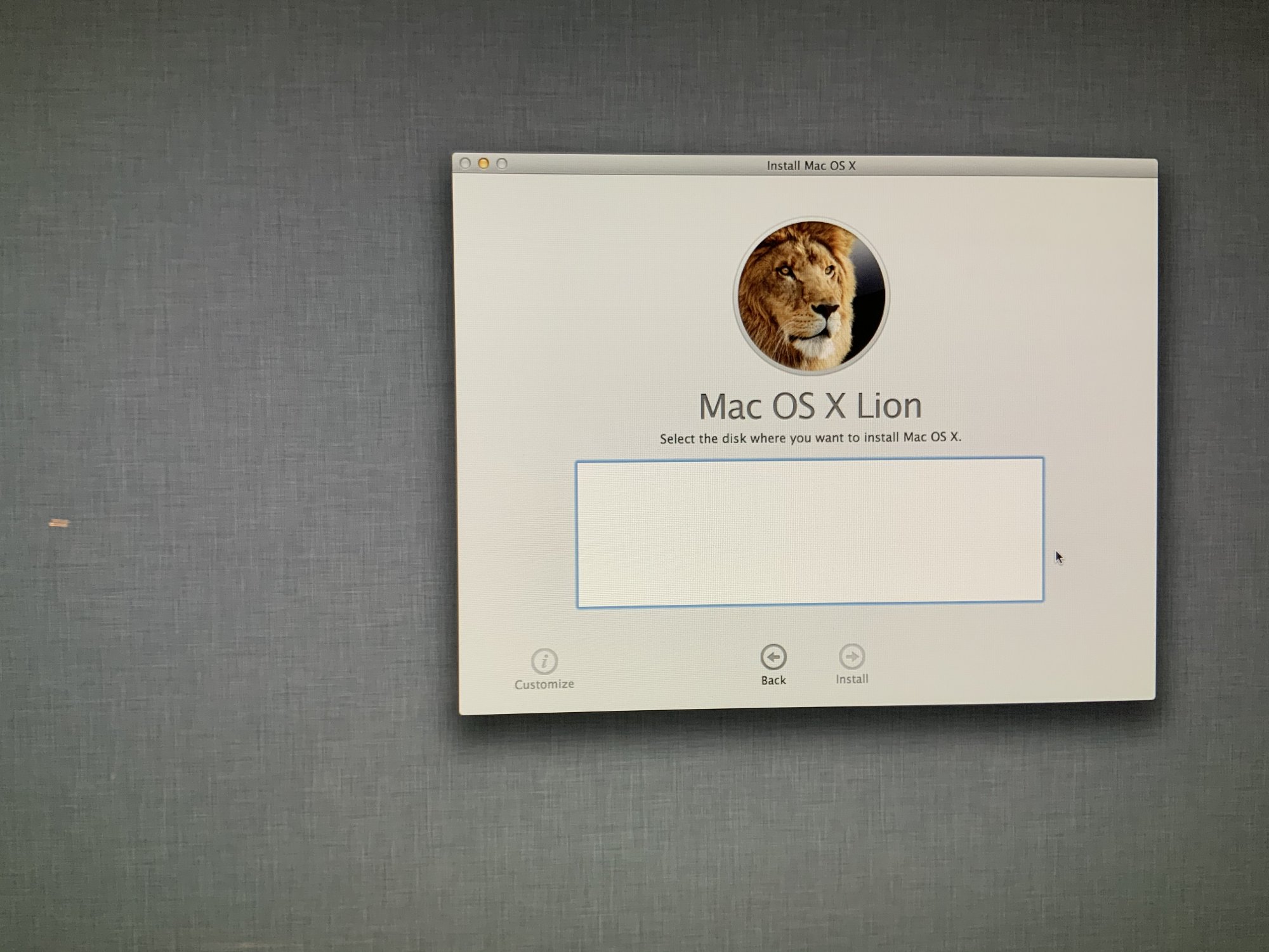

For good measure I decided to try the option of installing mac os x lion from the system recovery menu but no disk is showing for me so I guess that just confirms it and the hard drive is, indeed, dead. Anyway, thanks in advance and please let me know if I missed something.

I did the Apple Hardware Test and got the following error 4MOT/4/40000003: hdd-1231 which I'm assuming has to do with the HDD's motor and that would explain the clicking sound :/
MOT indicates a motor fault. Hopefully it's the hard drive motor, not the motor in the cooling fan or a cable fault.
