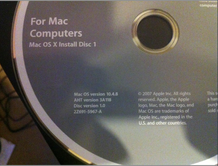

So can you try to run hardware test?
Don't know why AHT still won't run, (no errors just goes straight to login), but whilst in Tiger which boots about 8 seconds after the white screen appears, the complete system runs fine. I can watch DVDs and can get an output from nvram -p.
Boot back into ML and no dice. It's gotta be a combination of 10.8.2 and my hardware.

Well.. my bad, Macs before 10.5 was on Disc 1 Macs on or after 10.6 was on Disc 2. Hold down D key while the DVD is in? Have you make sure that the disc is actually working? Ref link: http://support.apple.com/kb/HT1509
Should be. I just installed Tiger from it.
EDIT: Right, got AHT to run, (in extended), came up clean. I think the problem was because the disc was in the second, lower drive connected to the spare ODD SATA?
