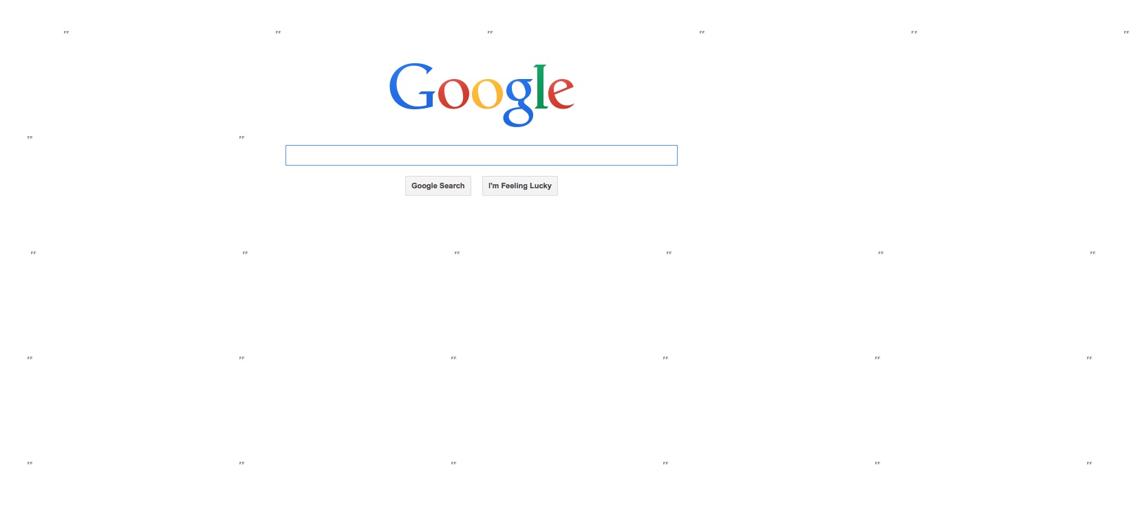

This morning I'm trying to work on my iMac.
I keep getting the spinning the beach ball but think nothing of it.
Then I notice that Google looks different. It has all these " marks all over the screen.
Google on my iPhone, ipads, and MBP all looks good.
Only on my iMac does it have the " marks all over it.
I can't type because it just hangs and the beach ball spins and spins.
I've run ClamXav twice now and each time it came up clean.
I'm running Yosemite and everything is up to date.
I've attached a pic of what Google looks like for me.
Help?

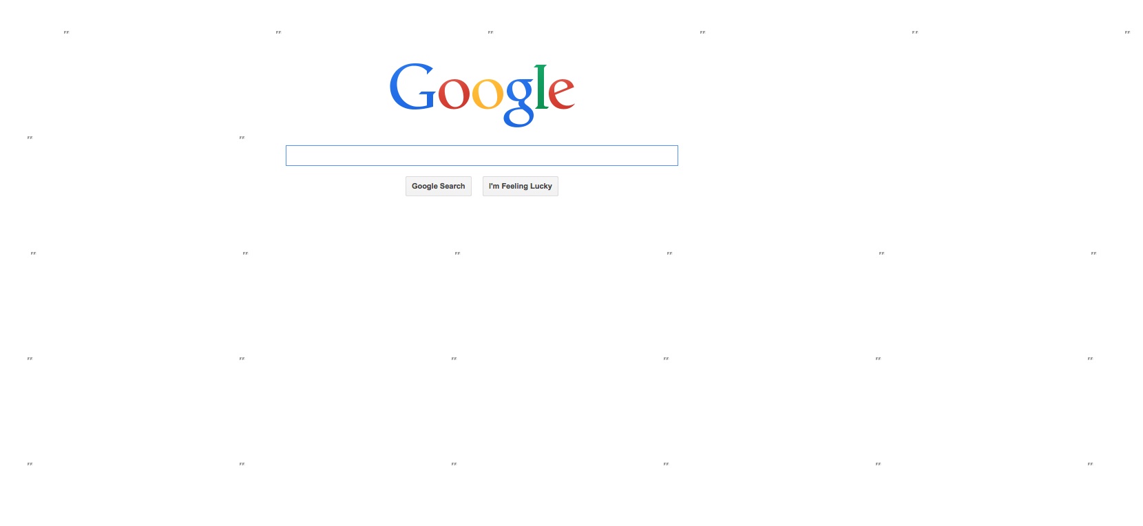

Help?
Are you using Safari?
Restart Sarari holding shift key.
Thanks for your response.
Didn't work.
I kept searching and downloaded/ran AdwareMedic that was suggested in some other post.
AdwareMedic found 2 Safari extensions that were removed.
Just like that, my internet was up and running like nothing.
Not sure what the problem was or how I got those 2 extensions.
Problem is now resolved... I think.
Thanks again!
