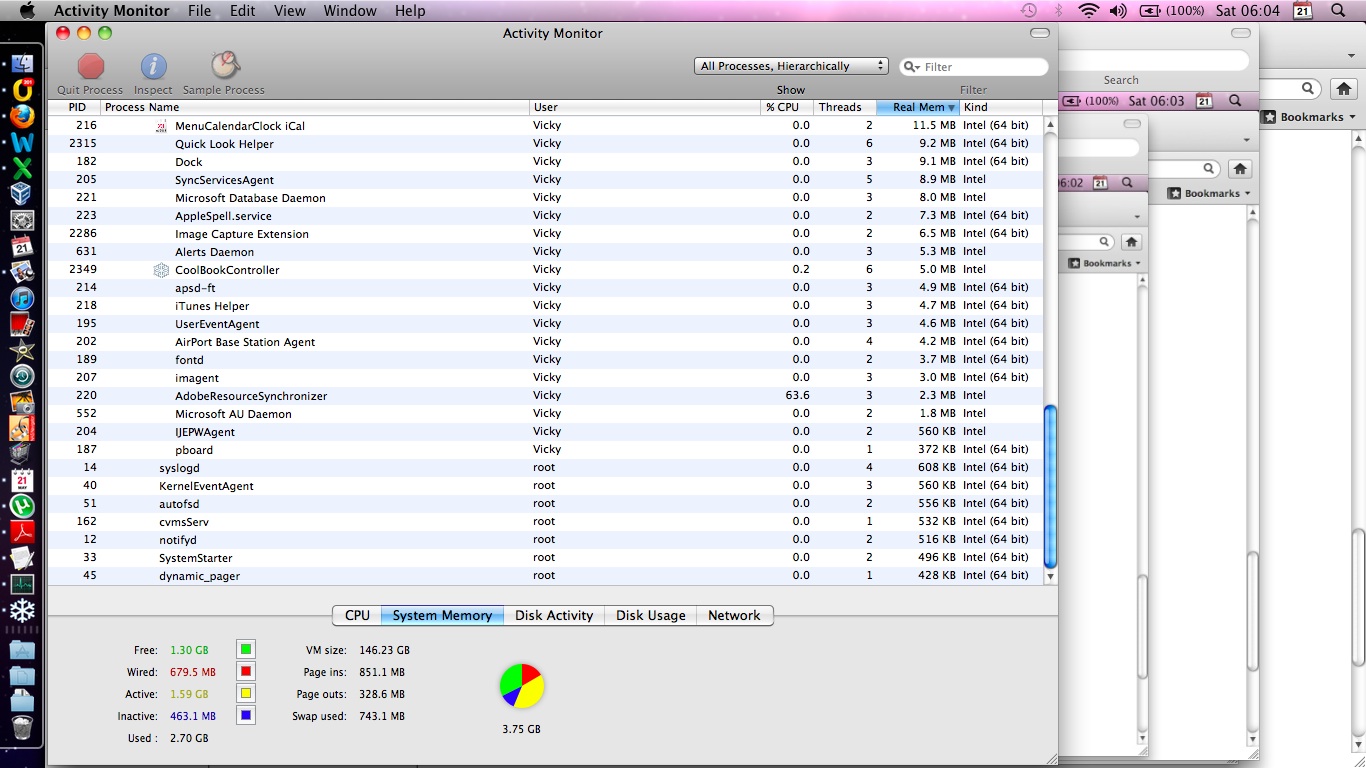

My macbook air 11.6 is running really slow. Its painful actually. I'm talking minutes to load each page.
Being a new mac convert, I only know that if this was a pc I would be running my anti virus, spyware and adware software and doing a config, but I have no idea what the equivalent is on the mac.
Don't know if its a coincidence but I did an online survey just before the problem started and have been getting pop ups which I never had before.
This is driving me crazy so if anyone can help I would be very grateful.

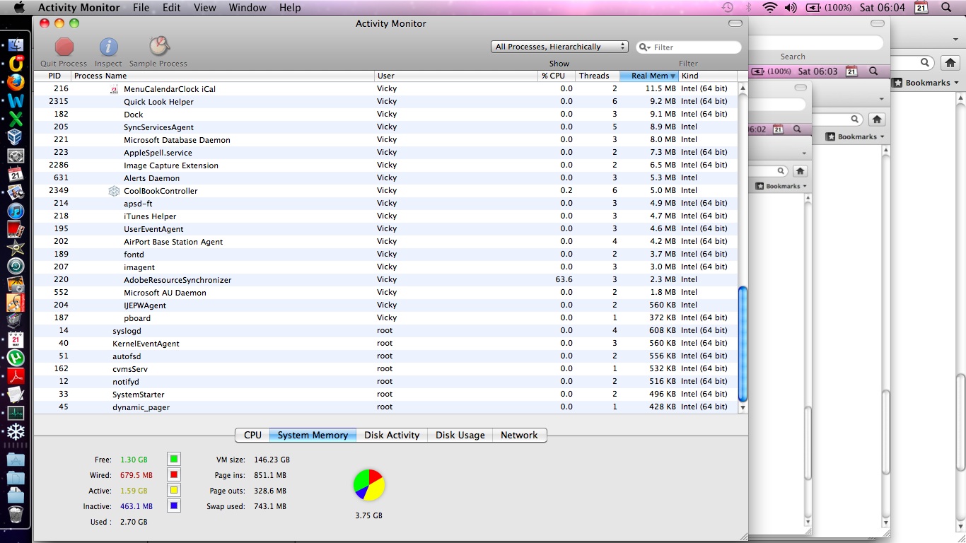

Open Activity Monitor (search Spotlight for it) and sort the list under System Memory by the amount of Real Memory the program is taking up first.
Then post back with the results. Leave everything the same as you have it now.
Hope this has worked.
Set Activity Monitor to "All processes, hierarchical." Then, repost the screen shot. Make sure to screen shot all the contents listed Activity Monitor.

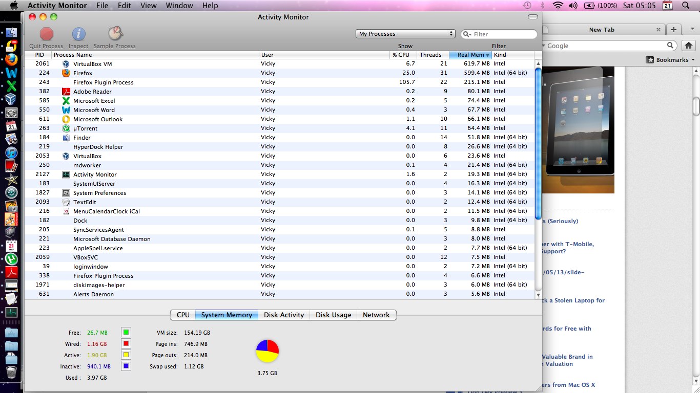

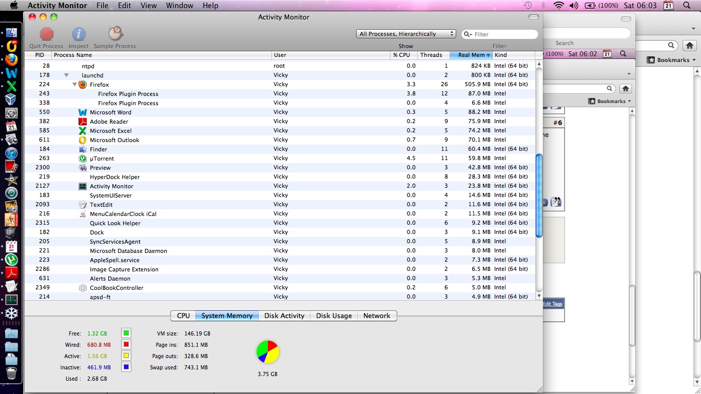

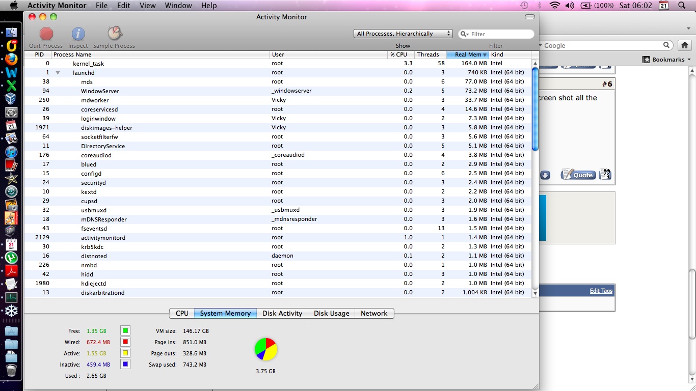

As you requested, but had closed some pages down since the first screenshot.
Hope thats not caused a problem?

All that is not the right diagnosis. Do you happen to have Adobe Reader installed? AdobeResourceSynchronizer process is eating up your CPU like crazy in the Activity Monitor screenshots you provided. See this discussion...
