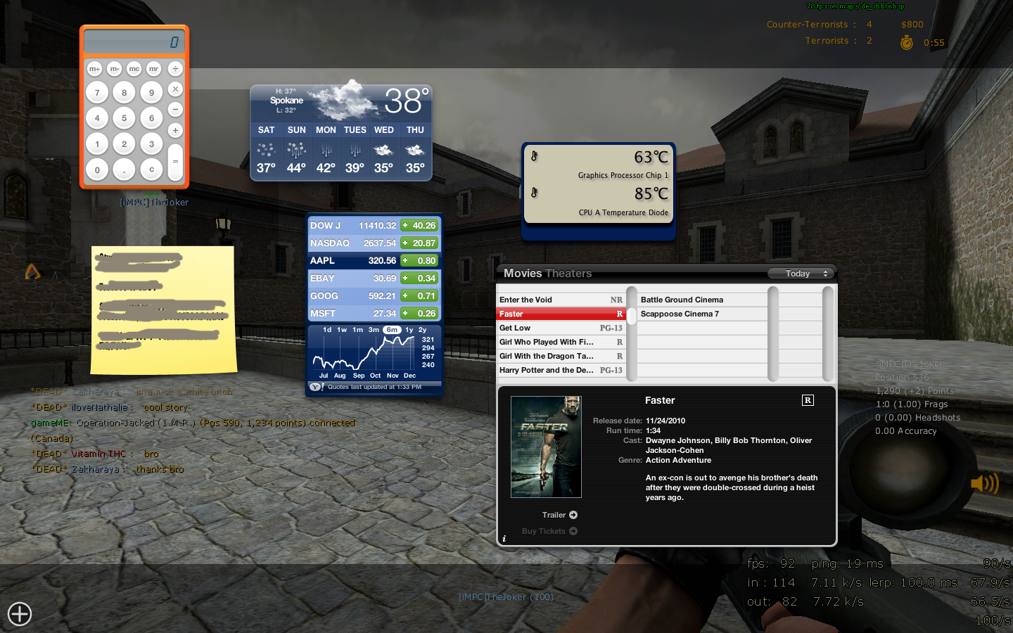

NOTE: DASHBOARD kills the FPS by 30, so while I am running 100+ fps, when I pull up dashboard to show you temps and it drops to 60, that's why.

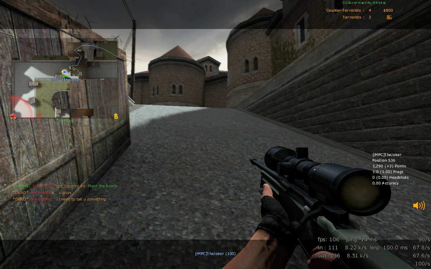

1.) started playing on de_Cbble. Averaging over 100 FPS all the time in all places on the map.
Running native 1440x900 everything maxed with no AA and 4x AF
2.) Temps before anything is happening. Just idle on the desktop

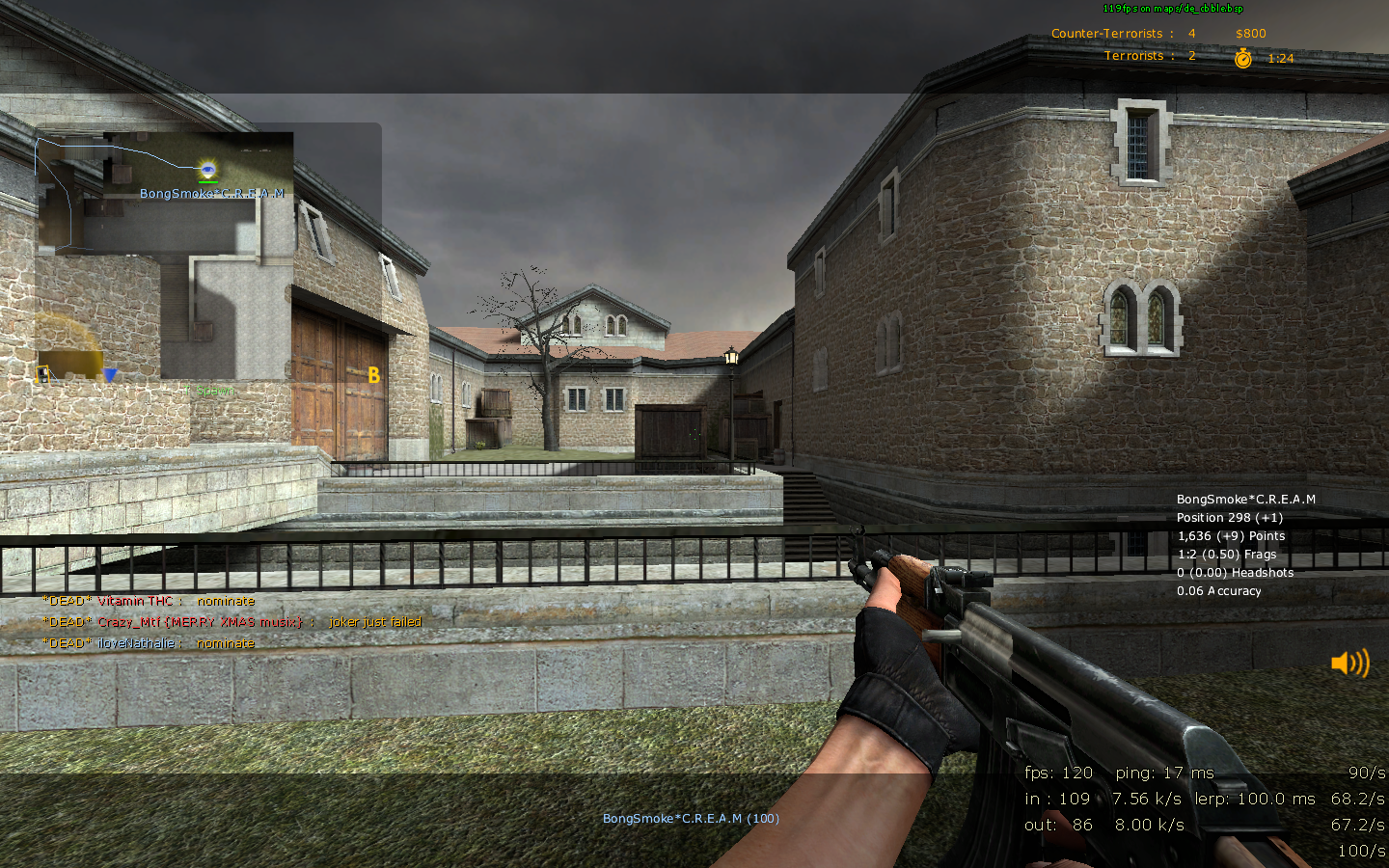

3.)Pics showing you the FPS I'm pulling. It can drop sometimes right as the picture is being taken but it's generally 100+
(Top Right has the FPS)
4.)Temps during the start of gameplay

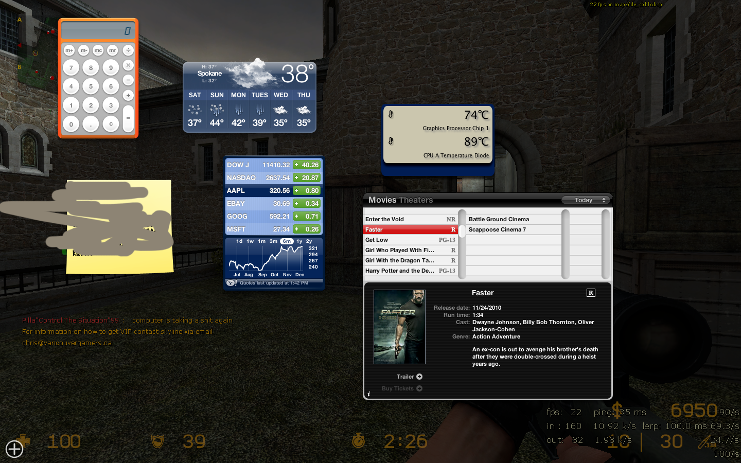

5.) FPS after about 5- 10 minutes.
6.)Temperature after 5-10 minutes
7.)Temps after the drop
8.) FPS after the drop (stays in this range everywhere, 20's - 30's)

Cpu at 102 degrees celsius is a bit excessive i'd say. Mine has never gotten higher that 82. You might have a problem.
hm ill run some more tests on it. After the choke happens the temps stay relatively low. It feels like the GPU just stops trying. Is there a way I can keep like a graph of temps with some program?

Ok well, I figured out what it was, unfortunately, I don't understand why this is happening. I set my fans to medium using iStat menus. I played great for quite a while. Temps stayed in the 80's and 70's.
After getting curious I switched fan control back to default (Osx control) and the fans shut off. 40 seconds later I was down in the 20's for FPS and my temp's were at 100+.
