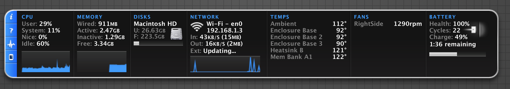

I have a MacBook Pro with Retina Display. 8gb of ram and 2.5 intel core i5 processor. My fan went crazy and its RPM went up to around 6,000 and when i put the computer to sleep (because i got scared) the fan kept going for about 5-10 minutes.
PLEASE HELP!!!!!

Those temperatures are rather cool for a Macbook Pro. Still perfectly safe and nothing to worry about.
Thanks
That is a temperature from a cold boot up and idling. Is it normal for the fan to do that? I also get error messages saying that the computer was restarted due to issues. Is this normal?
It is normal for the fan to do that. The restarting could be caused either by a hardware or software problem. To best determine that, you would have to look at the last kernel panic log or take it to an Apple Store to have it serviced.
Look in Applications > Utilities > Console.app > System Diagnostic Reports. Post the entire contents of the latest kernel panic log, if any exist. You may redact personal information and machine serial numbers before posting it.

How did you get that pic of those stats?

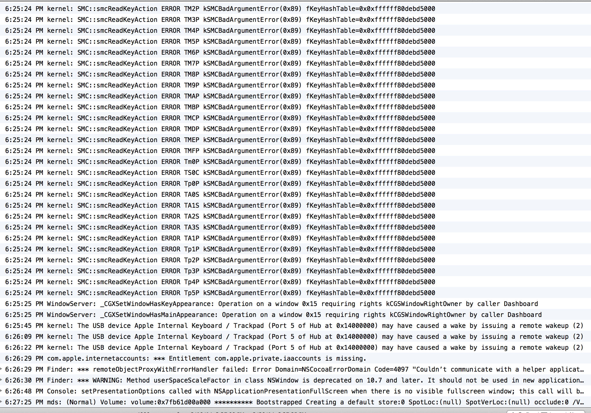

I have no clue what this means
