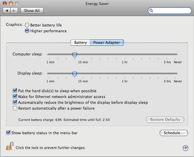

Are you using the integrated graphics card (Better Battery Life) or the dedicated graphics (Higher Performance)?

Thank you a big THANK YOU to the last poster for going through the trouble of posting the pics. As soon as i get back home ill check it out, thank you.
