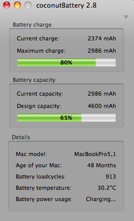

Okay, downloaded coconutbattery, and the image attached is what's come up. Is this good/bad?

Well it is saying that the battery is only capable of holding 65% of its original design capacity. Apple indicate that a battery is designed to last for 1000 cycles so it is pretty much at the end of its life.

Your battery still has some life left in it, but after 4 years and only 65% health, it's getting close to time to replace it.

Okay ill check the battery then, and ohh damn i didnt know that, i couldnt understand coconutbattery well.

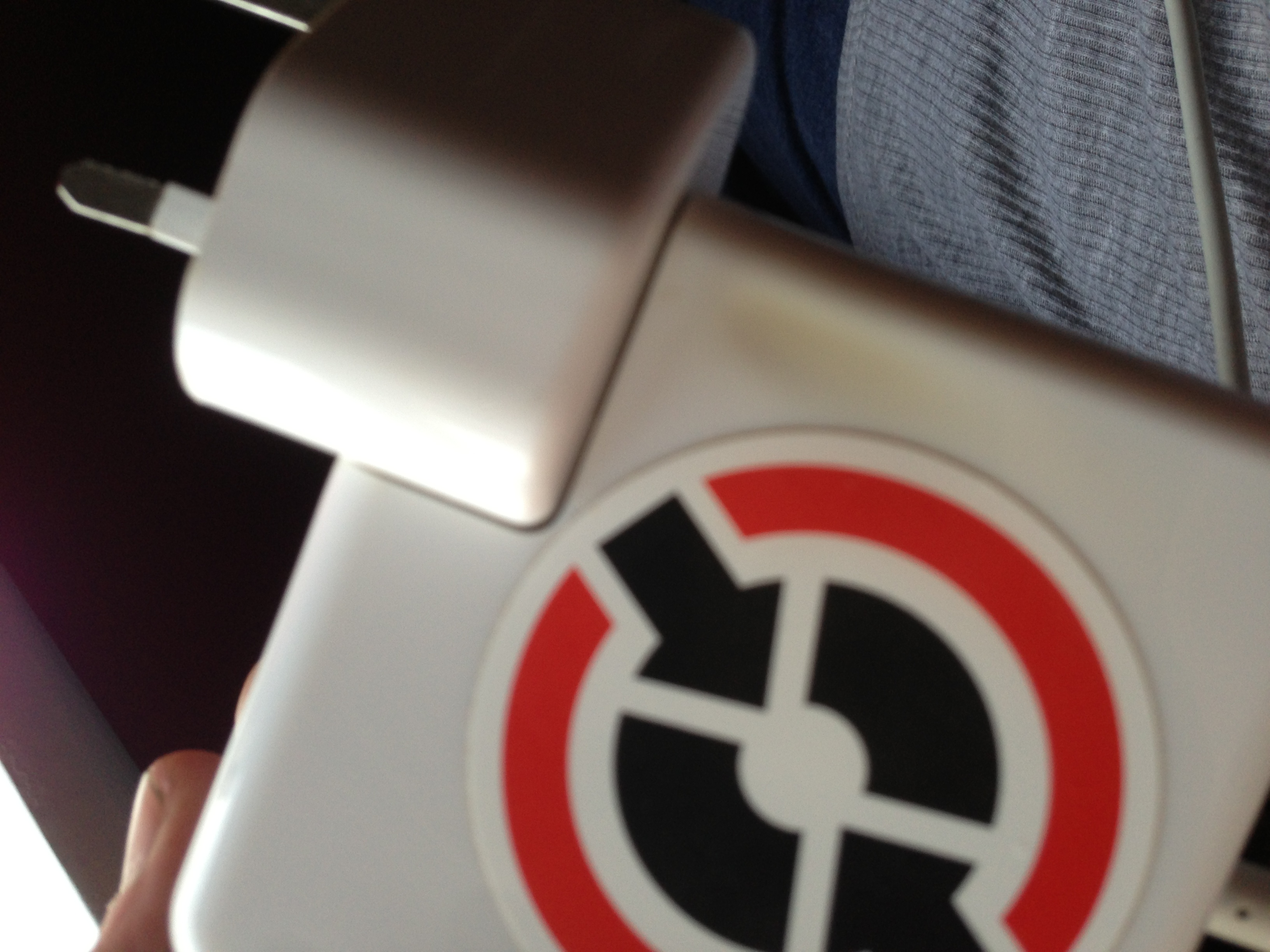

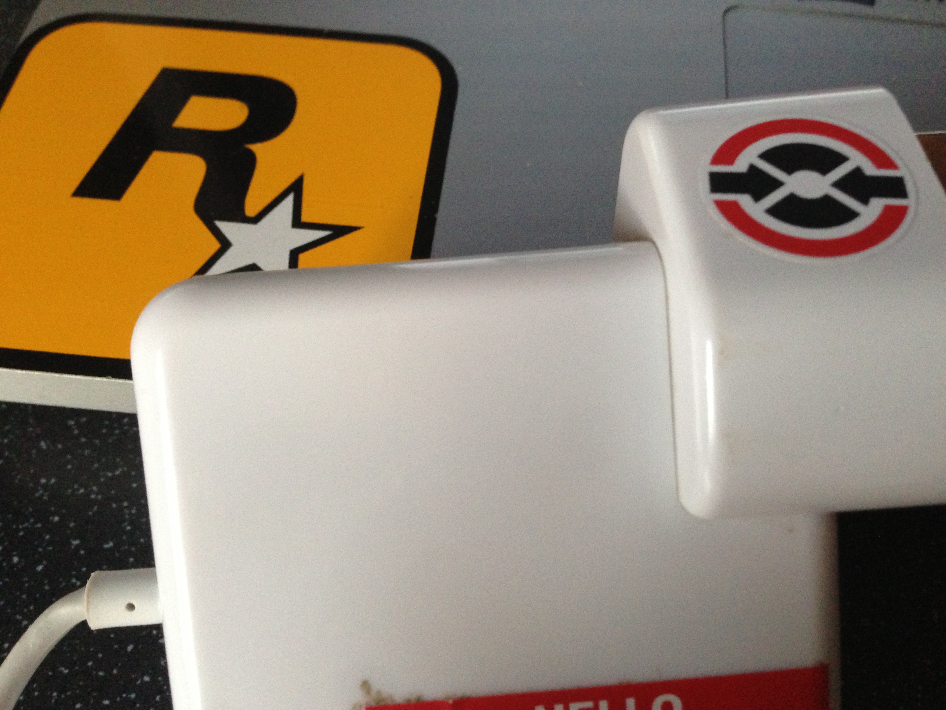

If it helps, recently i just noticed that my macbook charger seems to have some kind of burn mark on it.. which i assume is an electricity shock burn maybe, ive attached two pictures, one of the normal side of the charger and one with the light brown burn mark, when i run my finger over the mark its actually dented as well, so this might be serious, its not a massive mark tho, u can roughly see in the picture, this may have cased some problems? :-(
EDIT: the 1st image (with the yellow sticker on my mac in it, is the okay one, and the 2nd picture, just along where the plug part of the charger is, is the light brown "burn" line.. u can probabaly see it dents in too,)
If it were me, I would try a new charger. That one doesn't look so good.
Yeah I would get a new charger if the charger has got so hot, to cause burn marks and deform the plastic, I would not recommend to continue to use it, as it is a potential fire hazard. If you are getting audio interference when you use it as well, it is a further indication that it is failing.
