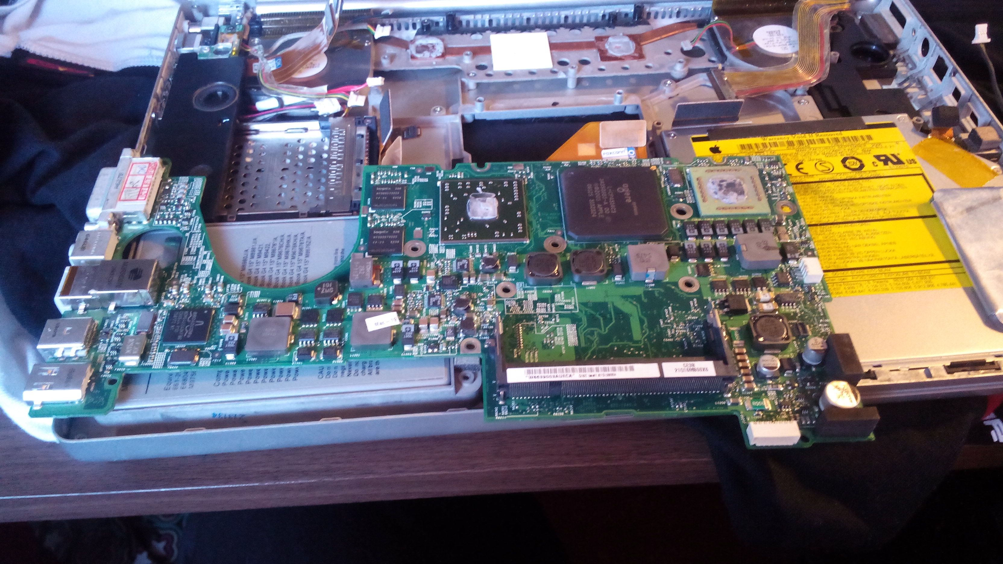

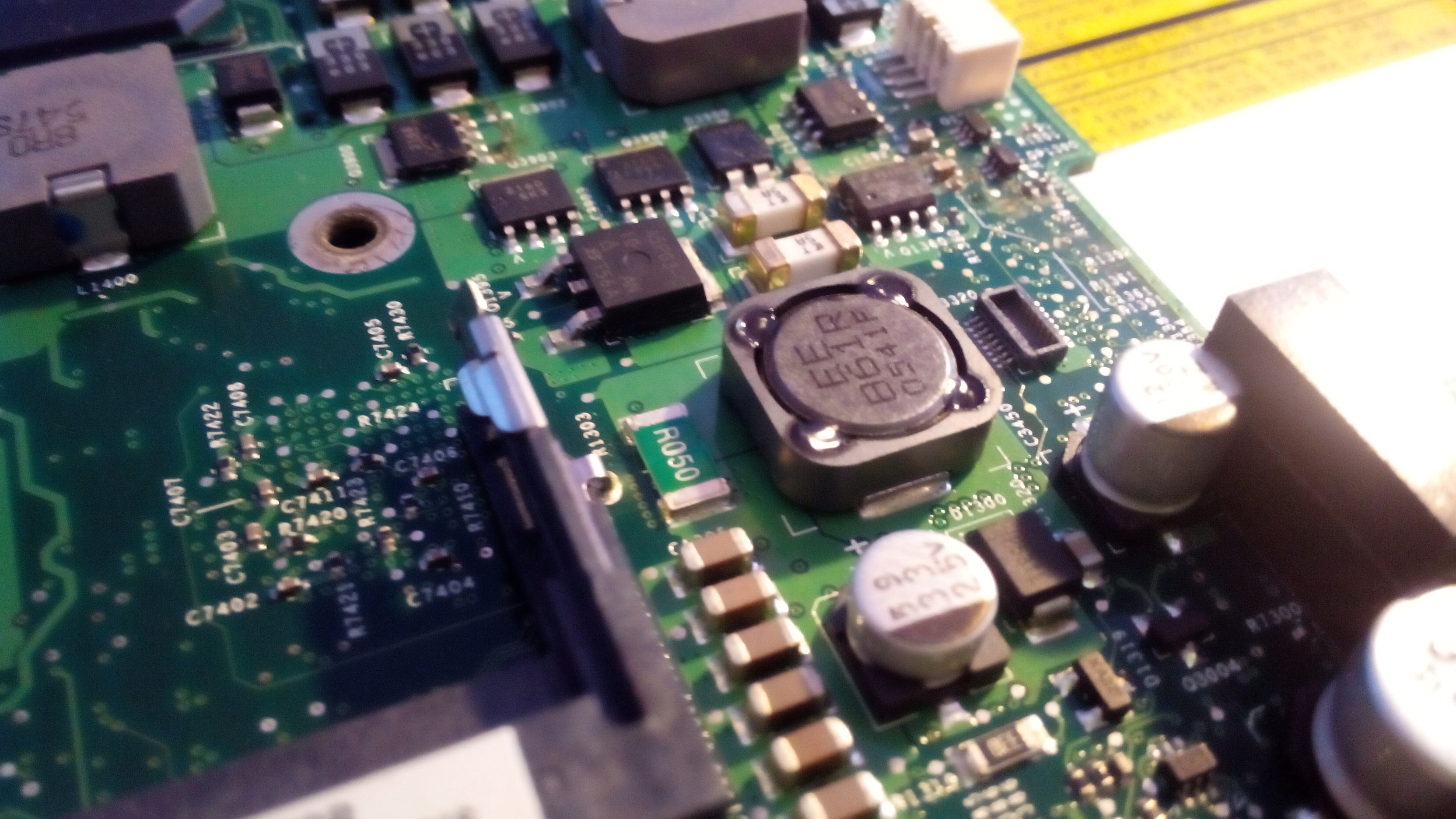

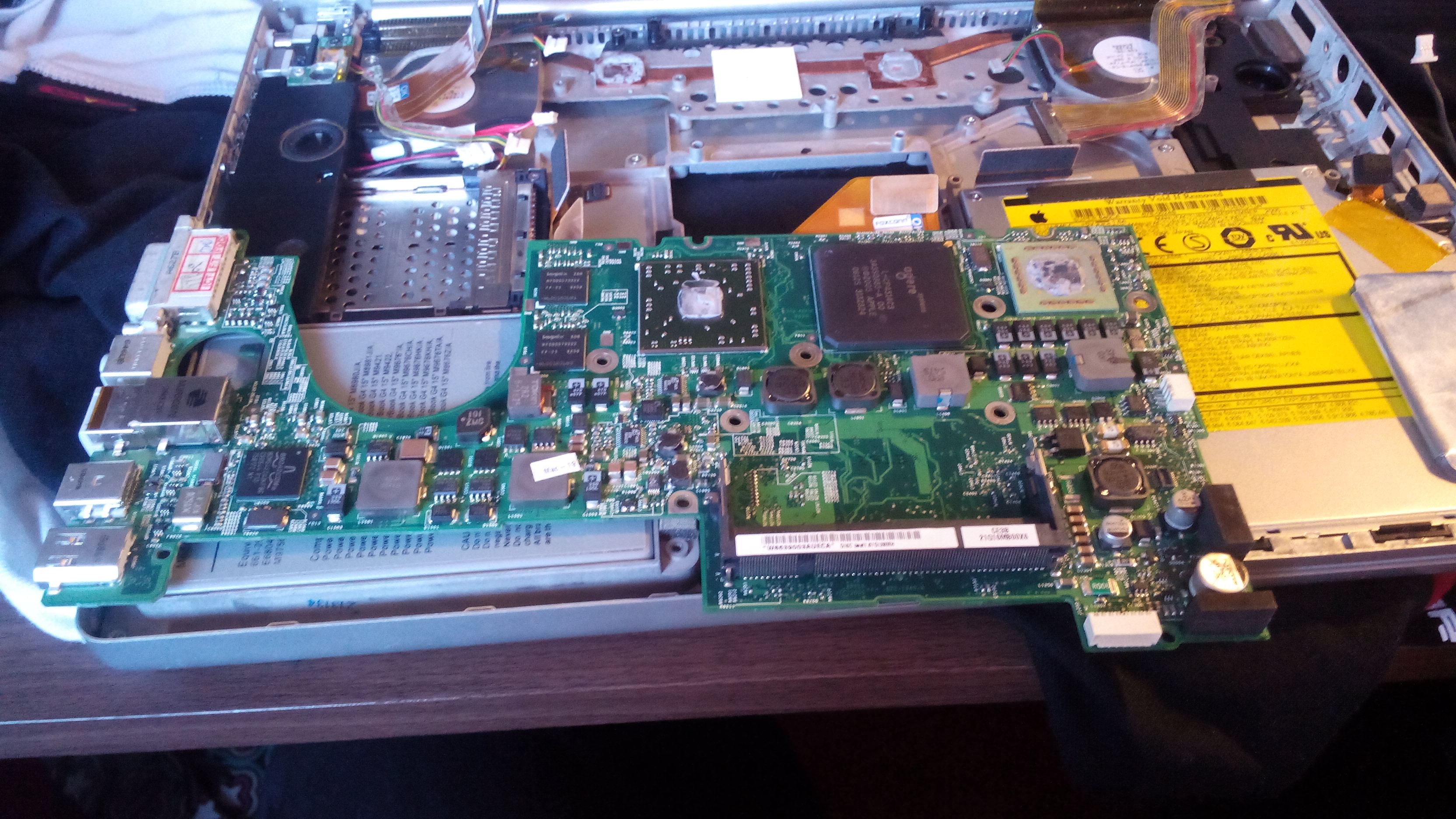

I was packing up the PowerBook ready for eBay photos & decided to have a little look inside just one more time.
I ripped everything out & flipped the logic board upside down (with the red power cable still connected. The underside was where that odd clicking sound was originating from). I pressed the power button with the power adapter plugged in, and there it was, the clicking sound.
Both the noise & smoke began to come from a little chip named 'R050', next to the RAM sockets (see pictures). Every time the board clicked, a little puff of smoke would appear.
Purely out of interest, as AFAIK this PowerBook is beyond saving without a new lobo, what is this chip for & what does it do? I find it incredibly weird that something like that is literally on fire at one point, but then is seemingly not needed when the power cable isn't plugged in? (As I stated a couple of posts back, the laptop worked fine on the battery alone).

The R050 is a capacitor.
If you're not going to try and sell this PB for anything more than parts, and you're adept with a soldering iron you could try and replace it if you can find a part, though because its a surface mount it will be very very difficult. But if you've got nothing to lose, give it a shot.
EDIT: It is a resistor, not a capacitor. My bad!
Well, it's not all that difficult. Though it's a surface mount capacitor, it's relatively big. I'm pretty sure that if you know someone with the proper tools or if you have them yourself, the logic board is definitely salvageable.
Thanks for the replies guys. This is looking a little more promising now. I'm pretty nifty with a soldering iron but have never come across one of these little guys before.
I found this link to a resistor, not a capacitor as stated (and is the same image as the bmehilos posted; http://uk.farnell.com/susumu/prl1632-r050-f-t5/resistor-current-sense-0-05-ohm/dp/1268782
There's no I'm paying £15 delivery on a pin sized object worth 30p. And there's currently none on eBay at the moment, but if I know that I can get it up & running then it may be worth holding on to it until one pops up.
Yes, it's a resistor indeed. Not sure about what have caused it to fail though. However, if you have a ohmmeter/multimeter, try to check its resistance, which should be 0.05 Ohms (50 mOhms) just to make sure it's broken.
Simply soldering a new resistor will not solve the issue. Something caused the resistor to smoke. If the underlying issue isn't fixed, a new one will also smoke.
What if it was caused by overheating or any other external issue? Then it should be fixed with a replacement.
