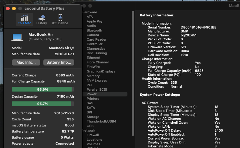

As you can see, mine is a bit worn, but is still decent. I had a replacement battery on my original Air from iFixit and it worked very well. That one got destroyed when I dumped liquid on it a couple years ago. This replacement Air I bought is in pic above with its original battery. That's the built in System Report on the right with Coconut on left.
It's been a while since I've paid attention to how long I can get out of a charge as I don't use it off AC often for extended periods of time. I should do that and see. 95% capacity isn't bad for this age.
I'm sorry.. The stats I gave was for my model. I keep forgetting you have a newer one. So.. just in case you care, I just got 3 hrs watching movies on mine and I'm at 50%, so about 6 hours is what I'll end up getting. Here's your model specs
