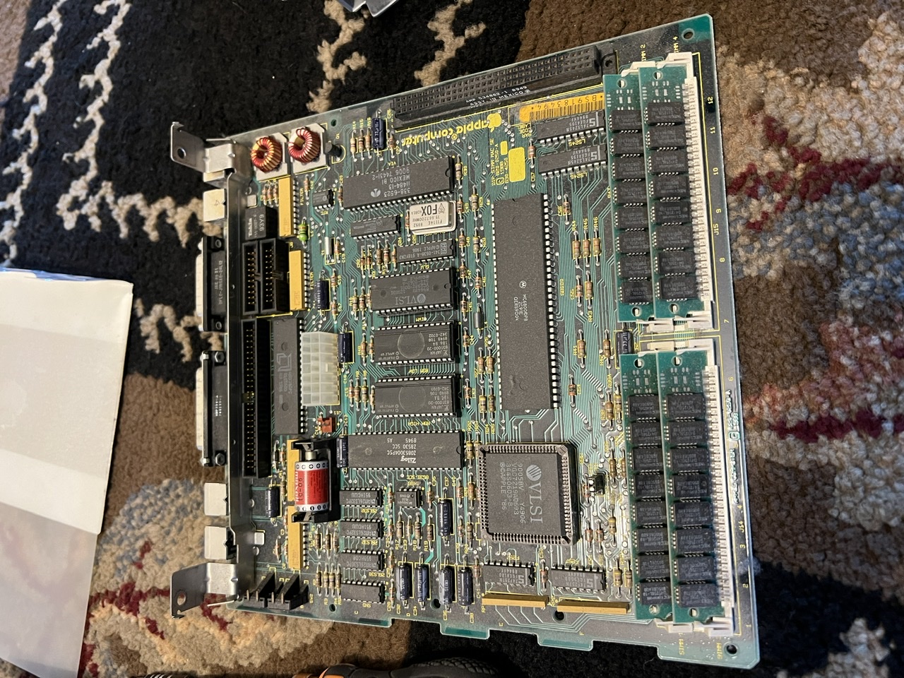

Hi, I recently bought this Mac SE with the intent of it being one of the last SE's introduced, with what I understand is the ability to write 1.4mb high density disks. I have an earlier SE with an 800k drive that I've restored, but I'm tired of using 800k disks as I don't have a bridge Mac at the moment.
However, upon receiving this and cleaning the floppy drive, it won't recognize 1.4mb disks properly. I was under the assumption that unless it said 800k floppy on the back of the machine, it was a later model capable of writing and reading high density floppies. Mine just says "SE" on the back and front.

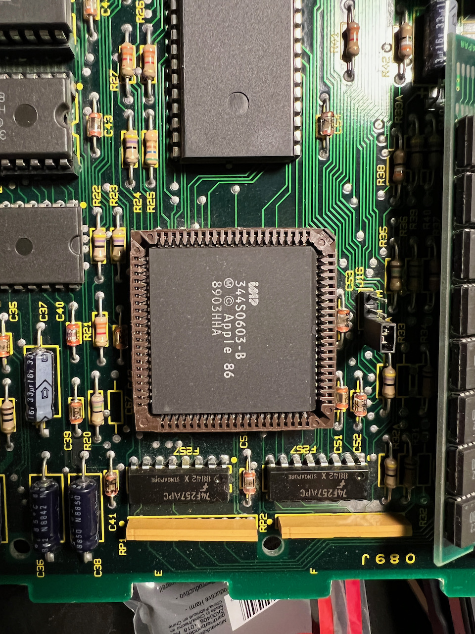

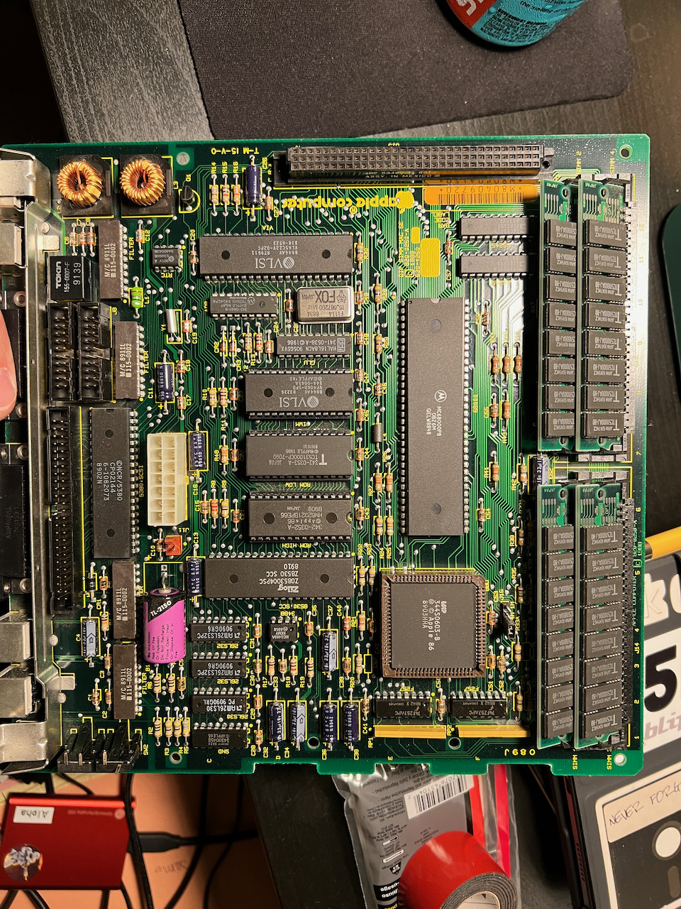

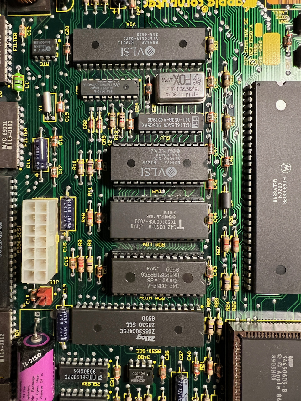

Here are shots of the motherboard internally, I know you need a special rom and a SWIM to write 1.4mb disks.
Sadly, no.
Your ROM and IWM are SE 800k setup
Original (800K FD) ICs are:
342-0352-A HI ROM
342-0353-A LO ROM
344-0043-A IWM
Upgraded (1.44MB FD):
342-0701 HI ROM
342-0702 LO ROM
344-0062-01 SWM
So obviously, you should be wondering if the Floppy drive itself is 800K.
800K drive should be marked as F-51W(-xx)
1.44MB drive should be marked as MP-F75W(-XXX)
The logic board seems to be mid to late March 1989. The original MacSE (800K) was sold until August 1989, when the SE FDHD was introduced. So it seems it fits into the 800K "era".
Yes, there were upgrade kits available (for a fee) to be installed by an 'Apple Authorized Service Center', for all 4 parts (drive, 2x ROMs & IWM)
The SE FDHD was terminated in October 1990.
What is the machine's Serial number on the rear left ?

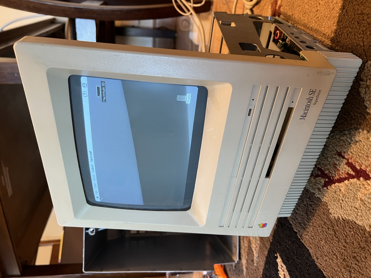

Anyways, I got an ACTUAL SE SuperDrive off eBay, it arrived yesterday. After verifying the ROM and SWIM, it looks to be a real 1.4MB capable machine! Yay!

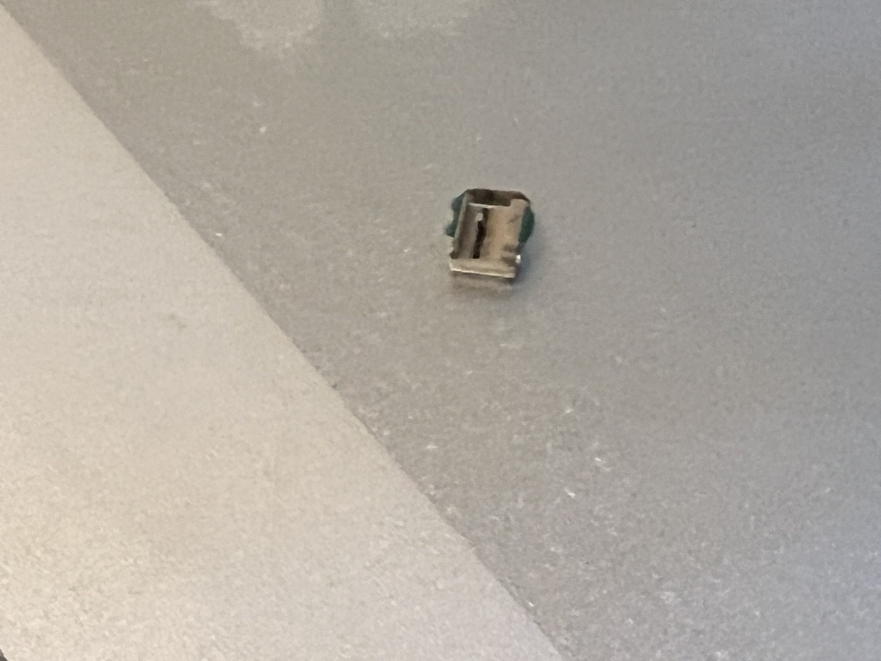

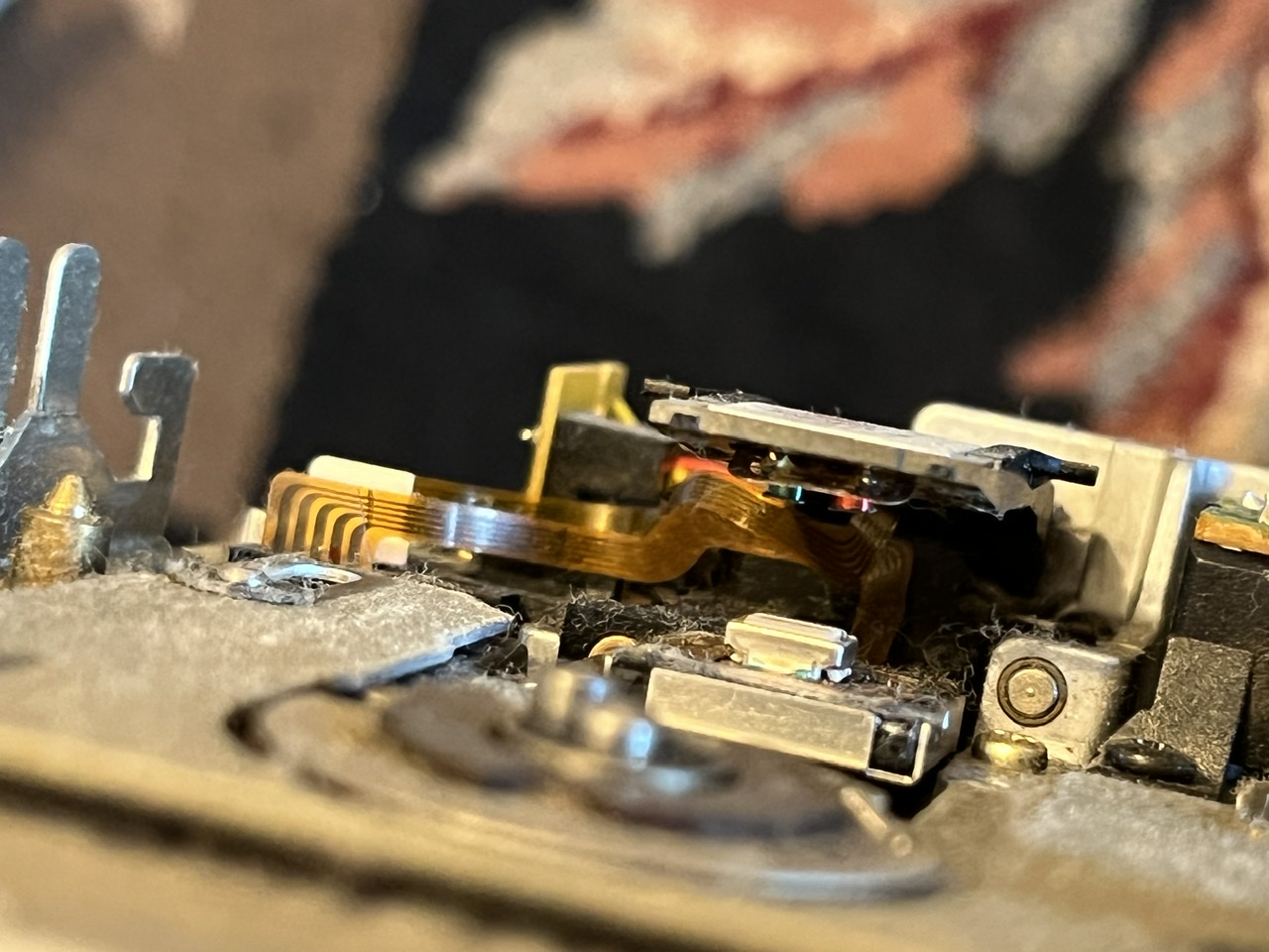

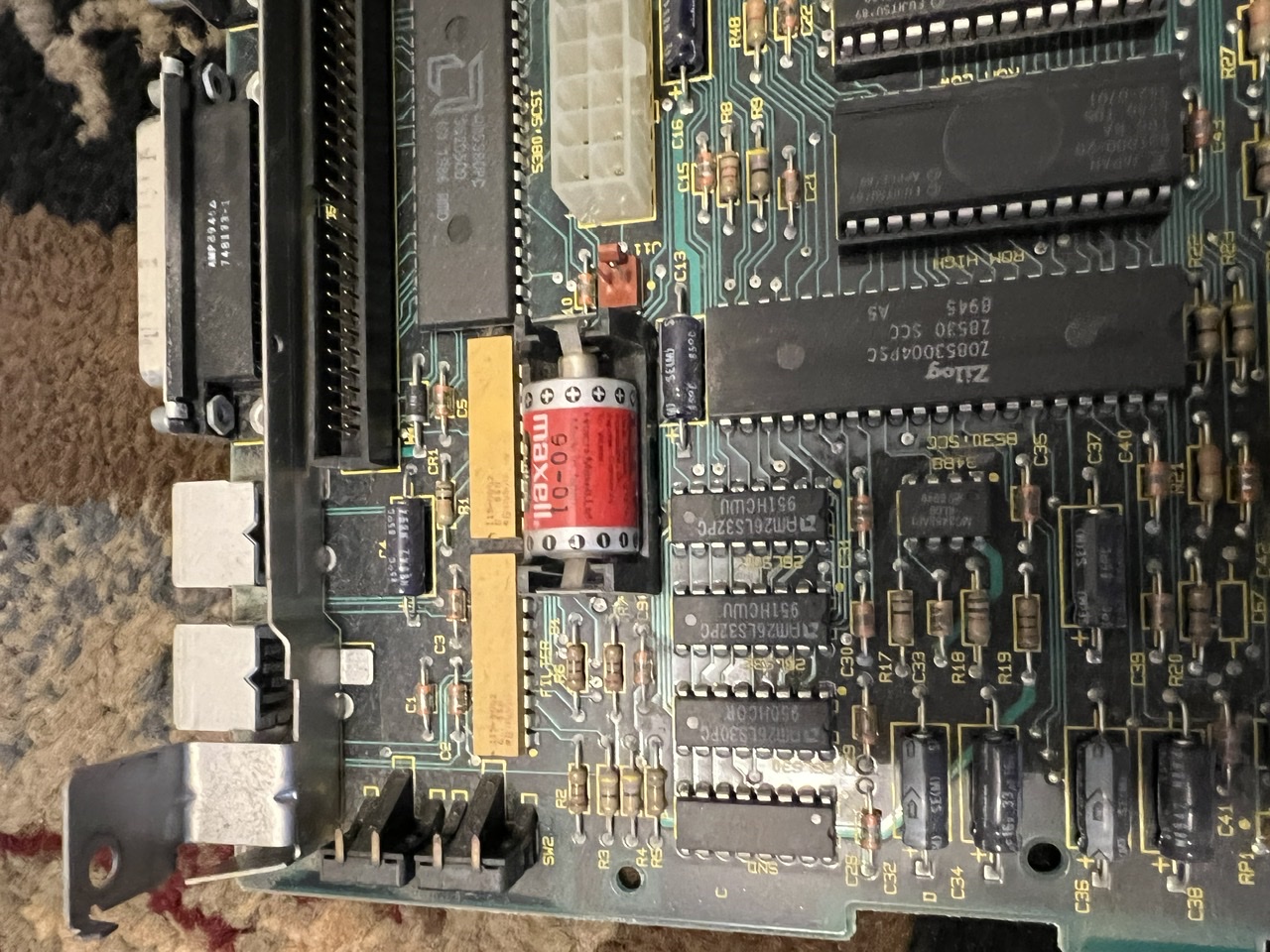

Problem is, when I opened the floppy drive to clean it, the top head fell right off the arm! Whomp whomp. Now I need to find a replacement 1.44mb Sony drive, and people want $$$ for them now. I’m gonna recap it in the meantime to get it ready.
It also had a maxell bomb waiting to go off. Replaced that with an EBC.

Damage to the top head is a common fault. The head itself is somewhat free to move and is easily snagged if a floppy is forcibly removed from a drive whose eject mechanism is stuck mid-transit. Worse still, if a floppy is inserted into a drive whose eject mechanism is stuck mid-transit, the floppy will most likely break the top head off.
