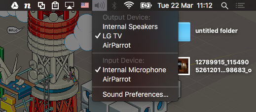

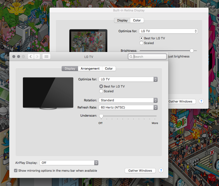

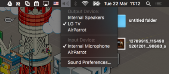

b) My Mac does detect my office TV (this is why I bought the cable - office presentations & meetings) but there is no signal to the TV.
I can change the Resolution, refresh rate and even select the TV's speakers to play music but no signal gets to the TV. (check the screenshots - OS X detects it but the TV displays "no signal")

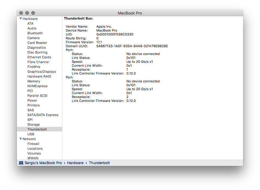

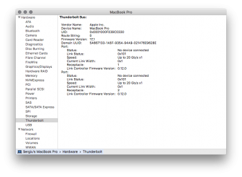

1. Under System Report both Thunderbolt port are shown and I guess this is a good thing.

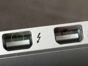

I think I found the problem.
Look at this picture I took right now - is it just me or is that little thing there bent or smth ?
EDIT : Now that I know some keywords more detailed than "thunderbolt not working", I google'd my problem and found only one dude with this issue (he posted on multiple forums)
This dude has the same issue as me (dislocated metal plate).
He fixed it and got it working. Check out his post and look at his pics :
http://apple.stackexchange.com/questions/158137/dislocated-metal-plate-in-thunderbolt-port

The second TB port definitely has something bent at the top, as per your pic.
As I see it, you have two choices:
1. Take it to an Apple-authorized service center for repair, where the tech will probably just take a small flat-blade screwdriver and bend it back up, or...
2. Do that yourself. Just be gentle about it.
Let us know how it goes...

Is it safe to use a metal screwdriver in a port ? Ofc the computer will be shut down.
