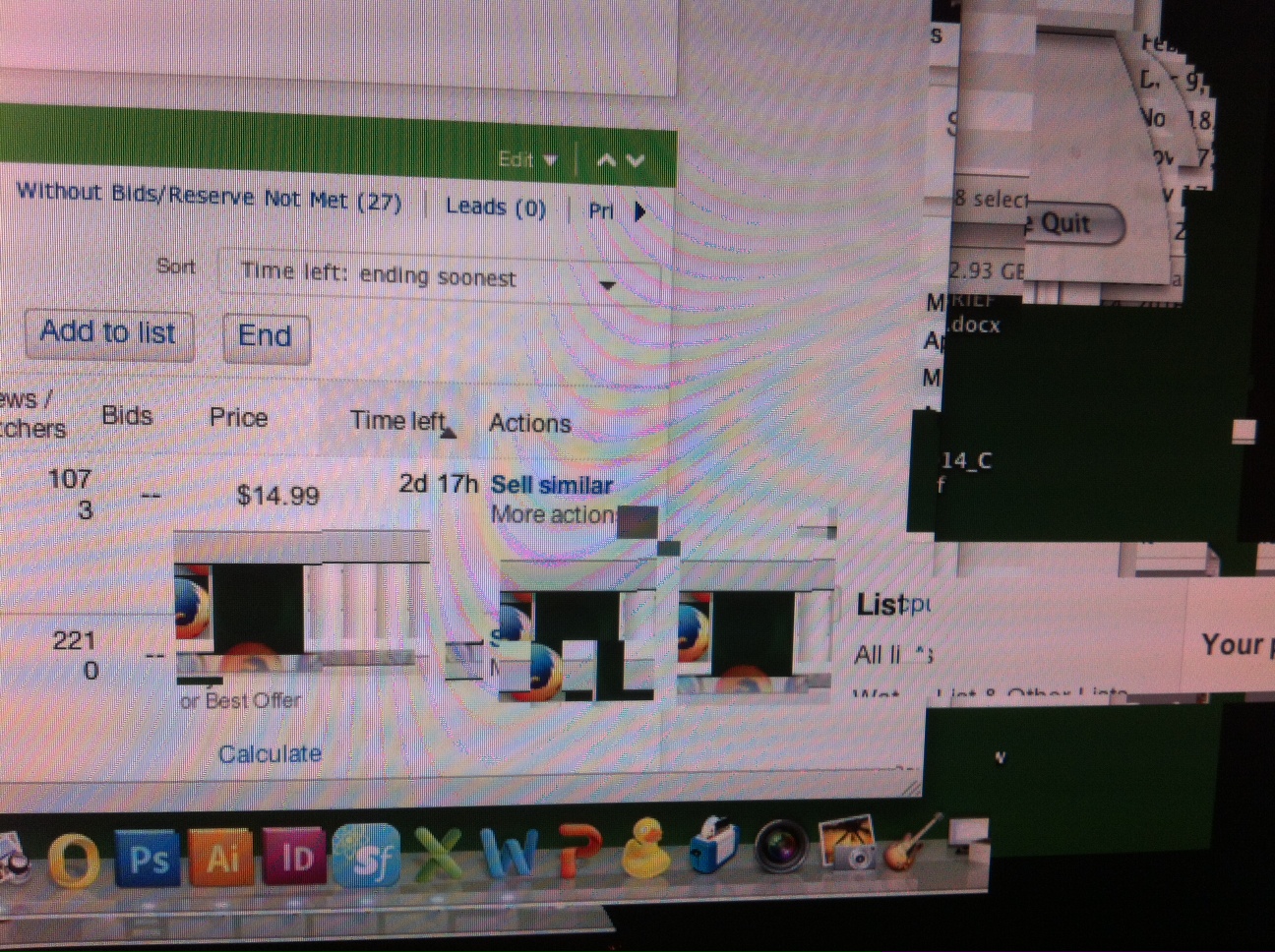

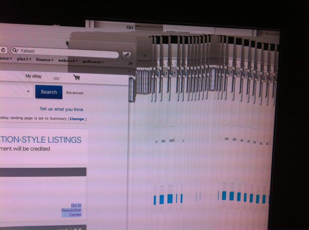

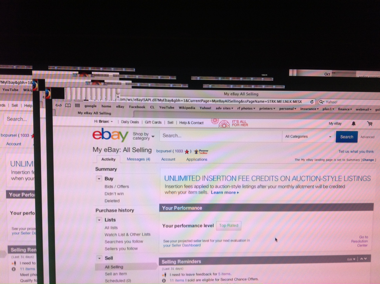

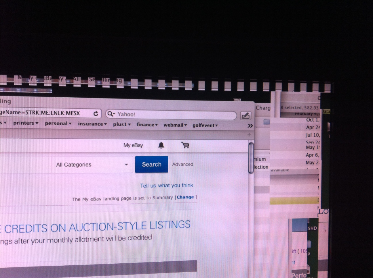

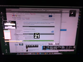

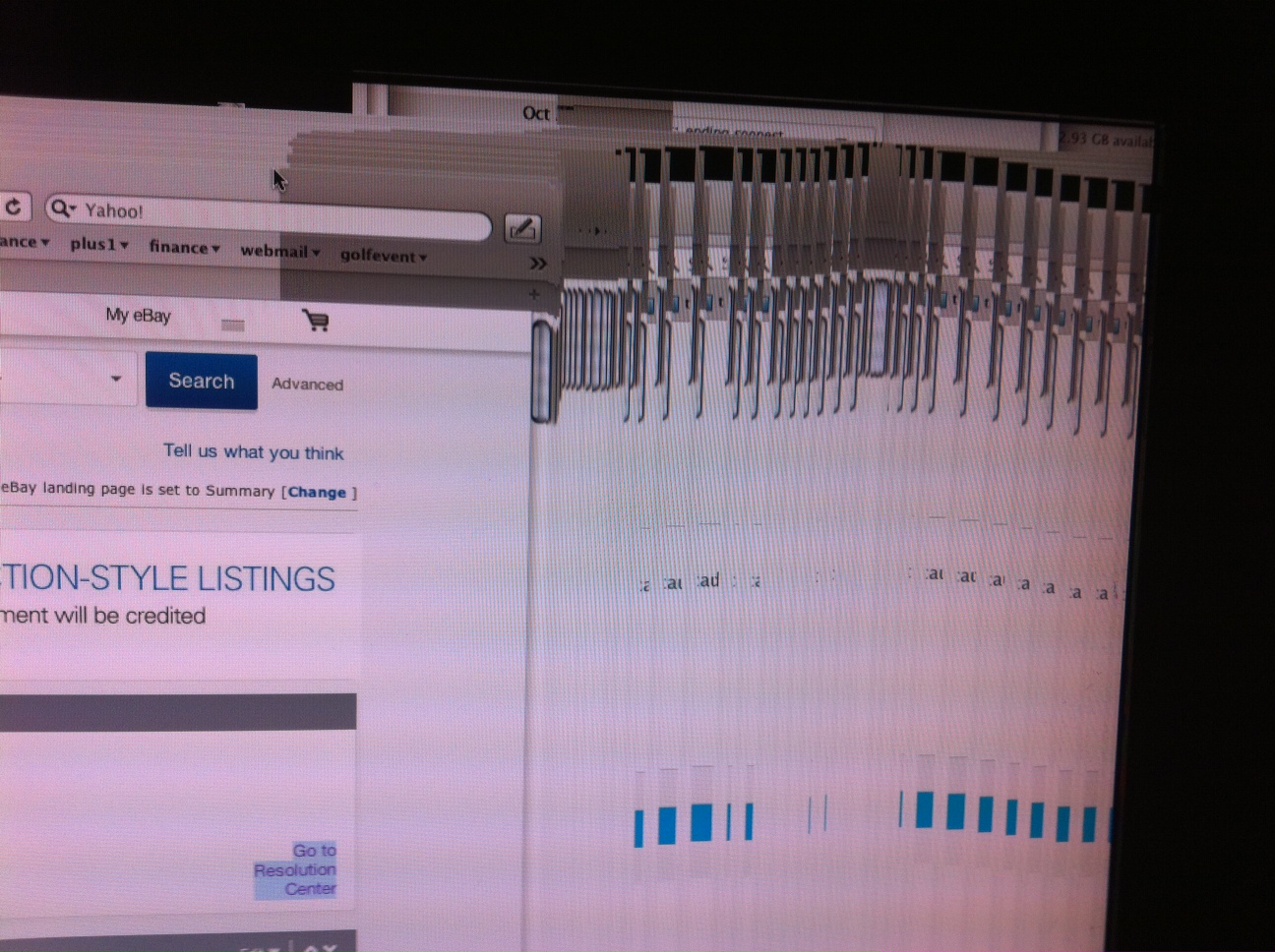

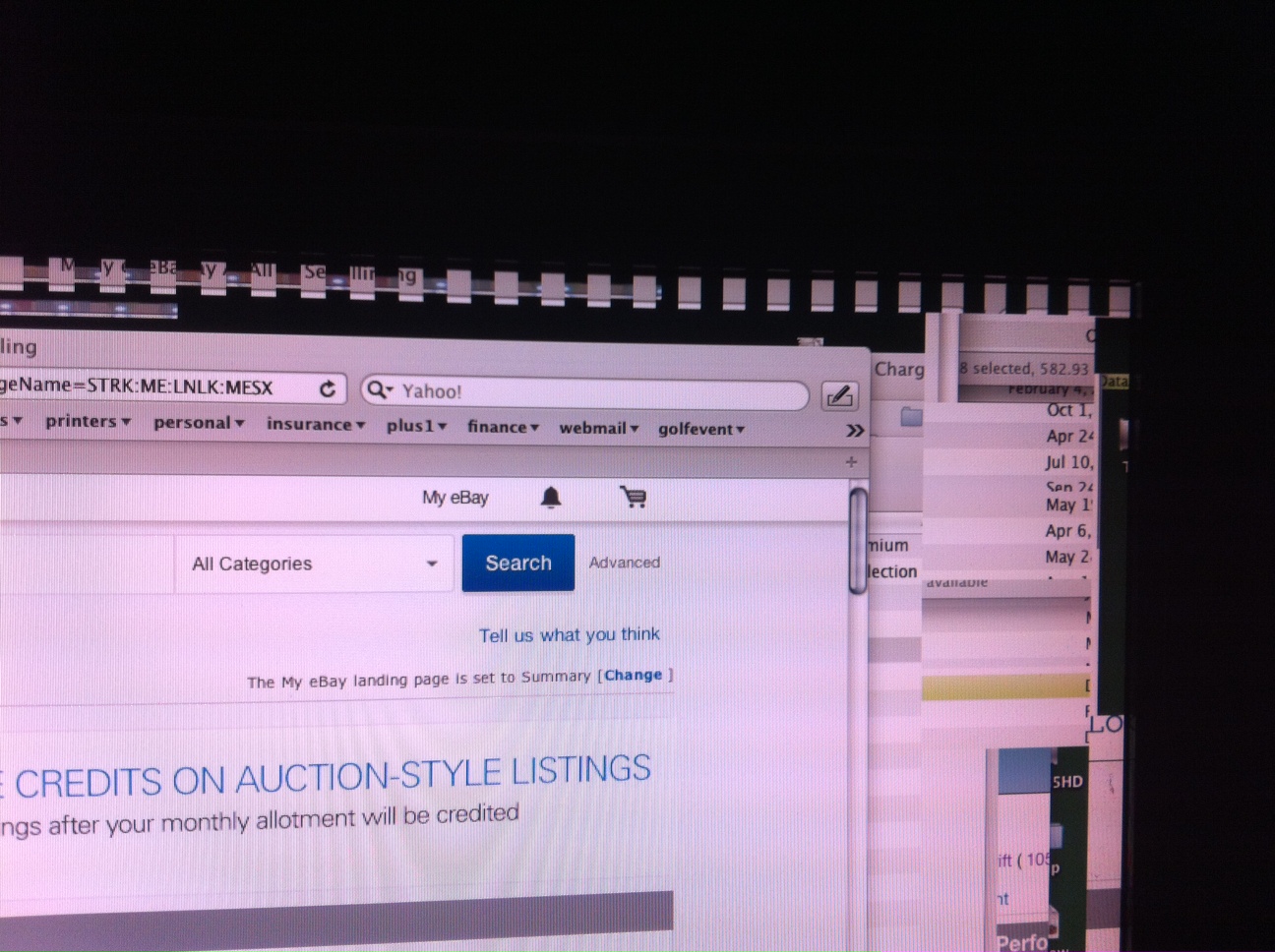

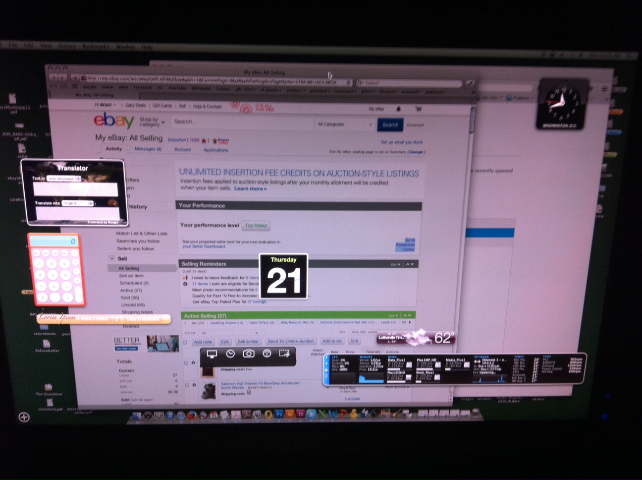

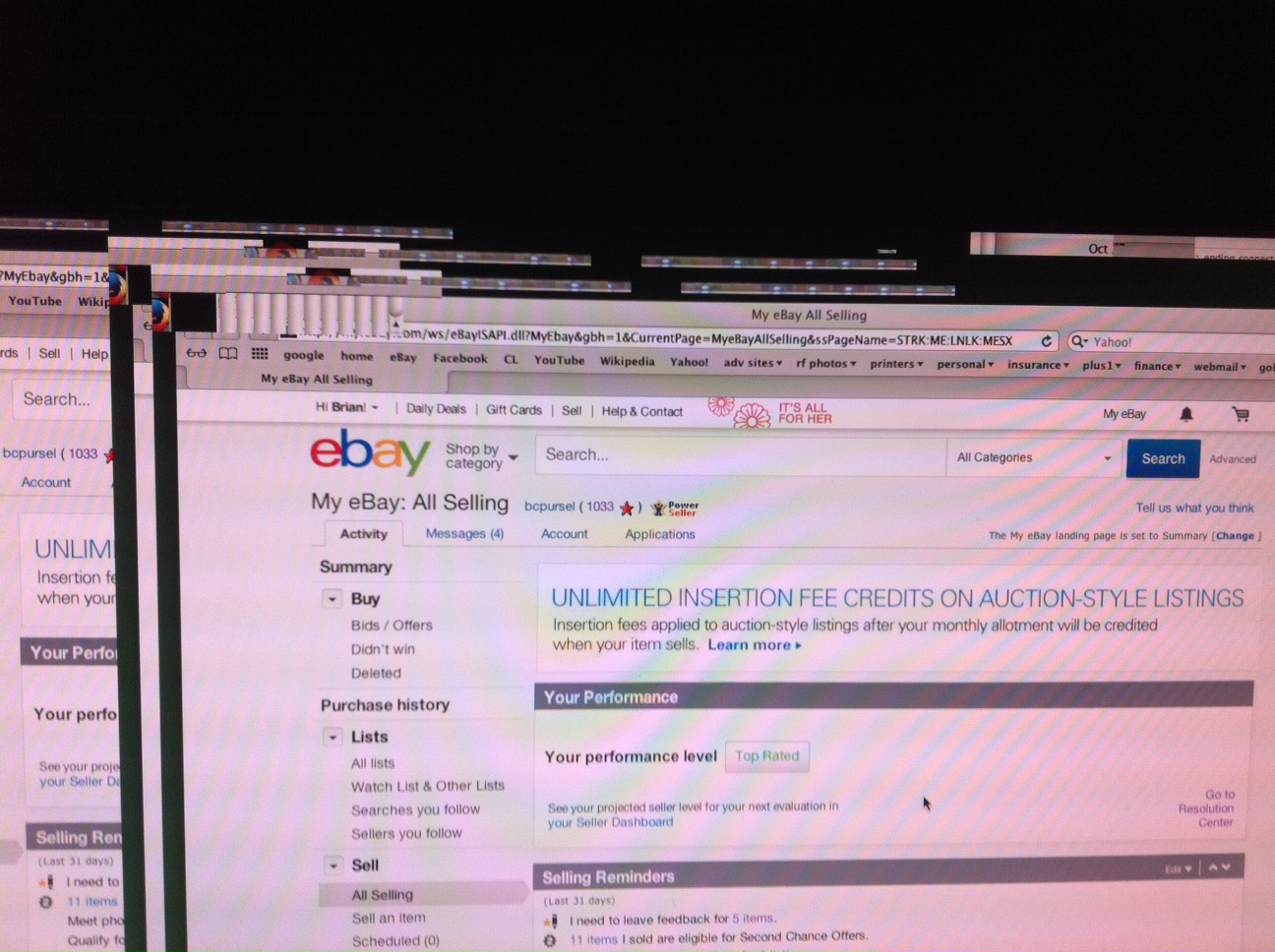

ok. i had another screen incident this evening. was just browsing firefox on ebay after the machine was idle for a few hours. here are some photos. starts as the striped banding at the top and pieces of windows randomly repeated everywhere. when i am able to grab a window, it leaves the repeated trail that looks like 100 pages stacked as it moves. then, magically if i push my mouse wheel to dim to expose with the widgets, all that disappears to reveal what actually was open. once it cleared i was able to restart, and everything appears back to ok for now. thoughts?
is there a way to fix/repair vram or basically just replace the geforce gt 120 with another? is vram related only to my gpu or the logic board of the computer?
I think buy another card is cheaper, even though we can narrow down to suspect the GPU, we still can't 100% which part(s) of the GPU cause the problem.
Anyway, if you have anything can setup for screen sharing. You may do that to check if the corruption only exist on the monitor, but not on the remote screen.
When it happen, you can also make a screen capture "CMD + SHIFT +3" to check if the corruption also exist on the screenshot.
Or even remove the GPU, and check if the corruption appear on the remote screen. If not, then it's quite clear GPU cause the problem.
if the screen shot capture shows the same corruption, what would that mean? same for if it shows on the screen shot? what would corruption only viewed on the monitor mean?
i assume if the corruption is only on the monitor, (not the screen shot) that would point to the problem definitely being isolated to the gpu and not logic board or ram.
