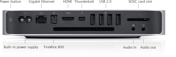

The 2011 should have had HDMI:
But you might have been using MiniDisplayPort/Thunderbolt instead.
Unless you used a Firewire to VDA adapter?
I would get whatever your monitor uses to HDMI adapter. Sounds like you're a couple generations behind here 😉
