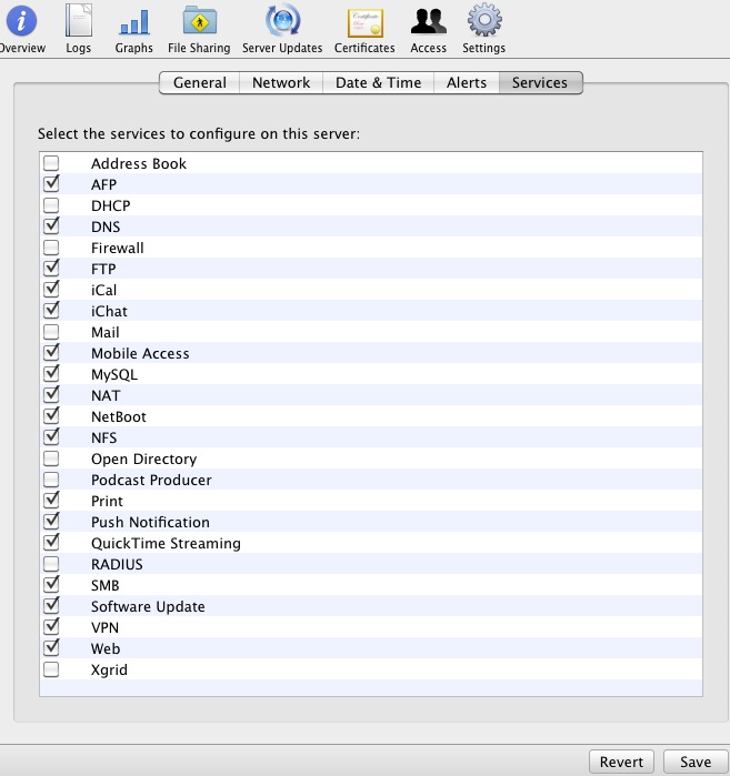

Les is correct. When you install OS X Server you can (and probably should) skip everything that it asks you to, and select configure later. Then you can go back and configure just what you want. On the Mini with OS X Server Open Directory is probably pre-configured so that's why it's there. A re-install should fix that (be sure to create a good tested backup drive first because OS X Server is kind of fussy and it's easy to end up with a non-bootable system).
Just go to Server Admin and turn off everything but SMB and AFP. Don't need SMB if you have no PC's.
Then go to Workgroup Manager and add users. Set up folders in SHARED ITEMS at the Root level, make groups, add users to groups then add ACL's for the groups to the folders you set up giving them full control.
I'm serious when I say this will take about 10 minutes.
