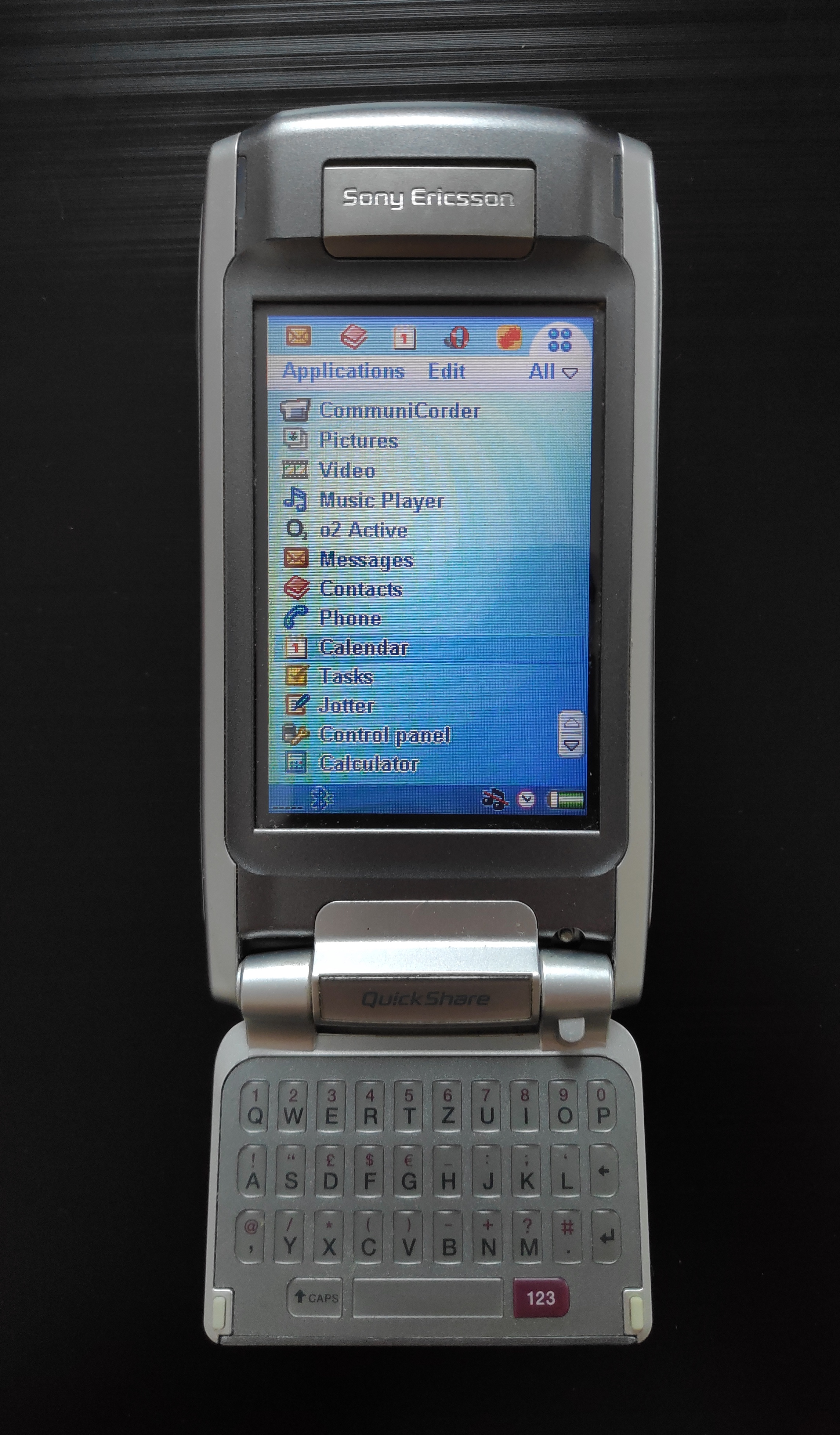

I remember my Sony Ericsson P910i which had a capacitive screen so needed a screen saver but came with a stylus and was great to use and that was back in , great handwriting recognition and I used that for loads of things and nope it never broke when I dropped it and that was probably the first kind of smartphone I ever had back in 2004. All the older phones i had before were plastic and survived and nobody cared about 'premium' people just wanted durable and useful. Also you could still change your battery yourself, but my god was the camera awful.
