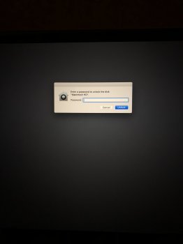

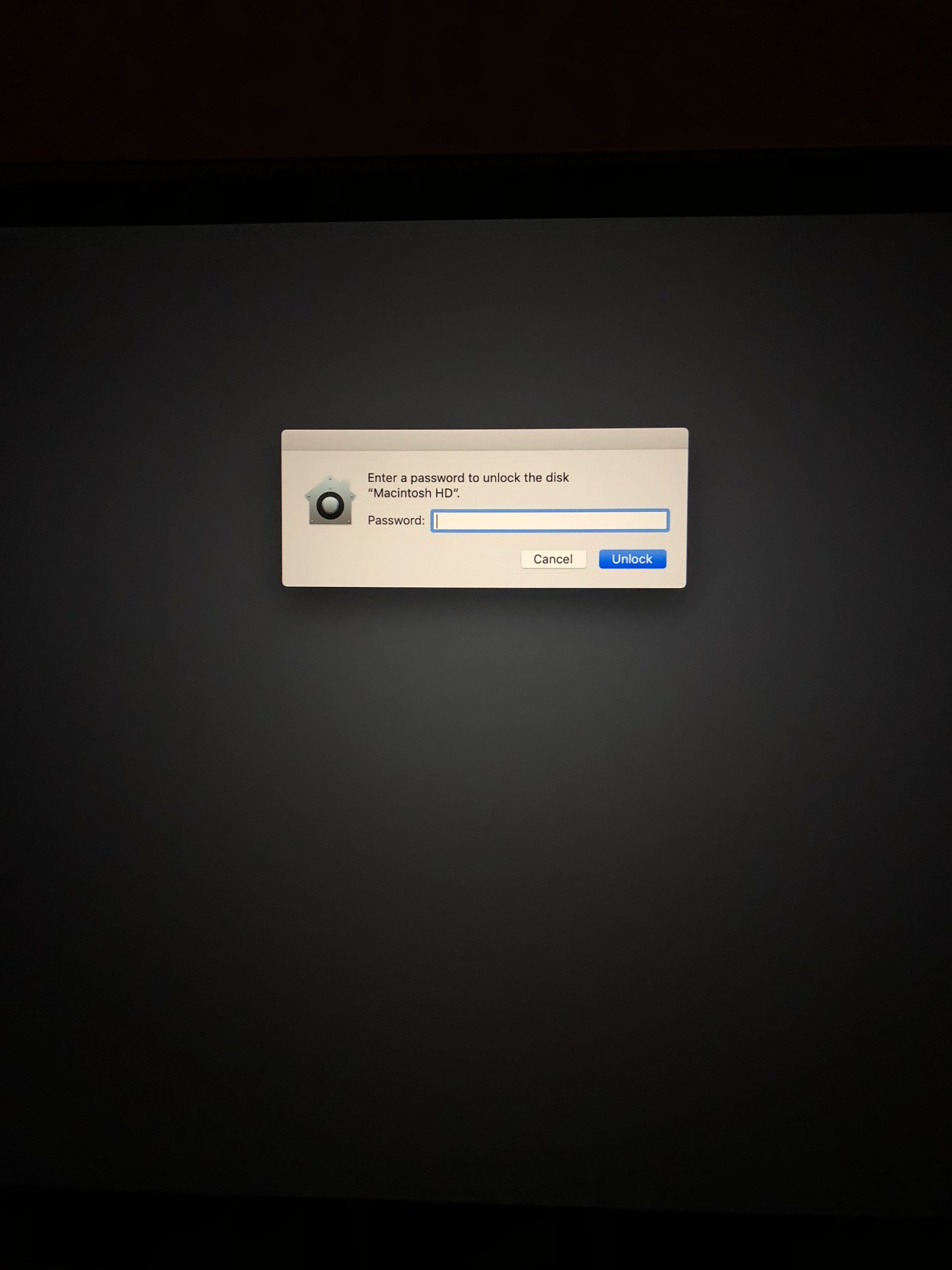

Well now I'm having a totally weird issue...I'm back in HS trying to install supplemental update 2 and whenever it restarts to install the update it takes me to a screen to choose my boot drive....and then I log in and nothing has happened and I have to try and reinstall it all over again. Any suggestions?!
[doublepost=1535498310][/doublepost]I get this on startup now
Looking at the Error display: With T2 Bridge drives are always encrypted. If they are not in FileVault mode, the first Admin password is stored somewhere, but might have gotten lost in your wipes. You will also likely find that you cannot get into the Startup Security Utility, because this token is lost.
Before doing anything else, boot and log into your admin account, if you can still do that. Then run this exactly in terminal:
sysadminctl interactive -secureTokenOn YourUserName -password -
This will reestablish the token.

Thanks for the advice, but this didn't do anything I'm afraid. I'll see what the Genius Bar says on Saturday.... maybe reinstalling stock HS would fix things (as opposed to going from a Time Machine backup), but then I'd lose all of my files and settings...
