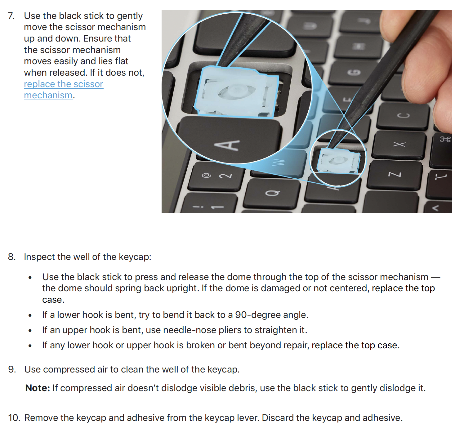

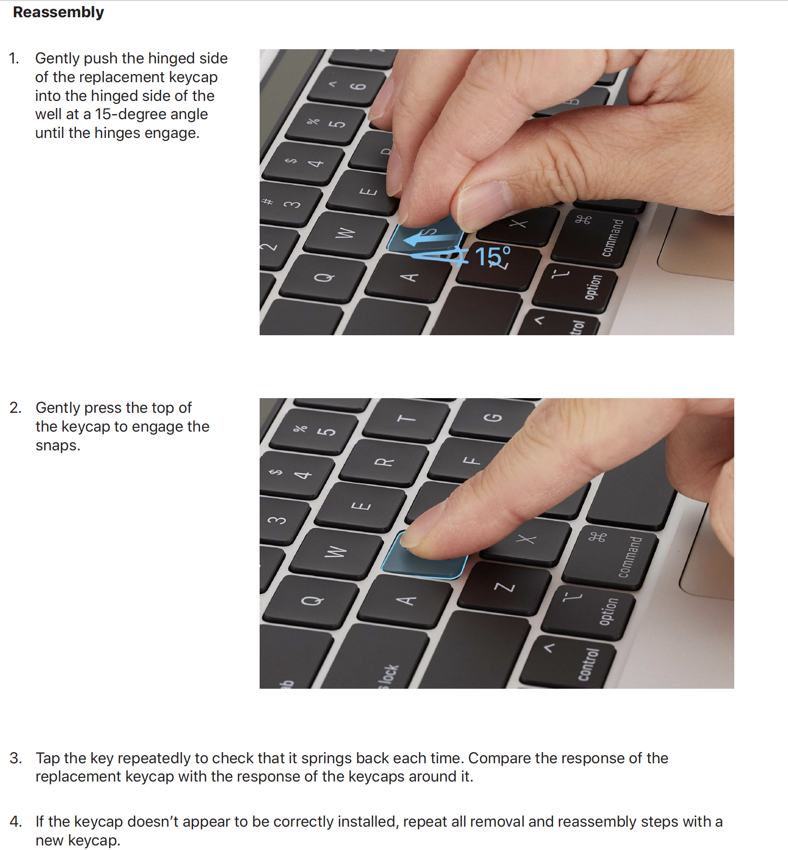

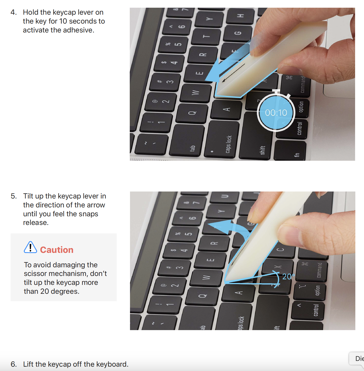

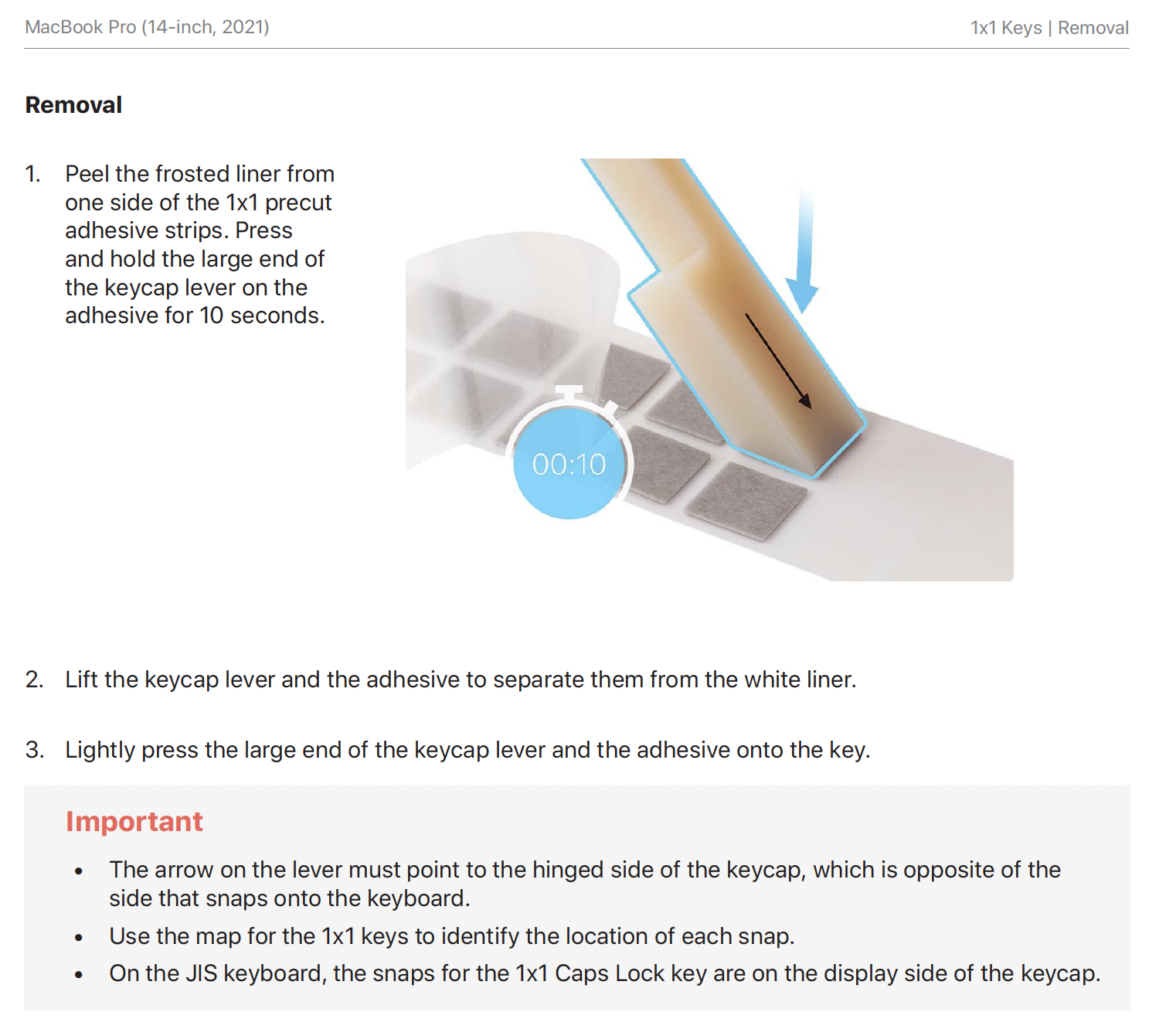

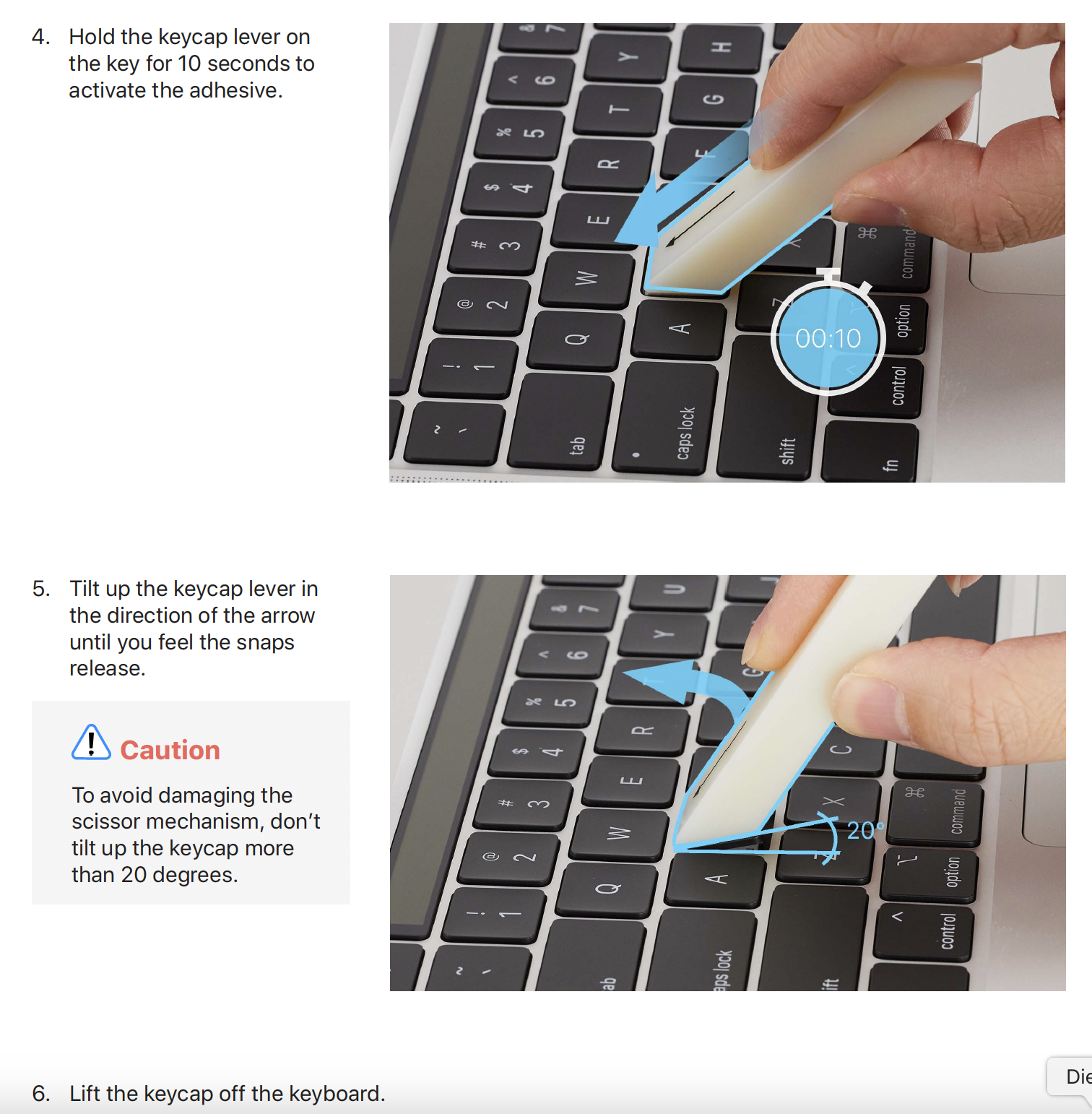

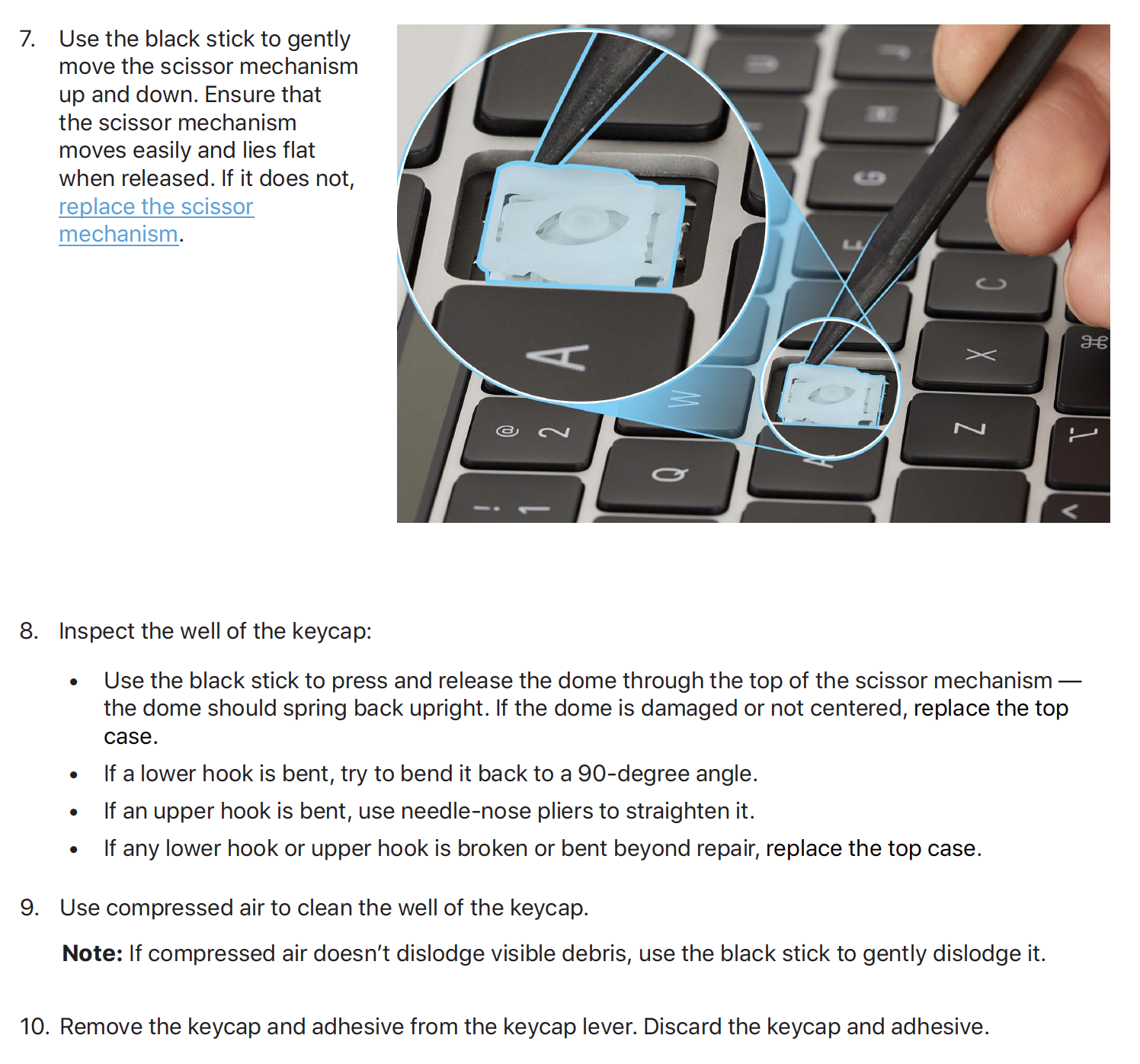

Apple has published online repairs manuals, but I just checked them and they are missing some information.
I'm attaching below the missing parts.

Is replacing some of the individual keys on a MacBook Pro difficult to do?
Based on my experience replacing keys on earlier models, one thing you want to avoid is in any way damaging the tiny silicone dome at the center of the mechanism while replacing the cap. Unlike the cap and scissors mechanism, there's no graceful way to repair or replace a dome.
(Cf. the third bullet point under the section captioned Important in Apple's instructions: "If the dome is damaged or not centered, replace the top case".)
