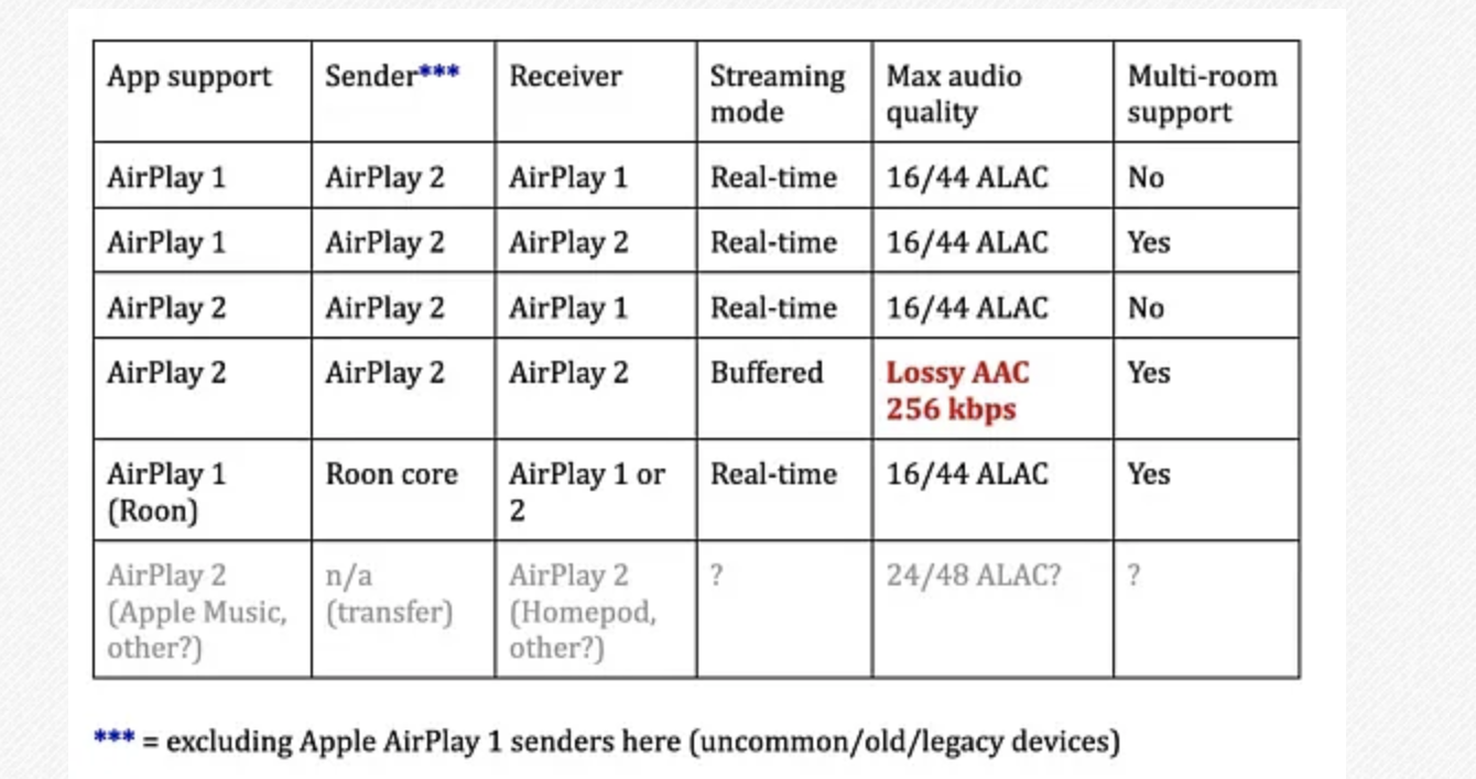

You need to define "lossless". Airplay doesn't support greater than CD quality.
As for CD quality "lossless" - it is complicated.

I had no idea. Oddly enough my iTunes through a DAC which is then connected to my Denon doesn't sound as good as playing through Airplay. Do you folks think Airplay 2 could get software upgrades in the future to support Hi-res lossless or this is likely to be in Airplay 3 which will also require a new receiver?
While anything is possible, my guess is probably not on lossless upgrade to Airplay 2. Lossless basically begs for a wired connection. A hypothetical Airplay 3 could bring it but I've not seen one rumor for Airplay 3.
