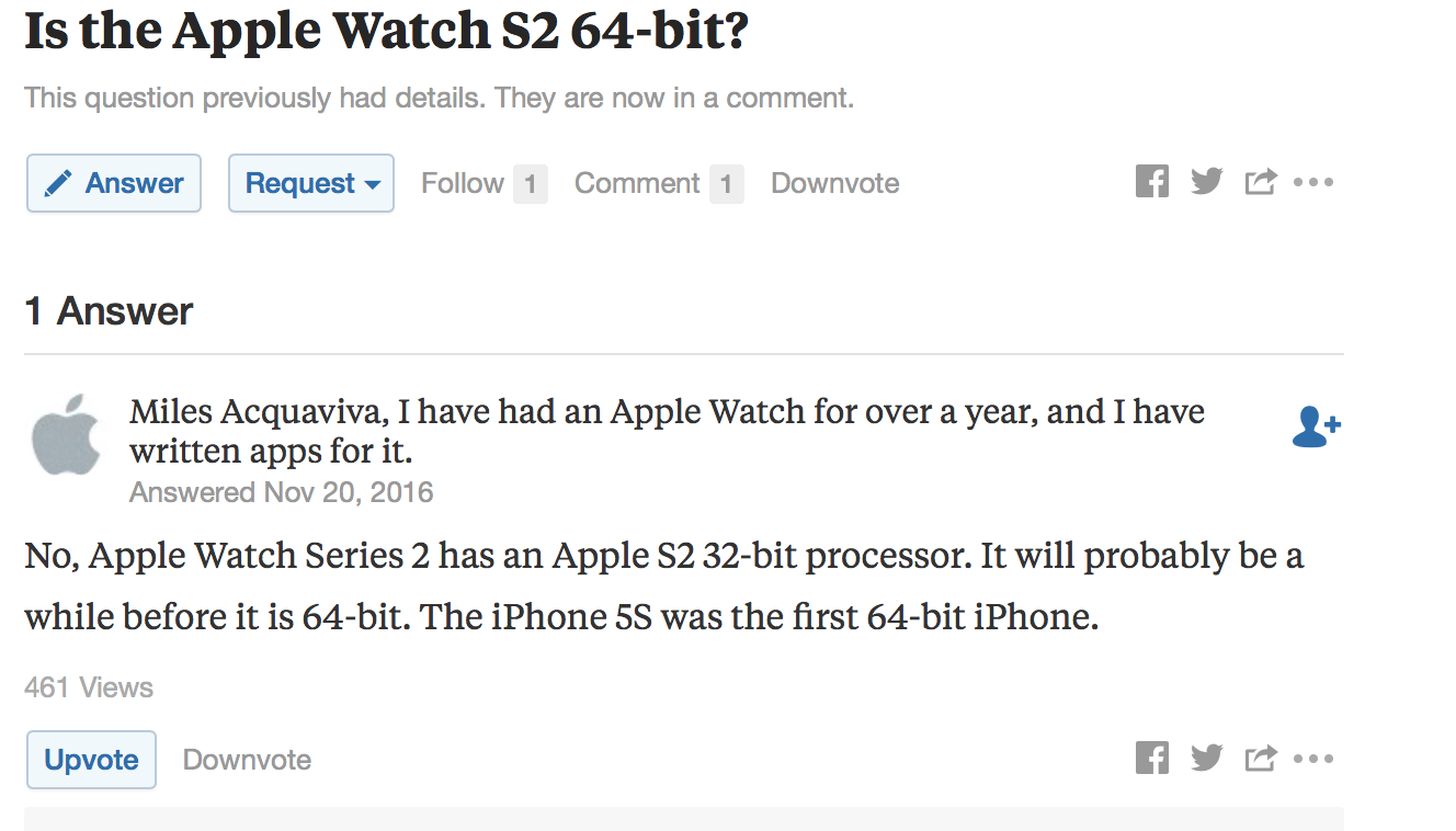

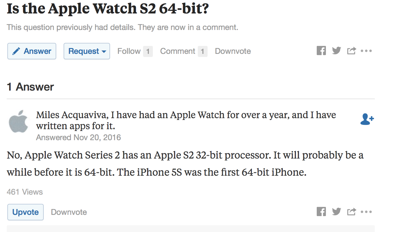

series 2 is 64 bit
do you have a link or how do you know?

series 2 is 64 bit
from Quora

I’m not sure Apple has said. One group that opens up the chips is Chipworks, but it doesn't look like they’ve finished their S2 tear down, let alone the S3. Or maybe they destroyed the S2 and found it too difficult to analyze. You can see their S2 info here: http://www.chipworks.com/ja/node/414 . (The S2 and S3 are custom Apple packages that contain the primary CPU, so unless Apple tells us or someone can analyze the silicon, we're not likely to know.)
Sorry this is so late but I just ran a test project to check for myself. It is indeed 32 bit. It returned 4 when printing sizeof(void *) which means the memory address space is 4 bytes long which is equal to 32 bits.
