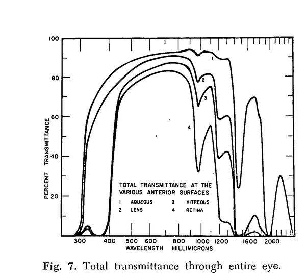

so here you have a chart of transmittance for the human eye:
First, in general, watt for watt, UV is generally worse (almost fully absorpted by vitreous and retina in the eye) than visible and visible is worse than infrared.
You can see that there is a large amount of absorption in the near and infrared band. This makes e.g. the lens susceptible to cataract damage. Historically glas work blowers are affected by this due to the fact that some glasses will radiate a lot of energy in this band when heated.
