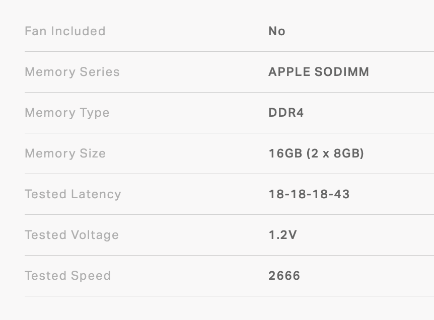

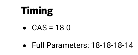

2) OWC's RAM for the 19-20 iMacs is CL18. I called OWC Tech Support, and they say that's what the Apple OEM RAM is as well:
So what's going on? What is the latency of stock Apple RAM on 19-20 iMacs, and why do most aftermarket RAM vendors recommend CL19, even though OWC says it's CL18 (and thus spec'd out its own RAM to be CL18 as well)?

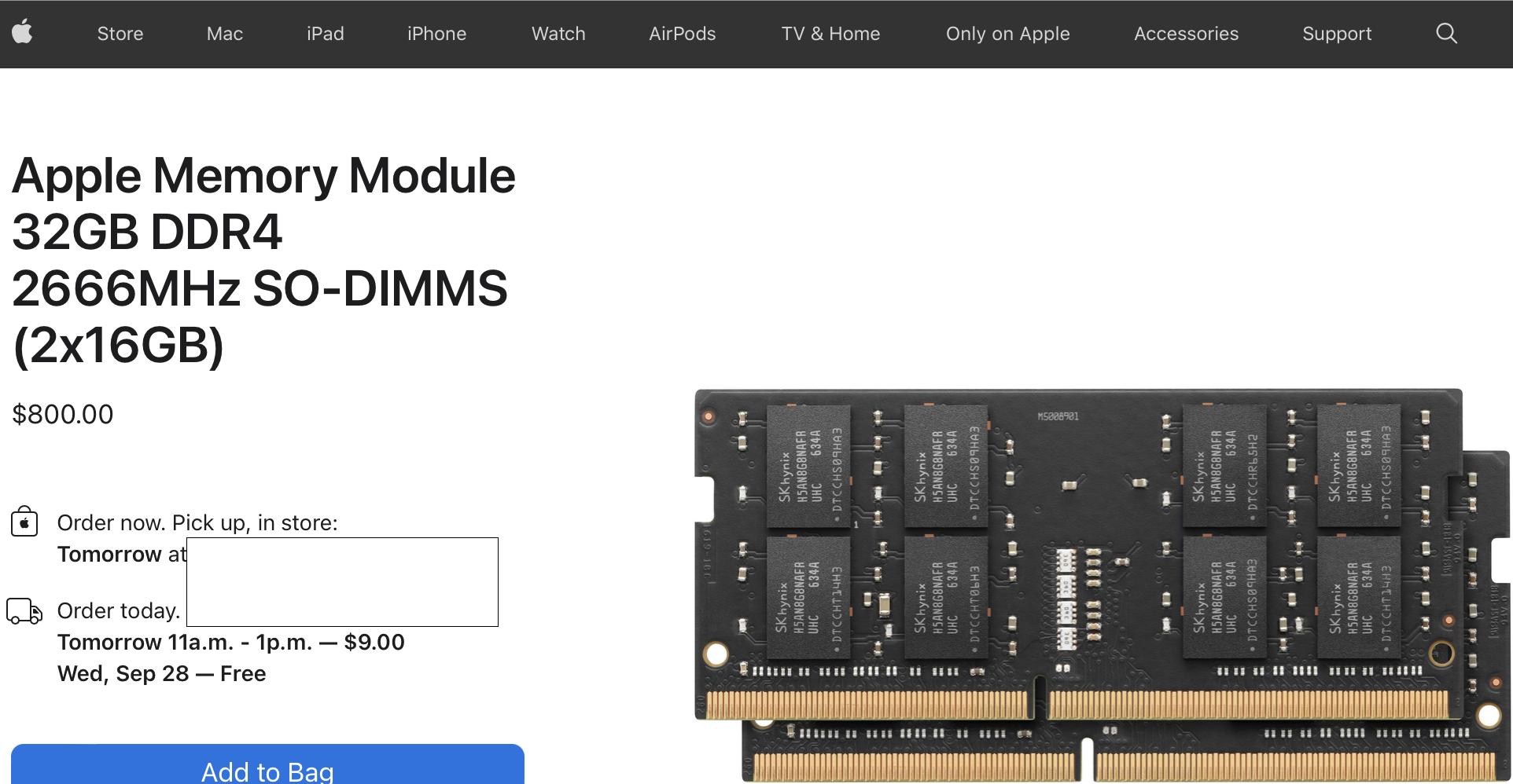

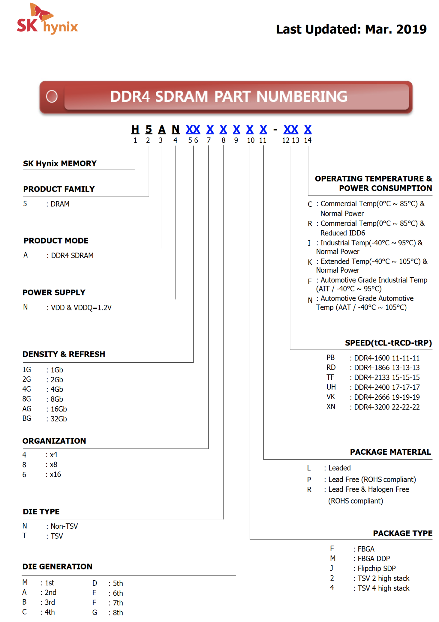

Thanks! So you just have to find the company's part decoder. Given this, it appears Apple is showing the wrong picture for this 2666 MHz RAM on its website, since it says "UHC", which (according to Hynix's part decoder) indicates it's 2400 MHz:
Not to be cynical, but maybe just because it sells better, because it sounds more premium?
Except that info. is buried fairly deeply in their specs, so I wouldn't expect it's part of their marketing.

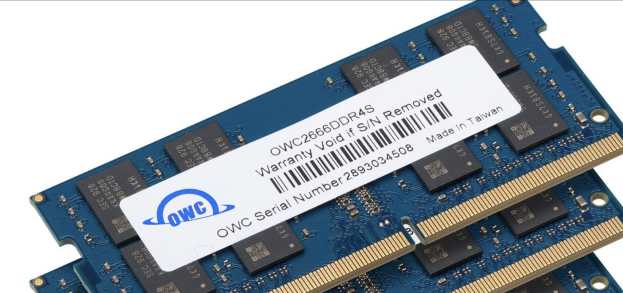

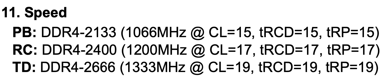

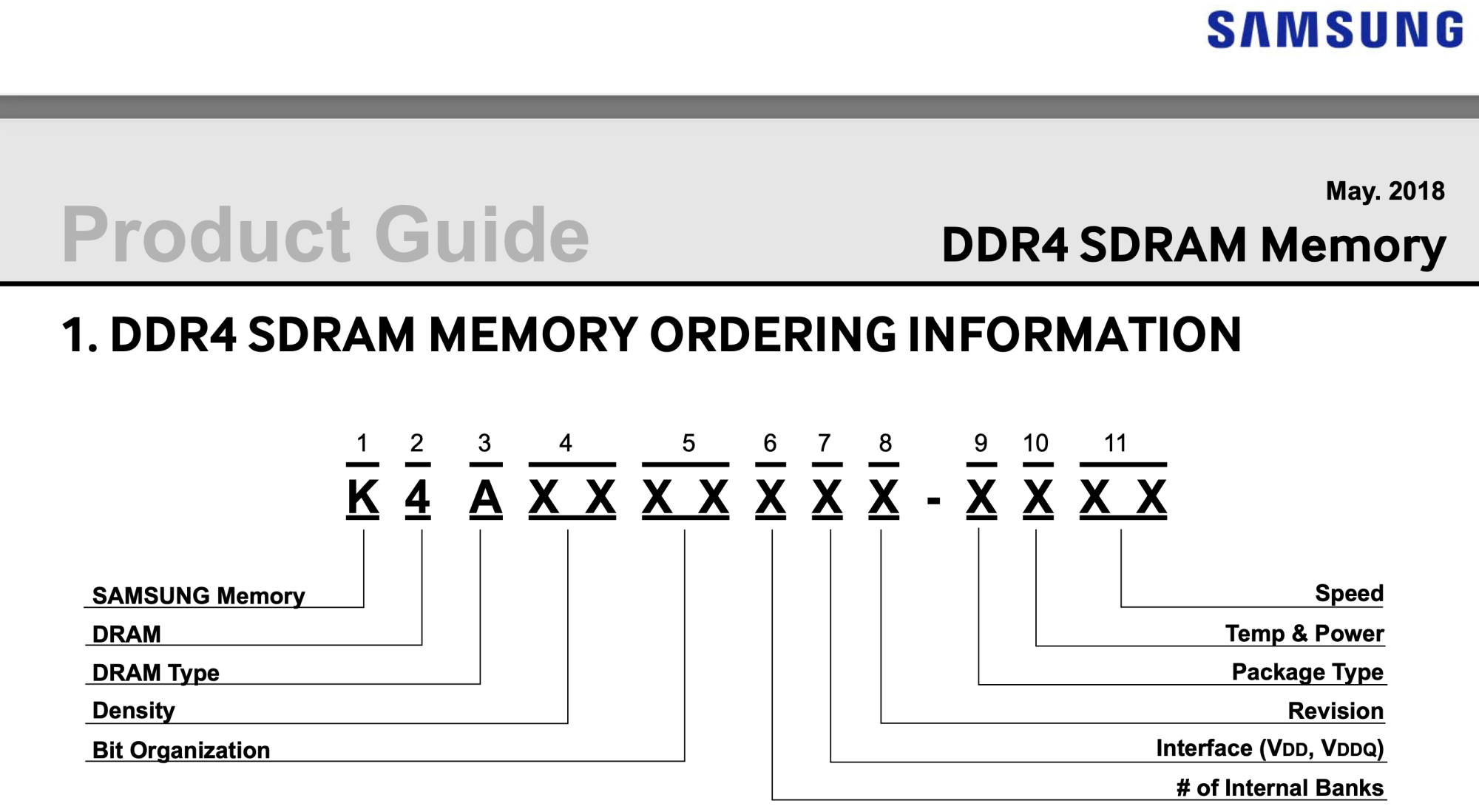

If you look at the pic OWC displays, you can read off the part no. (K4A4G085WB-BCTD), and an intenet search indicates it's made by Samsung. According to Samsung's part decoder (available as a download here: https://semiconductor.samsung.com/dram/ddr/ddr4/k4a8g085wb-bctd/), the "TD" at the end indicates it is indeed CL19. So I may drop OWC an email about this. I suspect it's just human error.

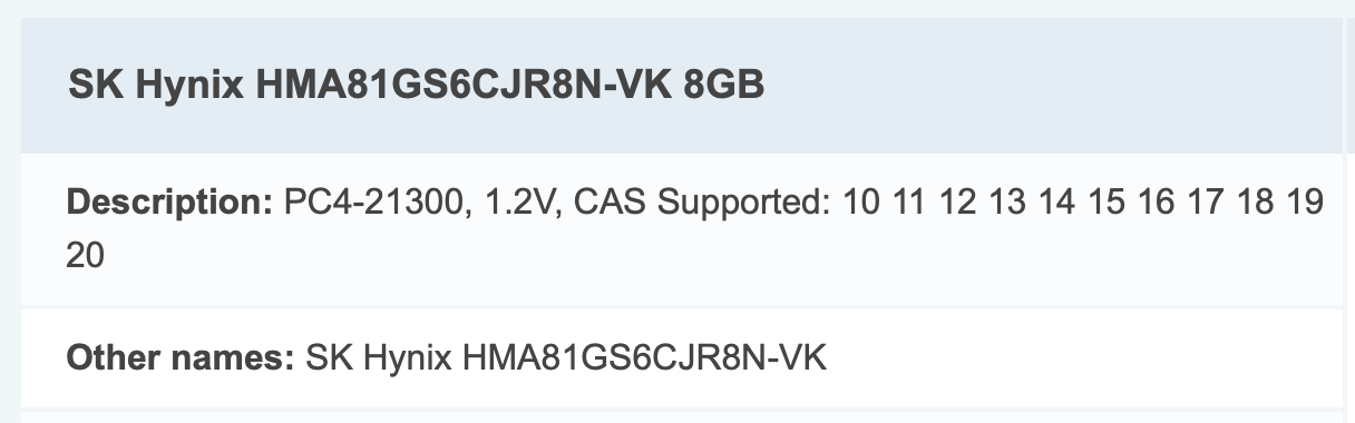

E.g., this screenshot, from the PassMark site (https://www.memorybenchmark.net/ram.php?ram=SK+Hynix+HMA81GS6CJR8N-VK+8GB&id=11662 ), which is specifically for the "VK" CL19 RAM shows that, in spite of that, multiple CAS timings are allowed:
So could it be the case that the CL value we infer from the label is merely the nominal timing for that module, such that we can't tell the actual CL value from the label code? If so, might it be possible that OWC's (and Apple's) RAM is actually CL18 (due to custom programming), the label code notwithstanding?
