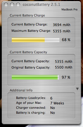

I just got my mac Saturday. So far I have done 6 loadcycles and the stats stay as the attachment.
Is this ok? Any way to improve this?
Try calibrating the battery a few times. Run battery down till screen shuts down then leave in stanby mode for about 4 hours. Then attach adaptor and recharge fully. Should improve those stats.
