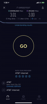

I’m in NYC with a XS Max on AT&T. 12.1 comes with updates to modem firmware and a carrier update, but I see no changes in LTE performance. I had upgraded from a 7+ and historically have seen LTE speeds around ~30-40mbps. This is my second XS Max after receiving a replacement. Been in touch with 2 different senior advisers, and have provided multiple screenshots/sysdiagnose files to Apple engineering. Last heard from the adviser Tuesday 10/23, who told me engineering is aware of the issue and are working on a fix. Take that with a HUGE grain of salt...

I just updated to 12.1. I am seeing no improvement just based on some early speed tests at work. Again, I know speed tests aren’t the most definitive test, but I see no improvement. I’ll test it more over the day and while I’m out and about, but this is very disappointing. I can’t say I’m surprised given others posted that the beta offered no improvements.
I was hoping for good news
It's not about speeds. Drive around and stream music & video and see how many times you lose signal. It's about fake bars and no data flowing .
I know it's not all about speeds, but I'm at work and naturally my first test was to see if LTE speeds were back to what I had on my previous 7+. I won't know until later when I am out and using my phone to determine if it's any better with reacquiring signal and data use. However given I see no change in just a plain speed test, it doesn't make me hopeful that anything else will have improved.
