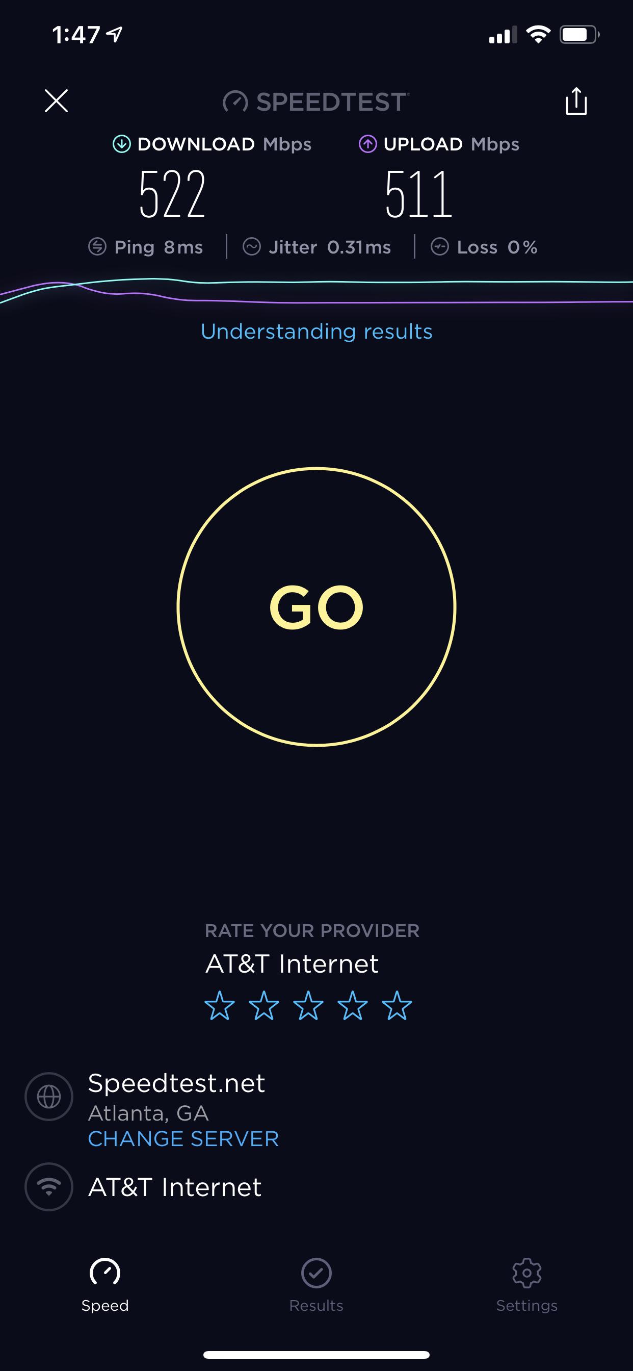

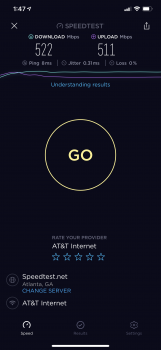

Just did another Wifi test. Not seeing any weak or dropped signal, or reversion back to 2.4 GHz.
