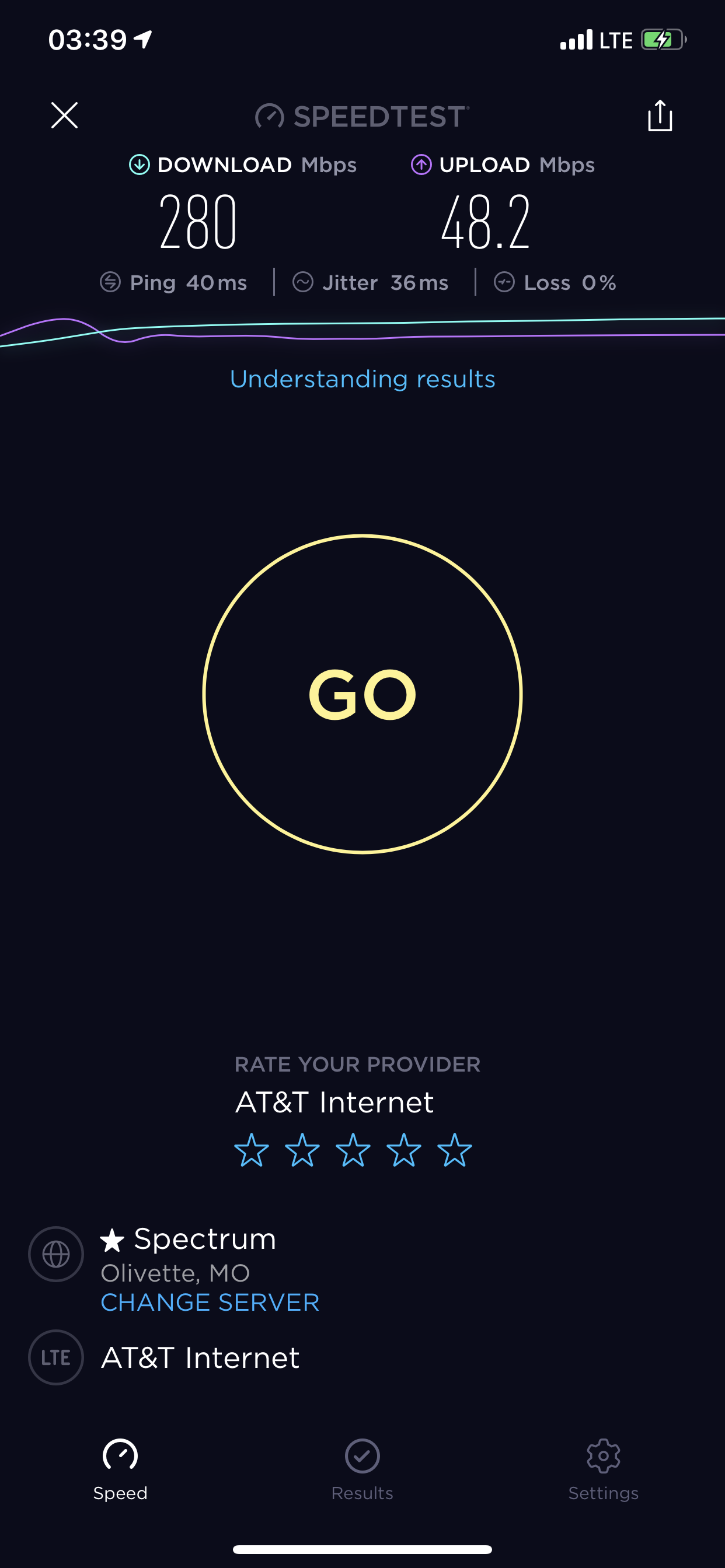

I’ve been lucky enough to not have any WiFi or LTE issues. I actually get better service in poor service areas and buildings compared to my X.
