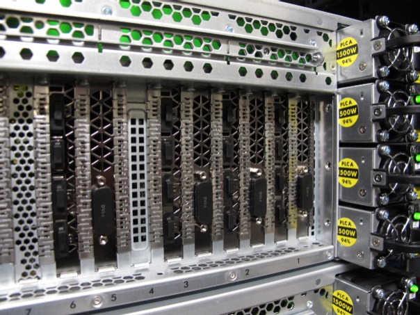

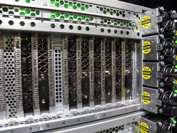

Here's one of the many systems from the back:
Yes it has 6000 watts of power supplies - four 1500 watt supplies on 208 volts (will not run on less than 200 volts). And, you can see the four double-side Nvidia GPUs.
