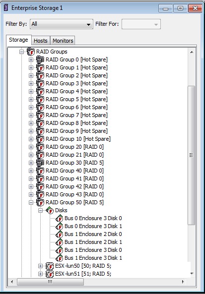

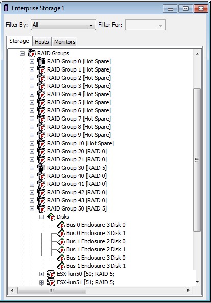

As a real experiment, I powered down an unused EMC array, disconnected all the storage shelves, and powered it back up. When I looked at the array, I saw the attached image.
Clearly, there must be some non-volatile meta-data stored in the controller for it to be able to tell me which arrays and disks were missing!

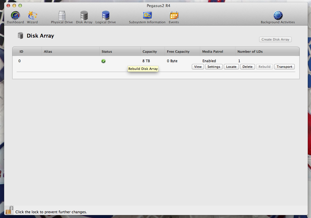

This is what is in the disk array. What is odd is that I have 0 bytes free 😕
Nothing is on the drive.
And under Logical Drive you have...? That screen tells me there is 1 logical drive created, that is where you need to go next. I don't know what the R4 comes configured as by default (RAID5? RAID0?) but the Logical Drive section of the utility should tell you that. If it's RAID5 and you want RAID0 then you should be able to delete the existing logical drive and create a new RAID0 logical drive.
Flying by the seat of my pants here since I haven't actually used the Pegasus stuff before. 🙂

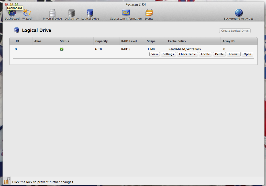

Here's a screenshot of the logical drive tab. I'm scared to change any thing. Most of the time I have someone at work do it 😛
Appreciate your help!
Well, since you have no data on there yet there's nothing to be afraid of. 😀
So you have a RAID5 logical drive using the entire disk array (That is why the disk array screen says 0 free). In the Logical Drive screen you would click "Delete" to remove the RAID5 logical drive, then the button below "Background Activities" should be available. Click that and you should be able to go through the setup process to create a RAID0 drive. Once created, your Mac should pop up a window telling you that it has detected an uninitialized disk and ask what you want to do. You can go into Disk Utility to partition/format the new RAID0 logical drive and once that completes it will mount the drive, making it ready to use.
