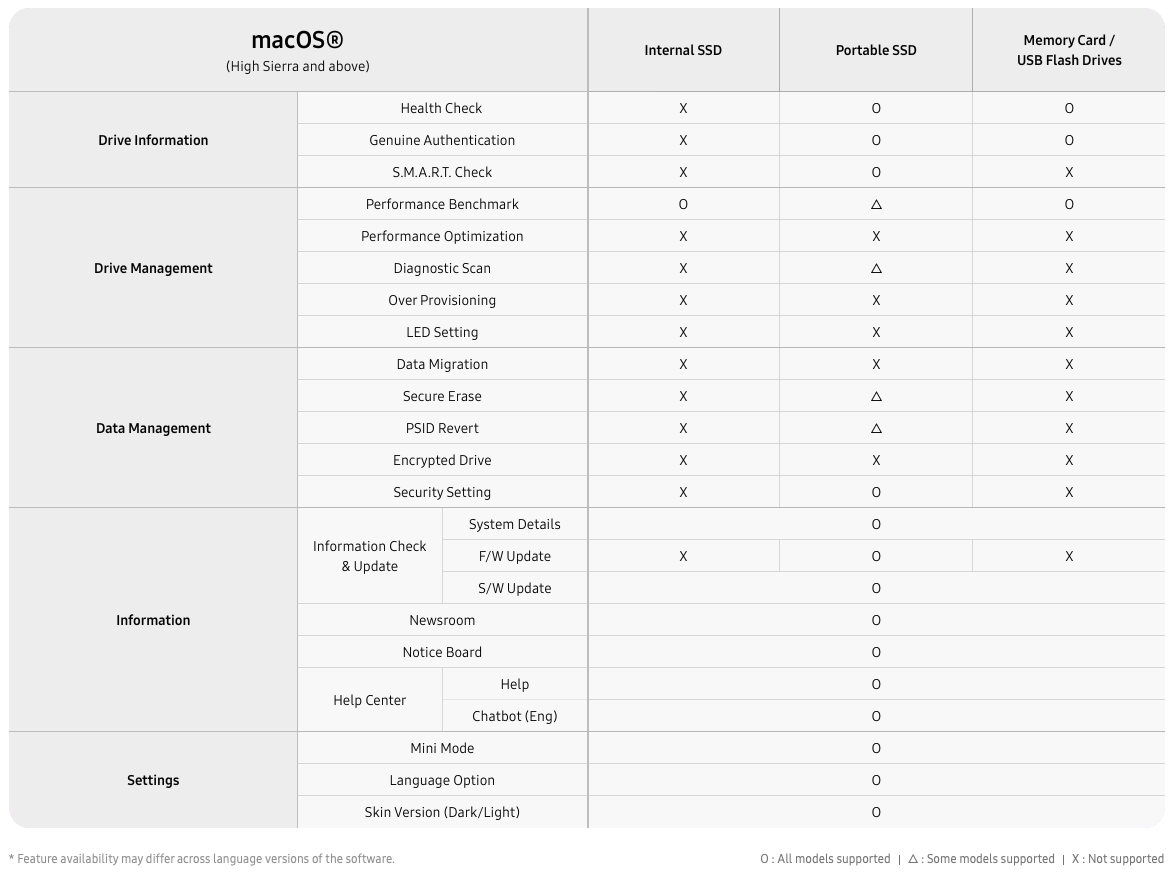

Do any of you using Samsung 990 Pro m.2 drives in external cases happen to know if Samsung Magician can do firmware updates on them from macOS? The support page says "internal" drives aren't supported, but "external" are. I was wondering if putting the m.2 in a case makes it qualiy as an "external" for Magician.
Samsung uses the term "portable SSD" for its specific products like the T5/T7/T9. Samsung would always consider the 990 an internal SSD regardless of how it's connected to the computer.
You can update the firmware of an NVMe Samsung drive in a Thunderbolt enclosure using the Windows version of Magician, if you have a PC that has Thunderbolt.
Reactions: mattspace
so it has to be specifically a TB external enclosure to do the firmware update, not usb?
Correct. The computer/Samsung software needs to see it as a native NVMe disk, and USB doesn't provide that.
ergh, so really there's no good solution if you don't have a windows box with a PCI slot & nvme adapter. I would imagine it's not particularly healthy to be plugging your mac's boot disk (if using this blade for that) into a windows machine... or does the firmware updated leave the disk contents alone?
Normally, disk firmware updates don't touch the data on the disk, but things can always go wrong when doing any firmware update on any device.
