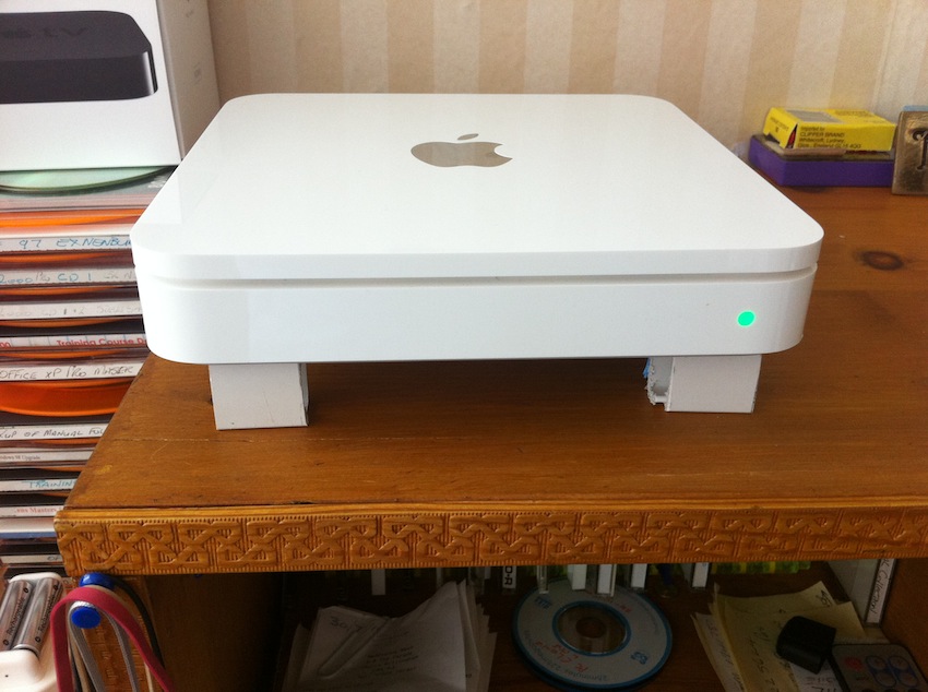

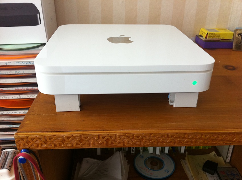

    I have a generation 3 running 24/7 since March 2011, during the spring months it ran warm
    Now in the Summer months with out side temps at 80+ it is running a lot warmer to the touch :eek:
    The attached thumbnail is my answer to the extra heat generated, its not elegant but cutting up 4 pieces of electrical conduit into 1" blocks just raises it up enough to make a difference not original but seems to work
    I also dismount the TC overnight and this seems to make a difference as well
